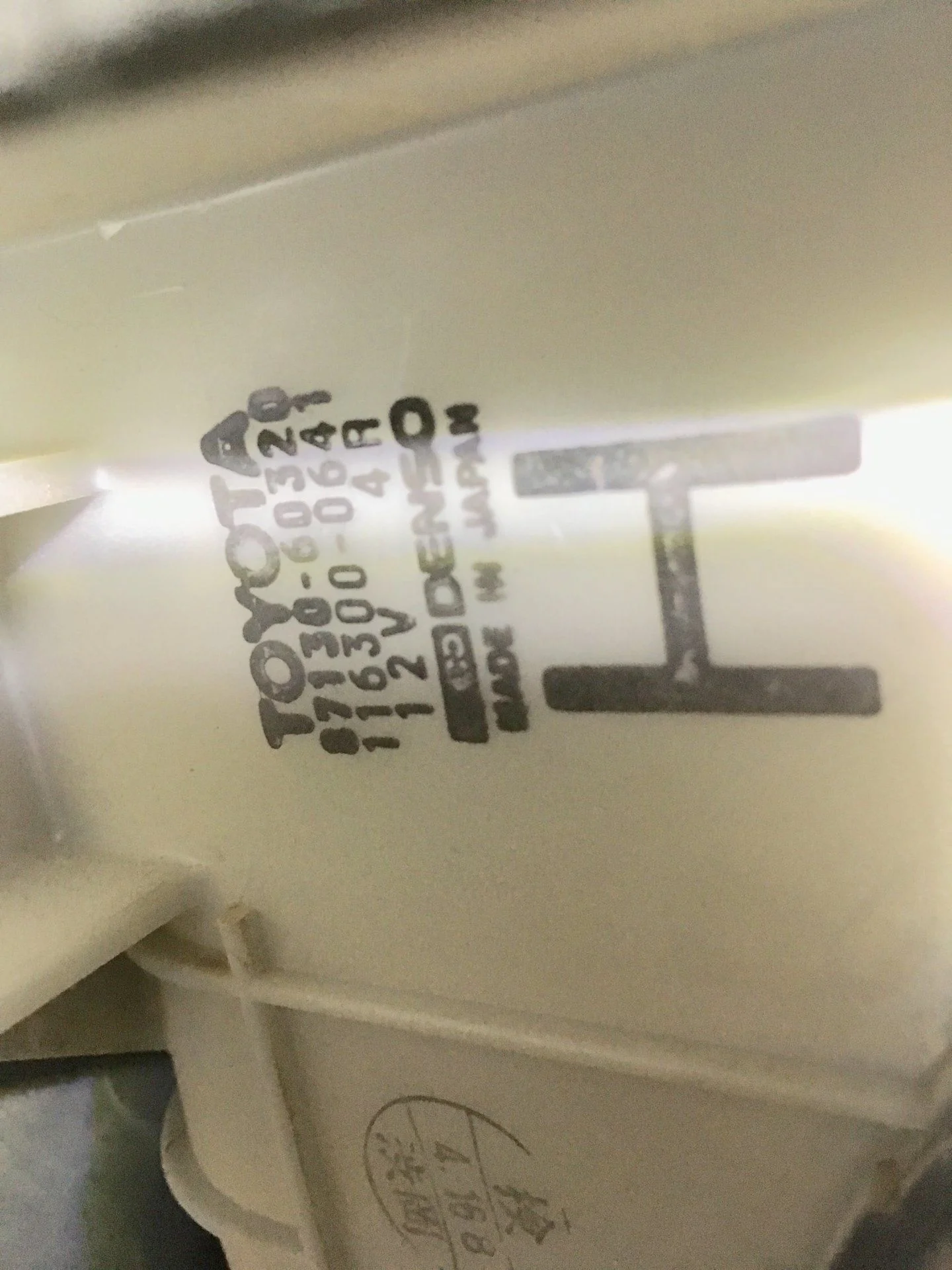

Doing more research. This part attaches to front heater blower assembly, # 87130-60320. Possibly a heater foam filter? I will try to post some pictures soon.

From what I have determined 80 series did not have factory cabin air filter. I have used a shop Vac on this filter and got some of the dirt out of it. I think this is for AC recirculation setting and uses the heater blower assembly. working on posting pics from underneath my glove box, PS area.

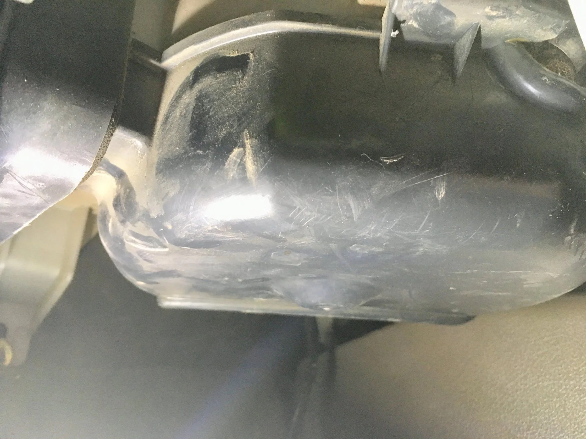

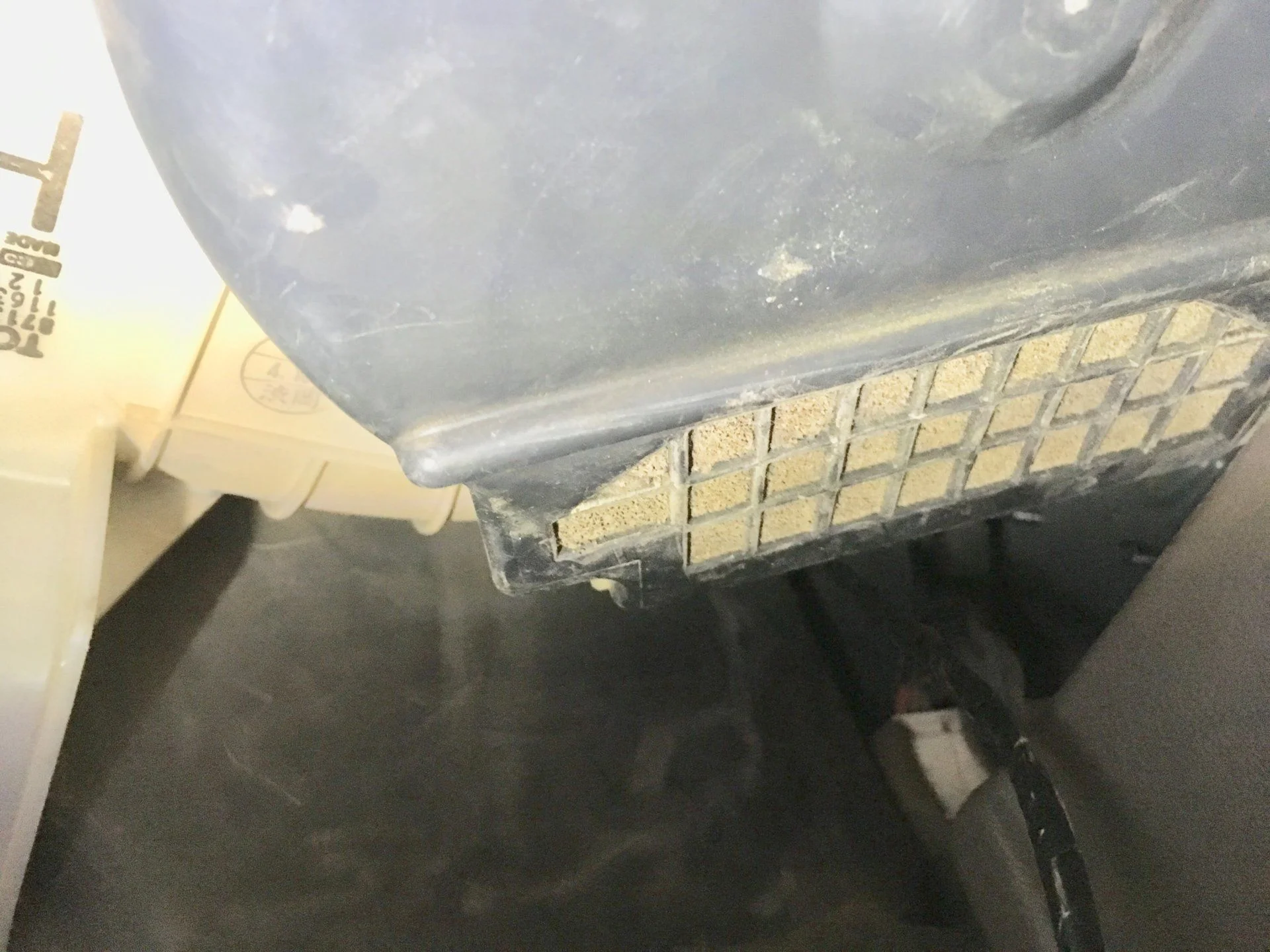

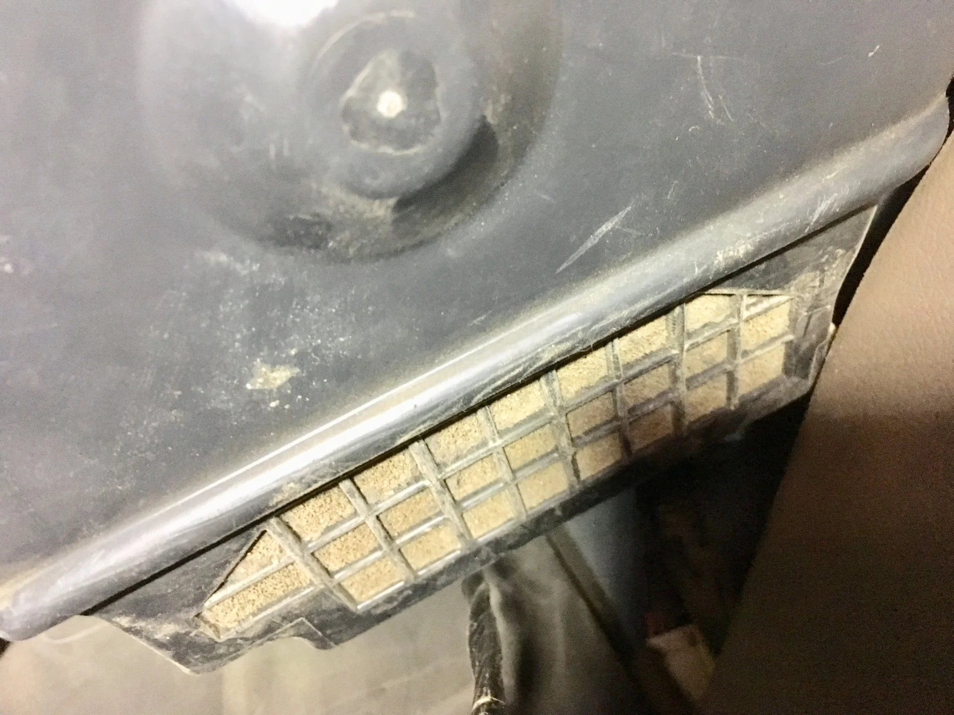

Here's a few pictures of the filter that I'm talking about. Anybody with an 80 series, look and see if you have this filter assembly,
PS, up underneath the glove box.
PS,uunderne
Ahhh, I think that's more of a recirculation intake screen to keep big junk like leaves from entering the fan assembly. I'd guess about all you can do is vacuum it unless you disassemble the housing.
That's what I thought, also. and that's all I did. Until I see some procedure for this, I am calling it good. But I will check with Toyota parts an see if they can isolate it on their parts screen, if this filter is available.

The location of that filter is not filtering air from the outside, only from the inside. Hence my puzzlement as to why does Toyota want to filter the recirc air? The fresh air intake is directly coming from the windshield cowl area, which is directly on top of this area and NO filter is located there. Which is why we get so much dirt and crap through the fresh air intake and is quite annoying.
