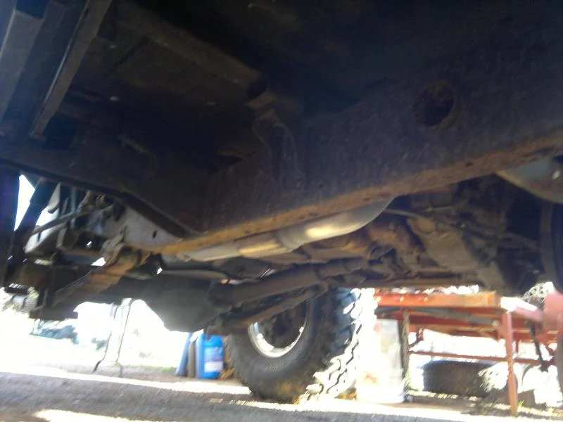

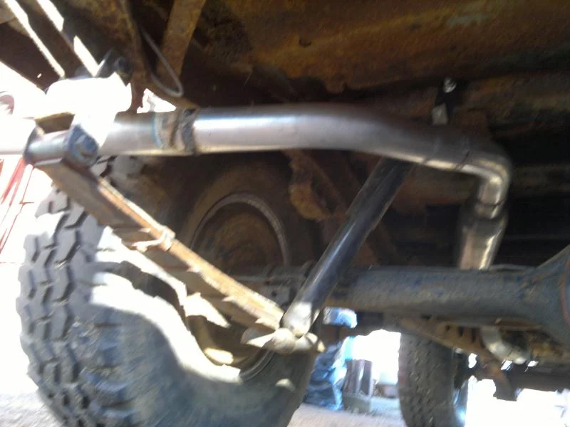

I just went the simple route with Mark's tri-y header and 2.5" pipe . Just used a simple DynoMax 2.5"x10" shortie glass pack that's just hollow - not really loud as expected , just a nice growl when it gets on the torque band .
In the pics you can see the "muffler" , v-band joint and stainless flex connector about a foot behind the header flange joint . Works pretty well allowing the system to move without hurting the joint seal . As stated - the sound is pretty unique for a straight six - no drone at highway cruise speed but a definite growl if you step into the throttle in 3rd and 4th torque loading the engine .

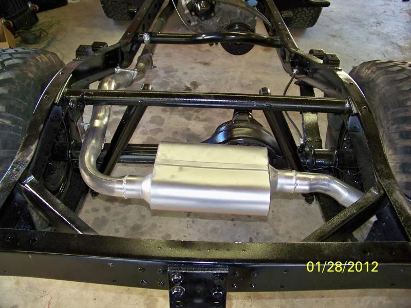

I'm running a Man-A-Fre cheapie header with a magna flow muffler.
I might have to redo the exhaust when I do the spring over because of the tail pipe exit, but I am not sure.
Initially it was pretty quiet -too quiet, IMHO, but after a while it got louder and I think it sounds very nice.

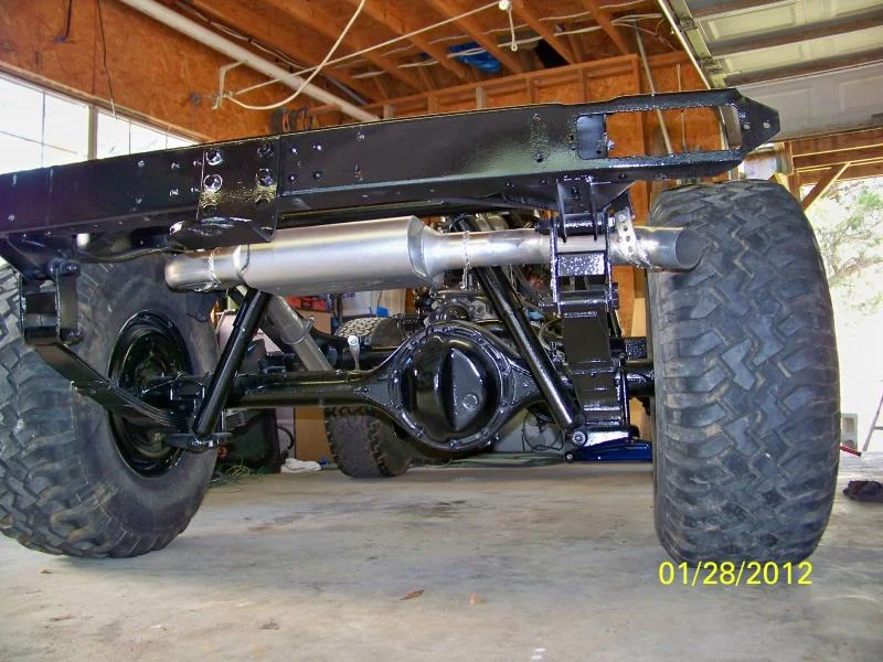

I went with Thrush as well. Stock manifold w/ 2 1/2" front to rear. Not loud, but has a nice low sound.
