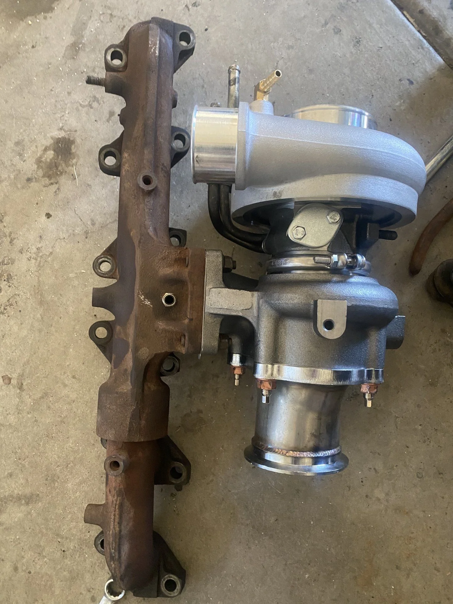

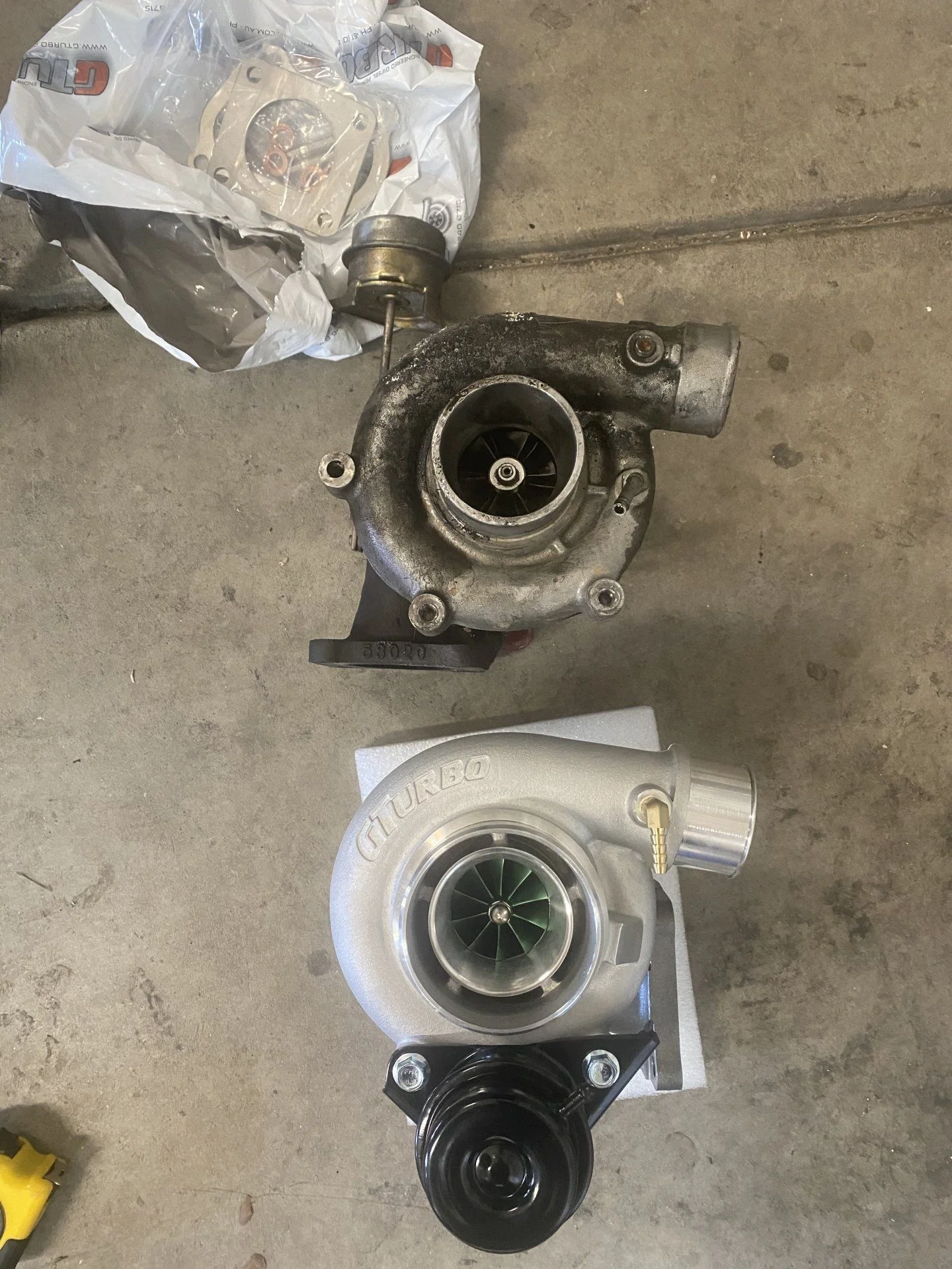

Installing the new turbo. Also, moved the EGT probe to before the turbo instead of the downpipe.

Pre-turbo is always best. Low comp on both rear holes would concern me that you've got a head gasket issue. Might go along with a heat management problem.
The old aftermarket exhaust just had a bung welded in for the probe. I never liked it post turbo. The head was fully rebuilt, have paperwork, 30k km ago in Japan, but I had a catch can baffle failure. I’ve learned that these engines will “gunk” up the intake valves (5,6 being the worst) with a stock pcv, or a poor catch can. I’m not to worried about it yet. When we drove it to Oregon in 100+* heat, it never warmed up past 212. I was pushing it pretty hard too.

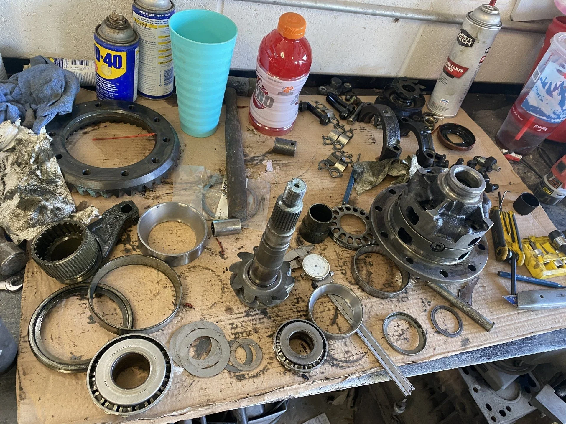

Big shoutout to @RAYJON for helping me with my diffs. There’s been a lot of head scratching on what the history has been on my front diff. Mismatched pinion bearings, deformed crush sleeve, welded pinion spacers, and bearings just falling off when they should be pressed. Now that we have figured out the math on the solid spacer, it should be down hill.
