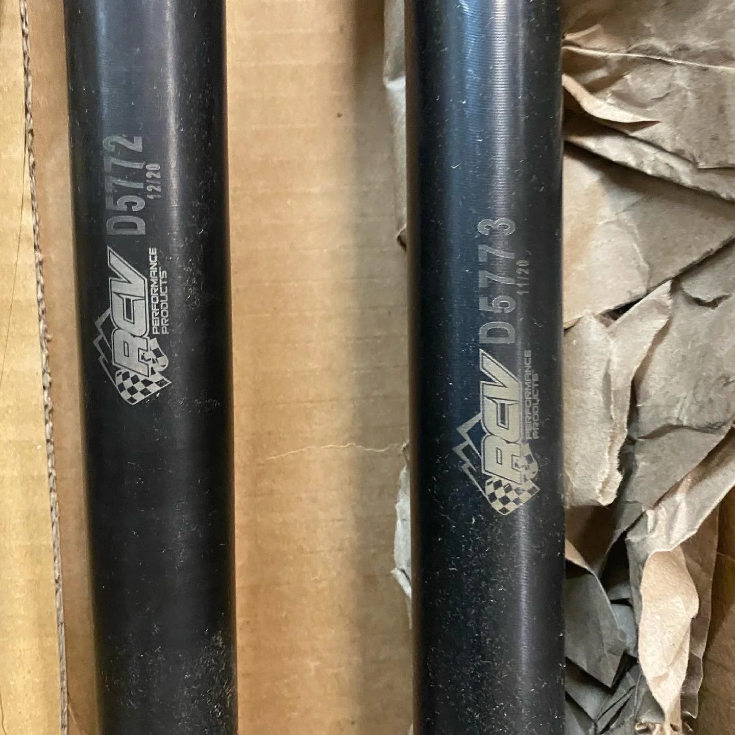

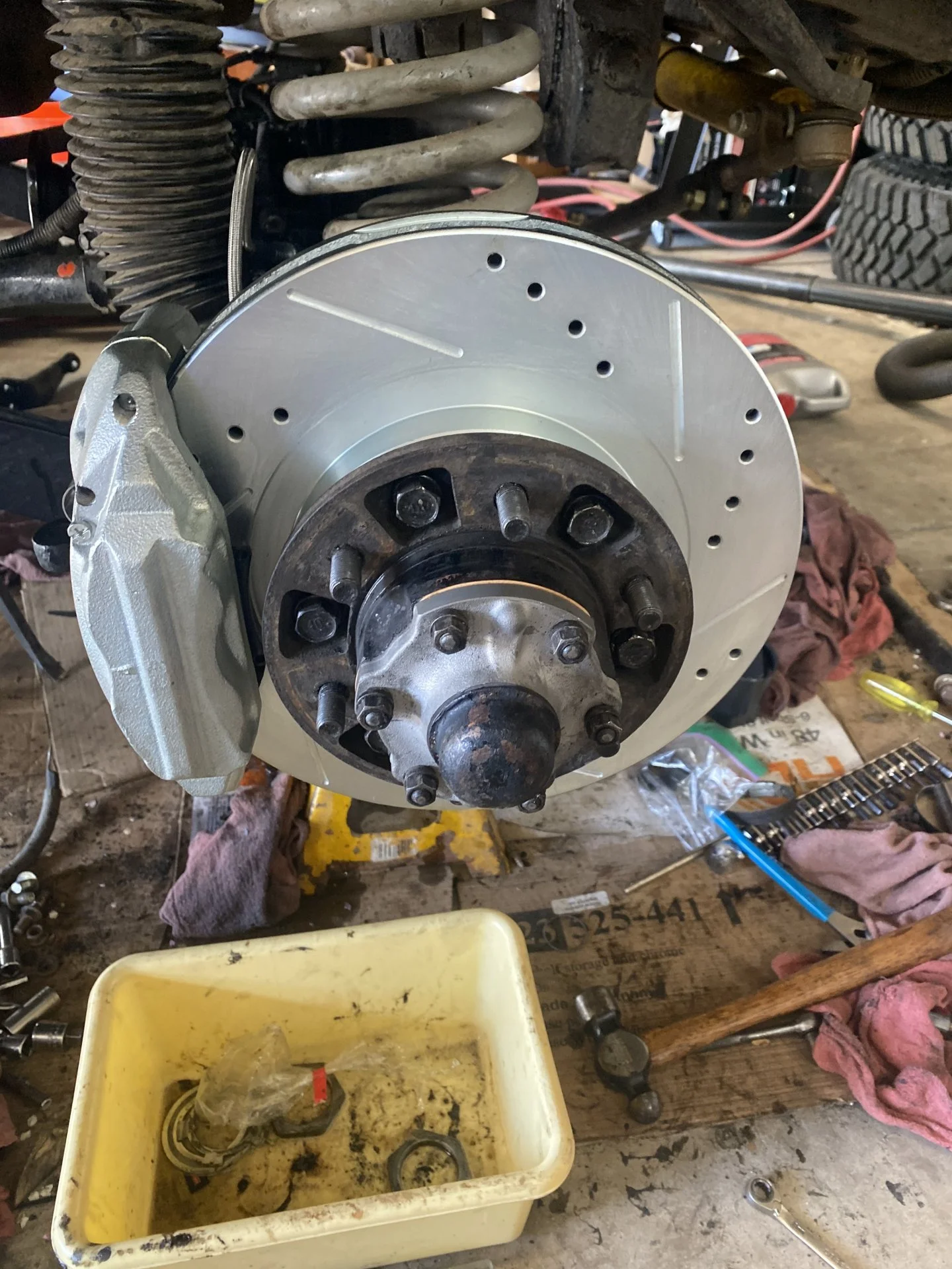

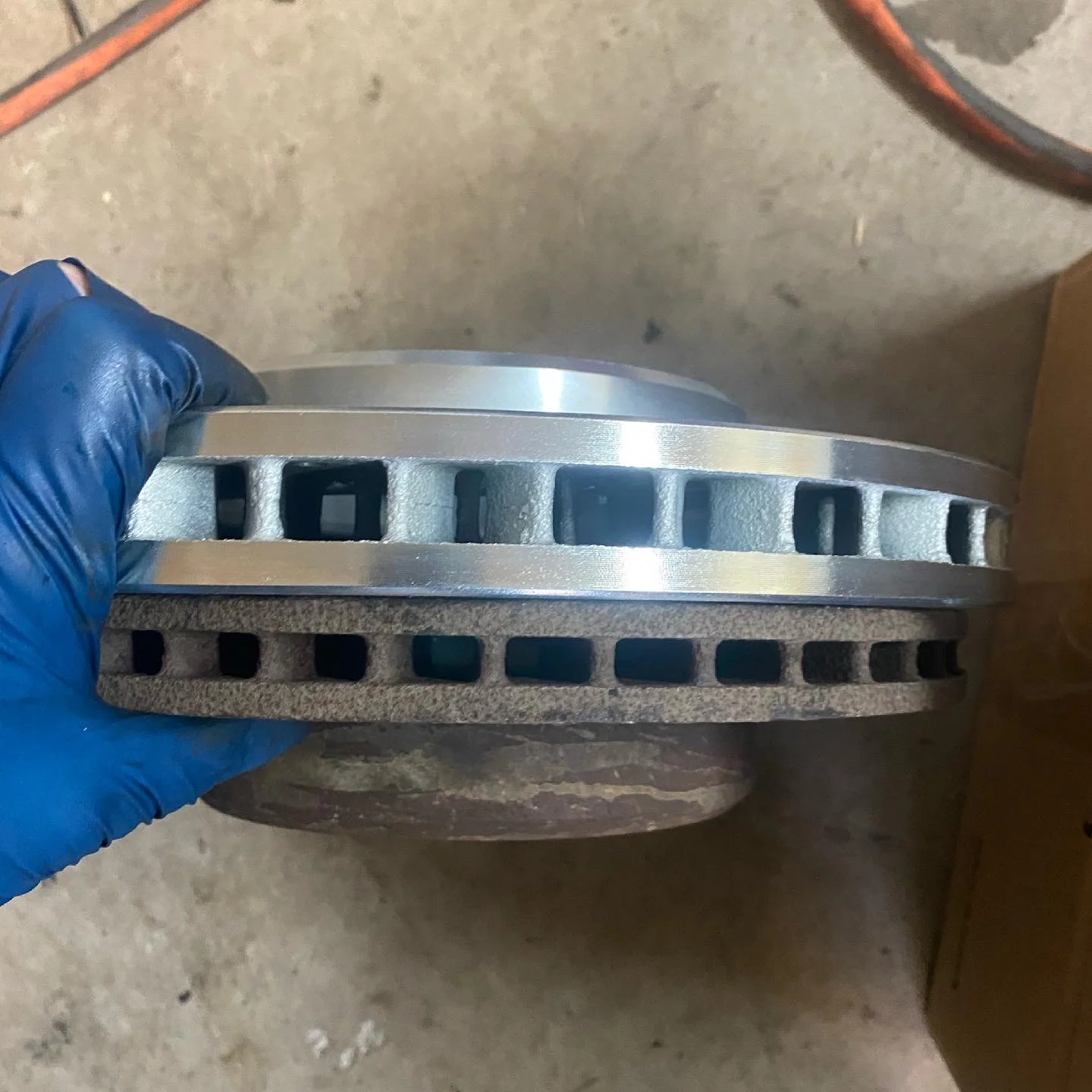

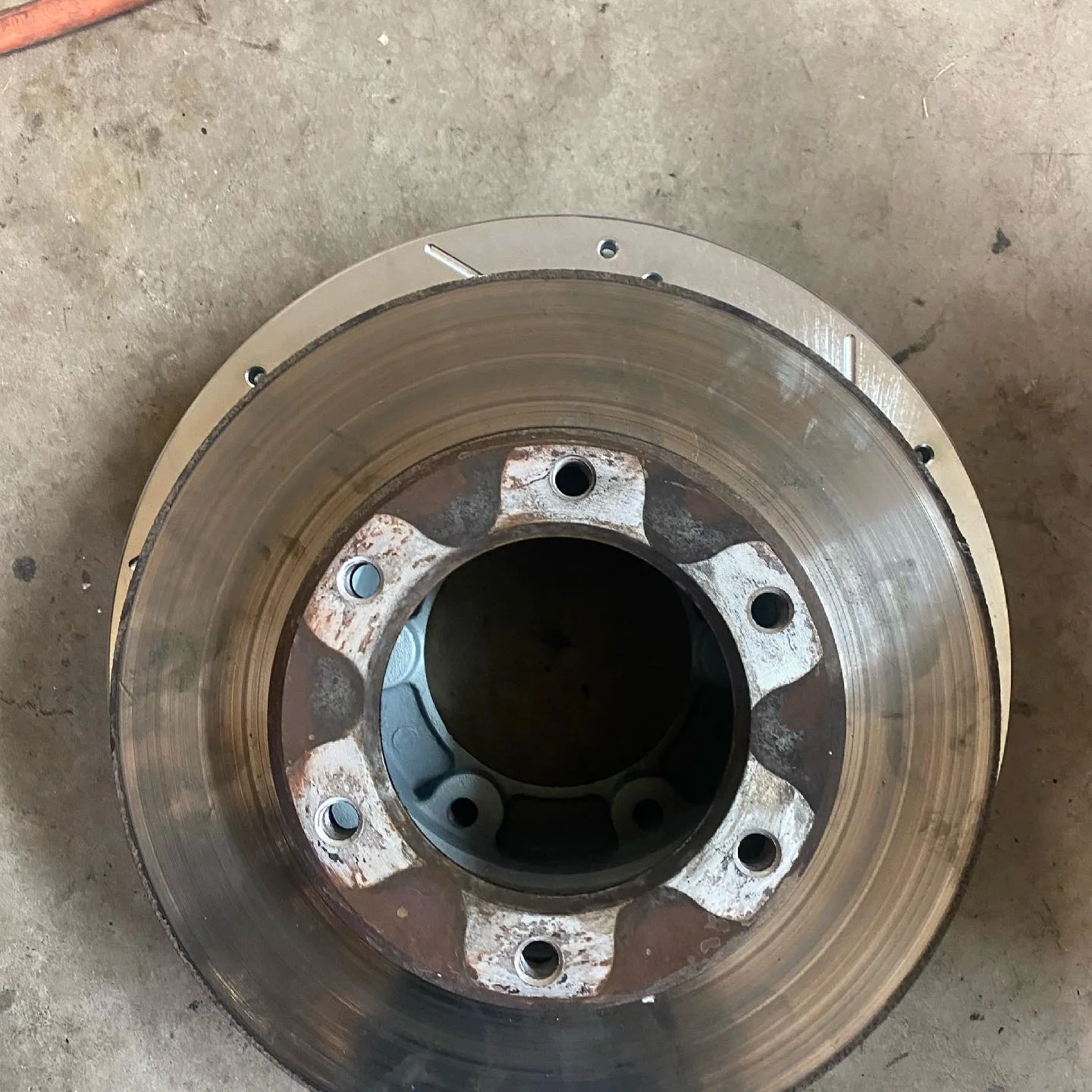

I got a few hours to work on the hot rod today. Started putting together the front axle. Swapped out the front brakes for the 93-97s, drive flanges from the FZJ also, and installed the RCV axle shafts. I had forgot that the shafts were rifle drilled.

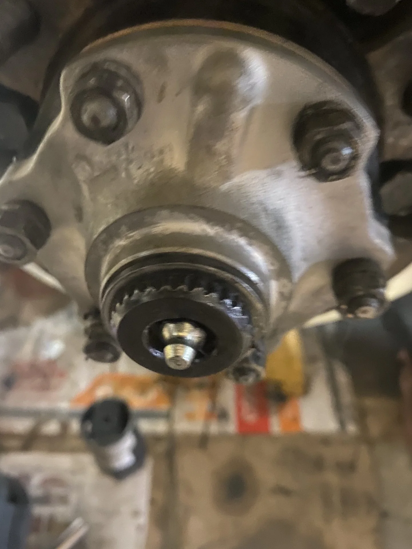

The zirc fitting so you can flush the birfs without taking them apart????
Yep! Pretty cool. I did put a full tube of grease through each one already.
Ok that just makes too much sense. Repack without dissembly .
