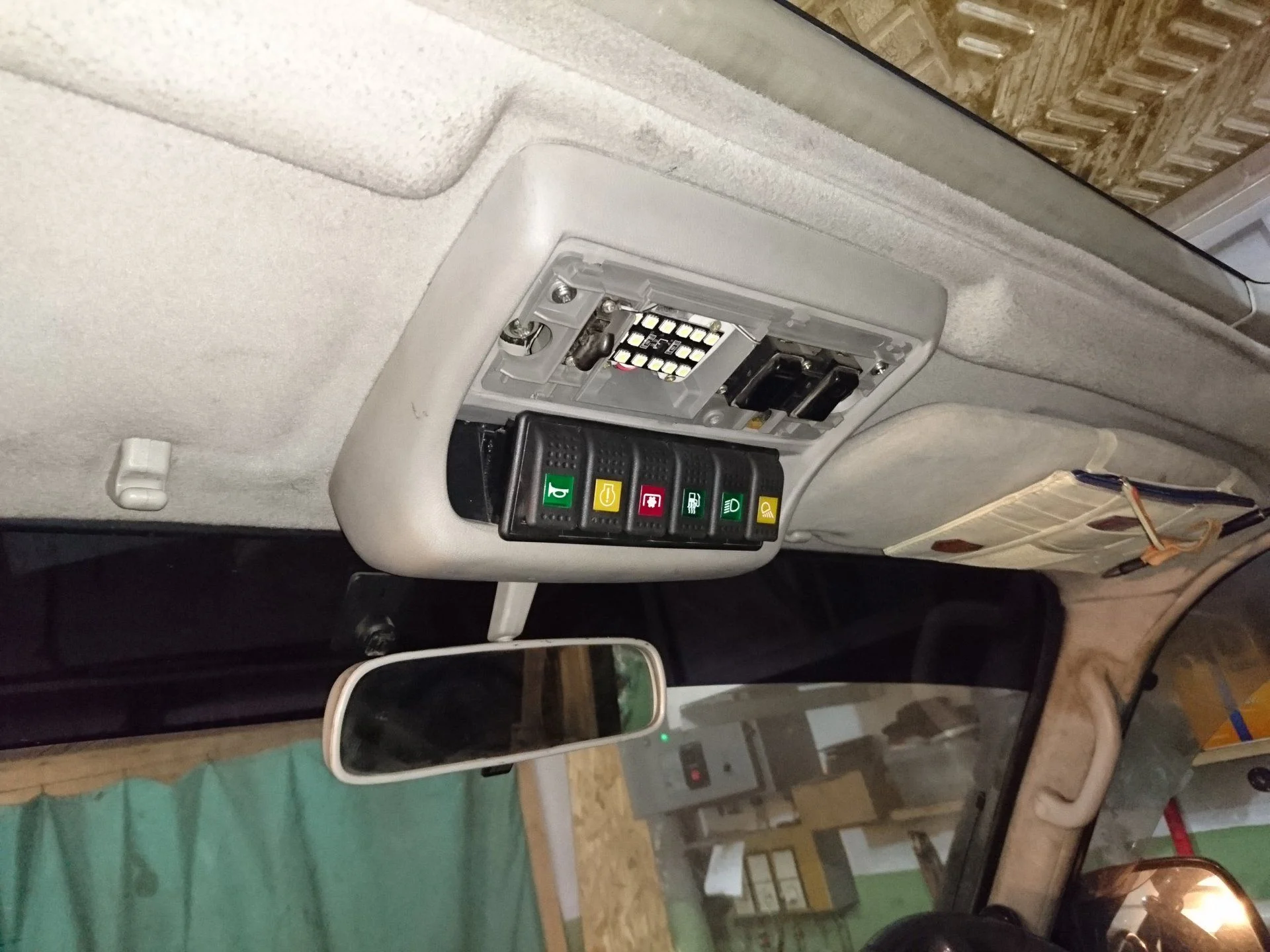

Installed upper block of buttons instead of OEM compas. Why compas now - everybody have GPS.
On the up side I have
1) Air horn. On - air horn will work with OEM, Off - only OEM.
2) Air compressor autmatic on 6 bar - off 8 bar. I use Nardi compressor 215 L\min.
3) On-off AC\DC convertor 220v 350 Watt for charging different stuff and for laptop use.
4) Two way fuel heater( I have diesel and we have some times -50 celcius degree. ). One - only separator heater, second push - separator and intake tube in fuel tank.
5) Front roof rack light
6) Back roof rack light.
7) (hidden) on\off daylight lamps
Center console instead of front heater gril that i never use.

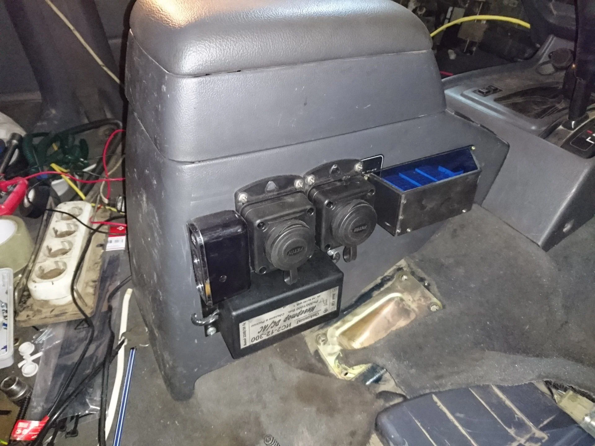

Console with 2 additional lighter sockets and Sub tank meter.
Console on the right side of the armrest contains 2 AC sockets, 2 lighter sockets to rear passangers, 2 USB sockets for rear passangers, 1 USB socket for driver. 4 electromic meters: voltmeter, T-meter for ATF tempereture, T-meter for outside temp, T-meter for fuel temp after last fuel filter.

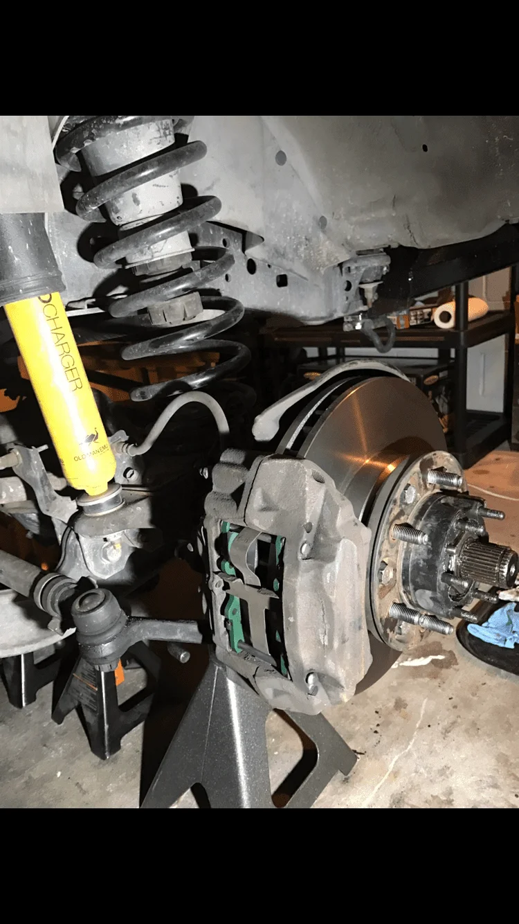

Finally got my front springs installed along with caster correction bushings. Thanks to @RadarFJ40 for all of the help. Turns out I had a bent front lca. Might have something to do with me running into a little tree a couple of months ago...
No more stinkbug. Well maybe just a little bit but after drawers are installed with gear it should be good. Got the alignment done, too. Caster still needs some help, but good enough for now.

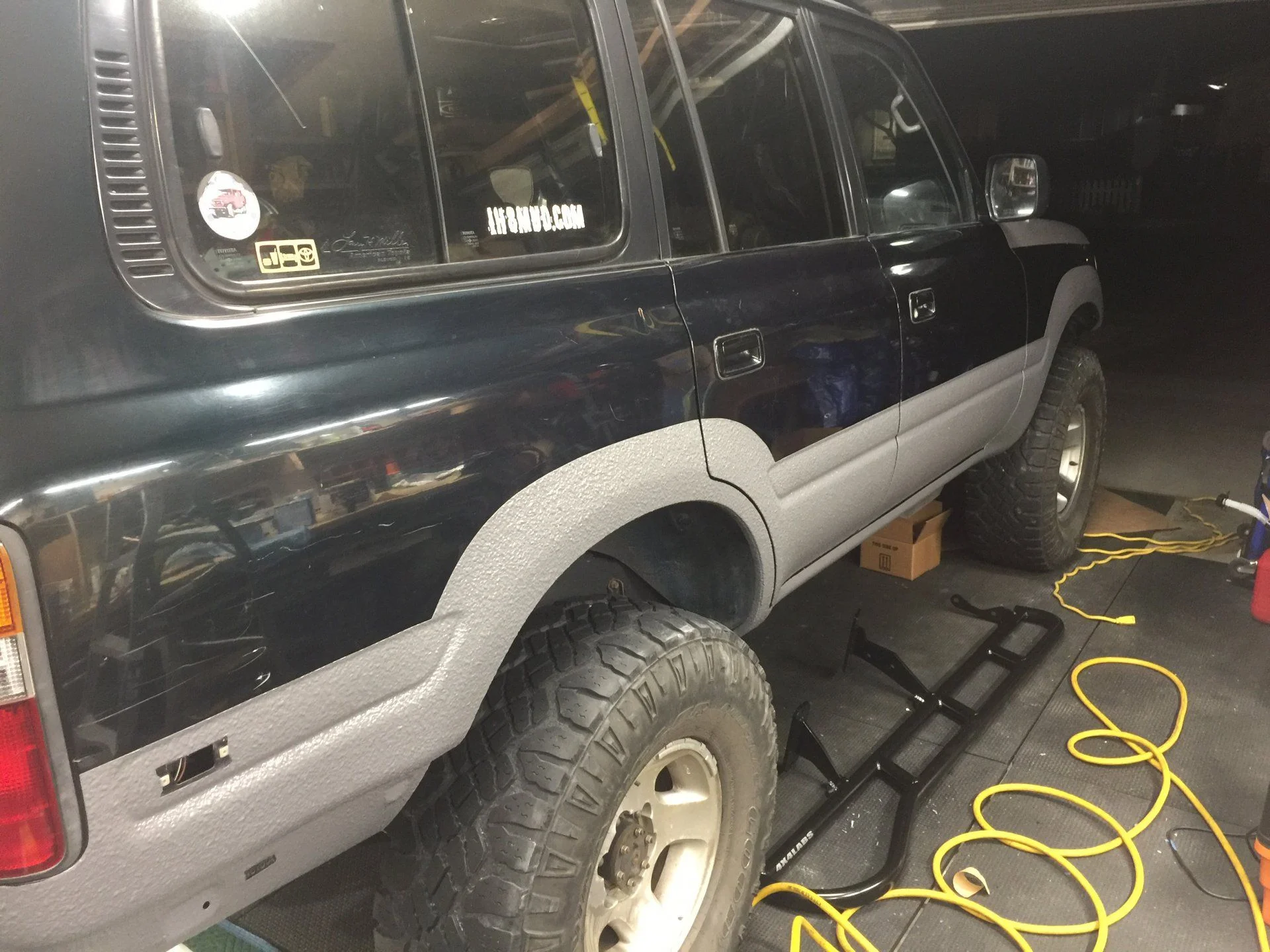

Very busy weekend! New 4x4 Labs bumper and Monstaliner'd the roof and sides!
