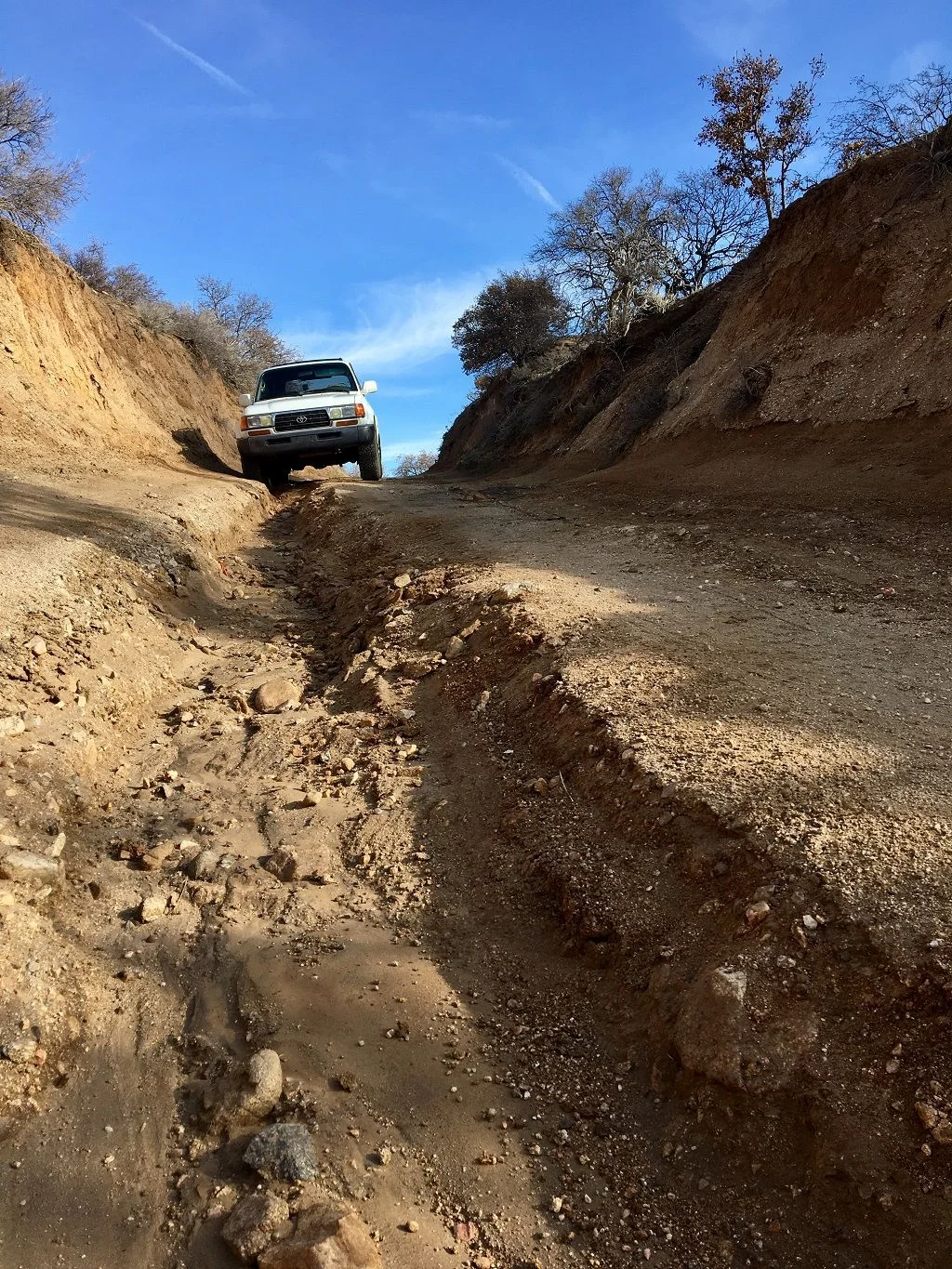

It actually goes back to last weekend. Thursday, a week ago, I loaded up El Guapo with my camping gear, drove about two hours one-way, and then spent 4-days/3-nights camping and off-road riding in the N. Georgia hills. Then I came home, cleaned out all the camping gear, repacked, and left on Monday evening for a seminar at Tybee Island on the Georgia coast. The drive to and from Tybee was 250, mostly highway, miles at 55-70 mph. And I also drove my three colleagues around whenever we'd go eat.
I just love the way my 80 handled those diametrically opposed situations (bouncing around the woods with all my gear; cruising the highway) with such ease.

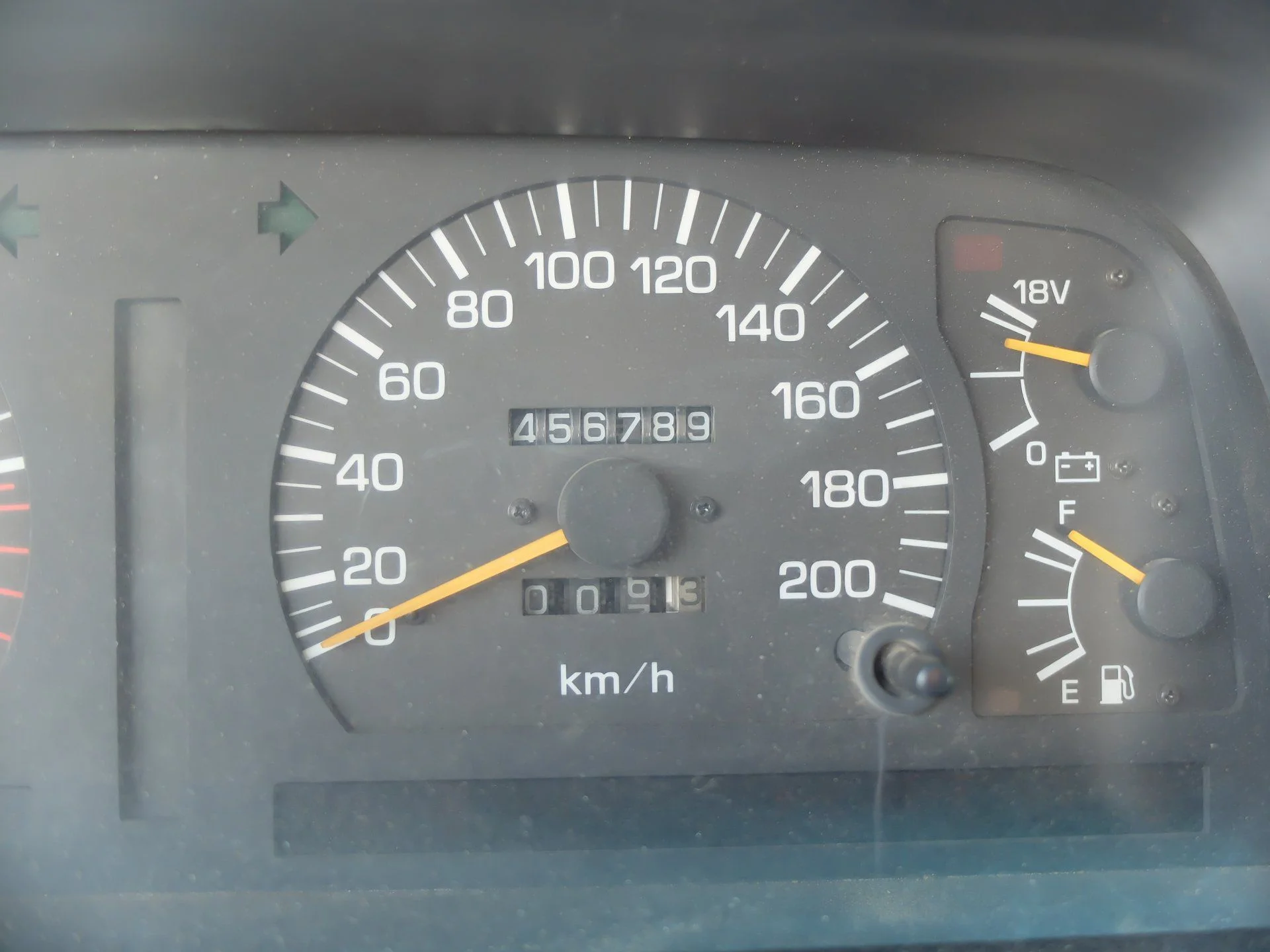

I always have to ask you guys with the highest miles; how much engine and transmission work has been done to your knowledge?
His is kilometers so it's only ~225K miles.

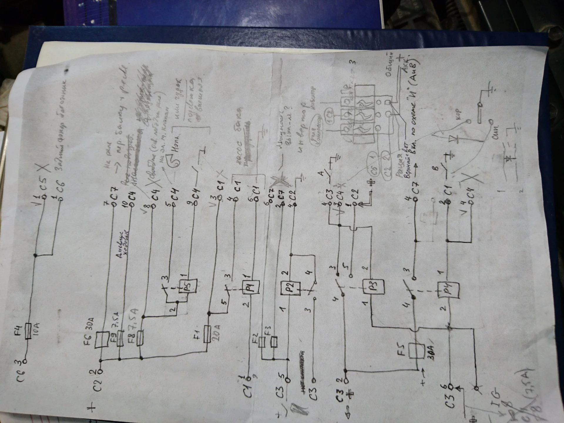

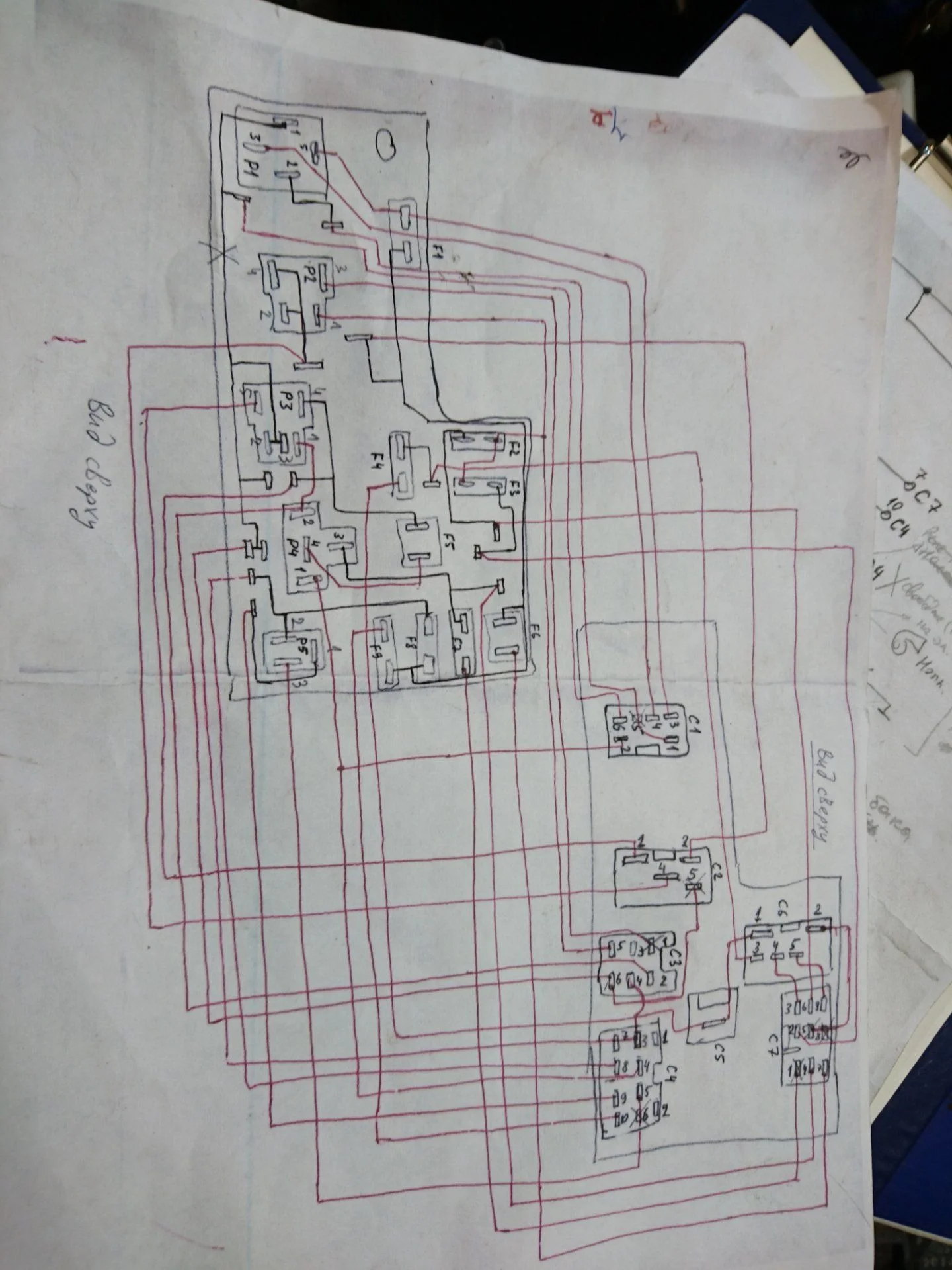

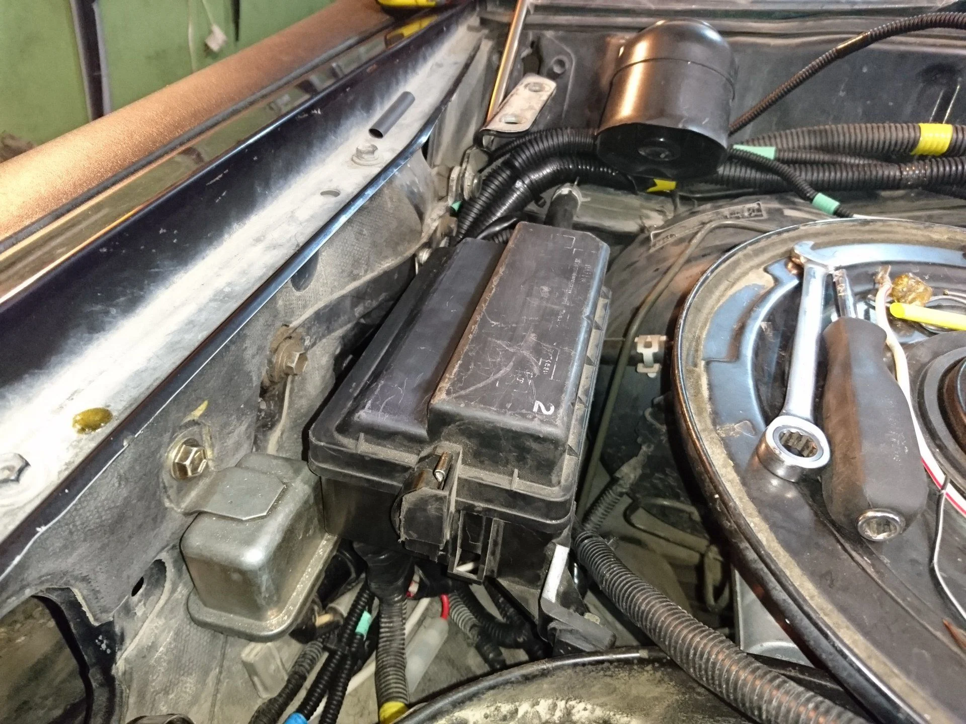

Continue fighting with electric.
Finished the additional OEM fuse box from Toyta Corolla for my planty of electrostuff. Got it for 1$ as a useless thing at junkyard.
It has 5 releys and 7 small fuses and 3 large fuses, the rest is the spare ones.

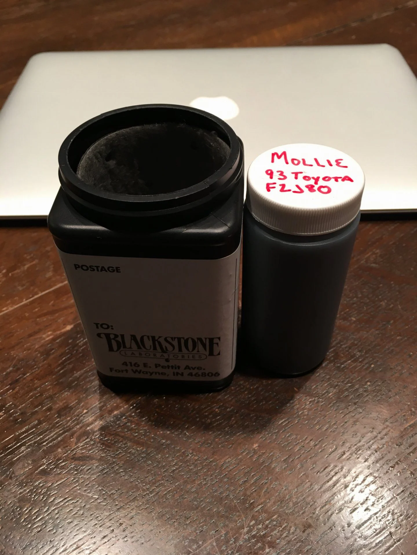

Sample off to Blackstone. Have a feeling the news is not going to be good...
Worse than HG.

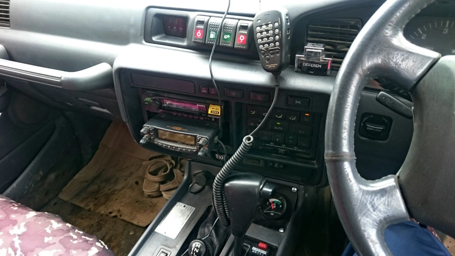

Installed upper block of buttons instead of OEM compas. Why compas now - everybody have GPS.
On the up side I have
1) Air horn. On - air horn will work with OEM, Off - only OEM.
2) Air compressor autmatic on 6 bar - off 8 bar. I use Nardi compressor 215 L\min.
3) On-off AC\DC convertor 220v 350 Watt for charging different stuff and for laptop use.
4) Two way fuel heater( I have diesel and we have some times -50 celcius degree. ). One - only separator heater, second push - separator and intake tube in fuel tank.
5) Front roof rack light
6) Back roof rack light.
7) (hidden) on\off daylight lamps
Center console instead of front heater gril that i never use.
1) Activate wind\unwind button for rear winch. Button with block knob.
2) Pumping from sub fuel tank
3) Activate low preassure from my onboard air to take a preasure into winches, axles, wheel hubs and knuckles to prevent water get into them while crossing the rivers.
4) Activate wind\unwind button for front winch. Button with block knob.
2 buttons to wind\unwind for winches. I use oem buttons from power antenna. From the left and from the right of the rear heater button (not in photo)
Right console where oem Foglight and headlamps washer are. 2 Buttons:
1) Front 240wt bumper ledbar.
2) Surround weak lights made from LED lines( front and rear winches, underhood lights, roofrack lights).
Console with 2 additional lighter sockets and Sub tank meter.

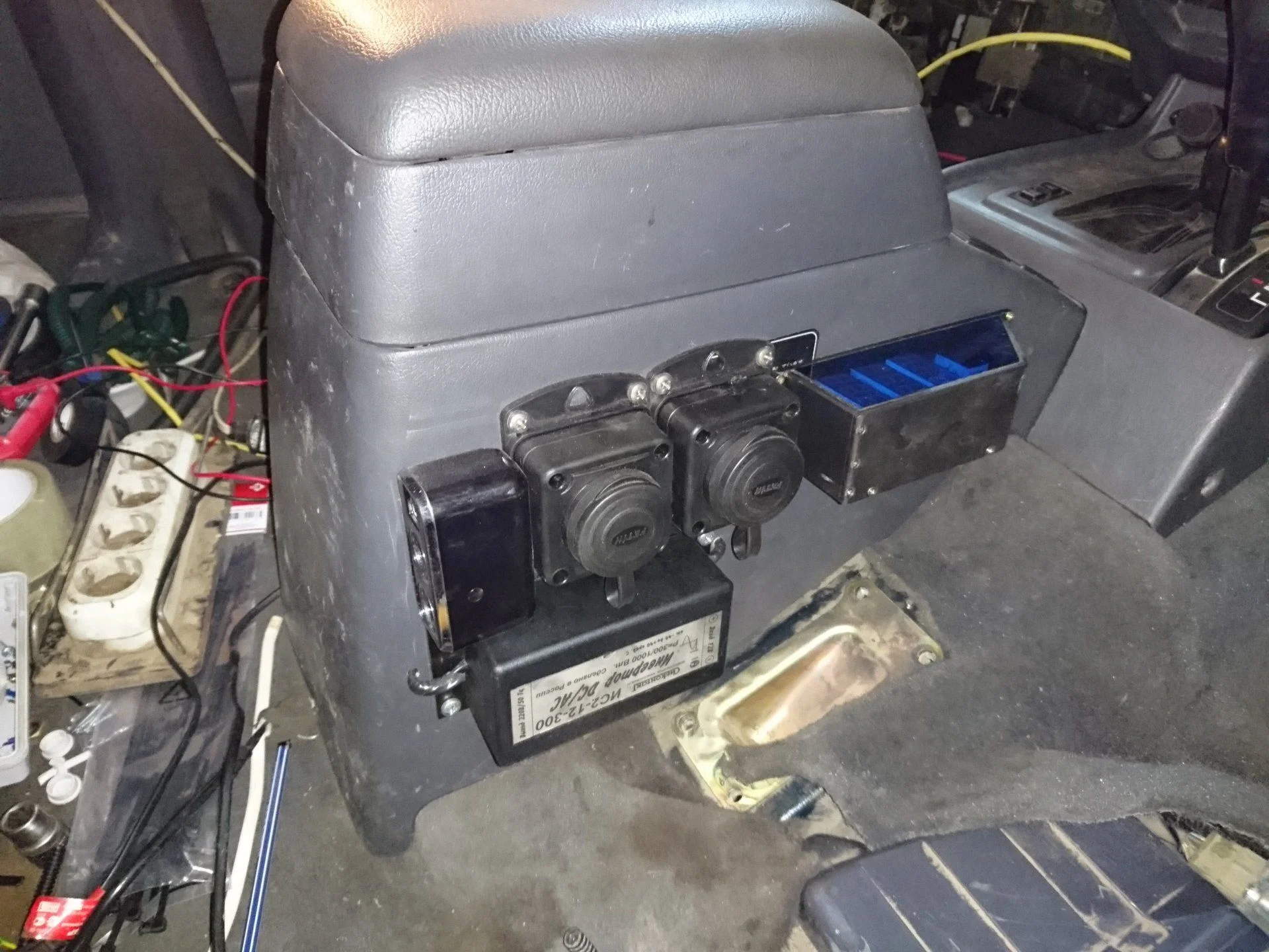

Console on the right side of the armrest contains 2 AC sockets, 2 lighter sockets to rear passangers, 2 USB sockets for rear passangers, 1 USB socket for driver. 4 electromic meters: voltmeter, T-meter for ATF tempereture, T-meter for outside temp, T-meter for fuel temp after last fuel filter.

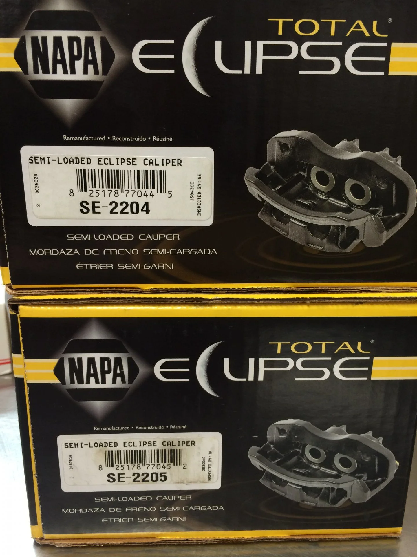

I did Toyota Pads & Rotors and can get you the Caliper Part Numbers in the Morning, from what I have read on here these are Toyota Cores that NAPA remans.
Cool, thanks for the pics. Those appear to be $59.49 each.....
Brake Caliper w/ Hardware - Left Front (Eclipse Semi-Loaded) - Remfd
Brake Caliper w/ Hardware - Right Front (Eclipse Semi-Loaded) - Remfd
I wonder what these are, that are $109.00 each?
Brake Caliper w/ Hardware Only - Left Front - Remfd
Brake Caliper w/ Hardware Only - Right Front - Remfd
