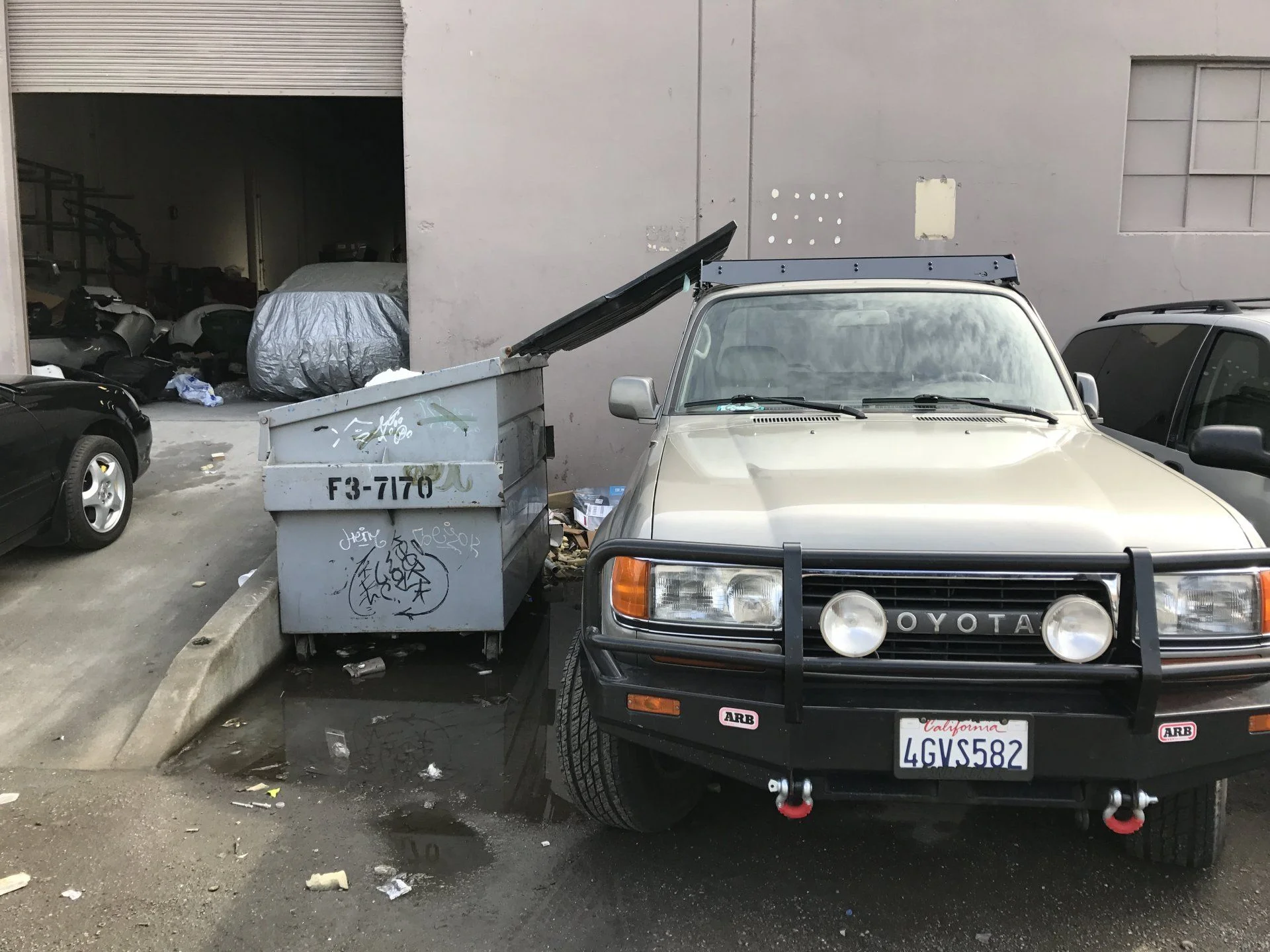

Parked next to a dumpster.
UPDATED 830pm: it was a trashy kinda day...all around!

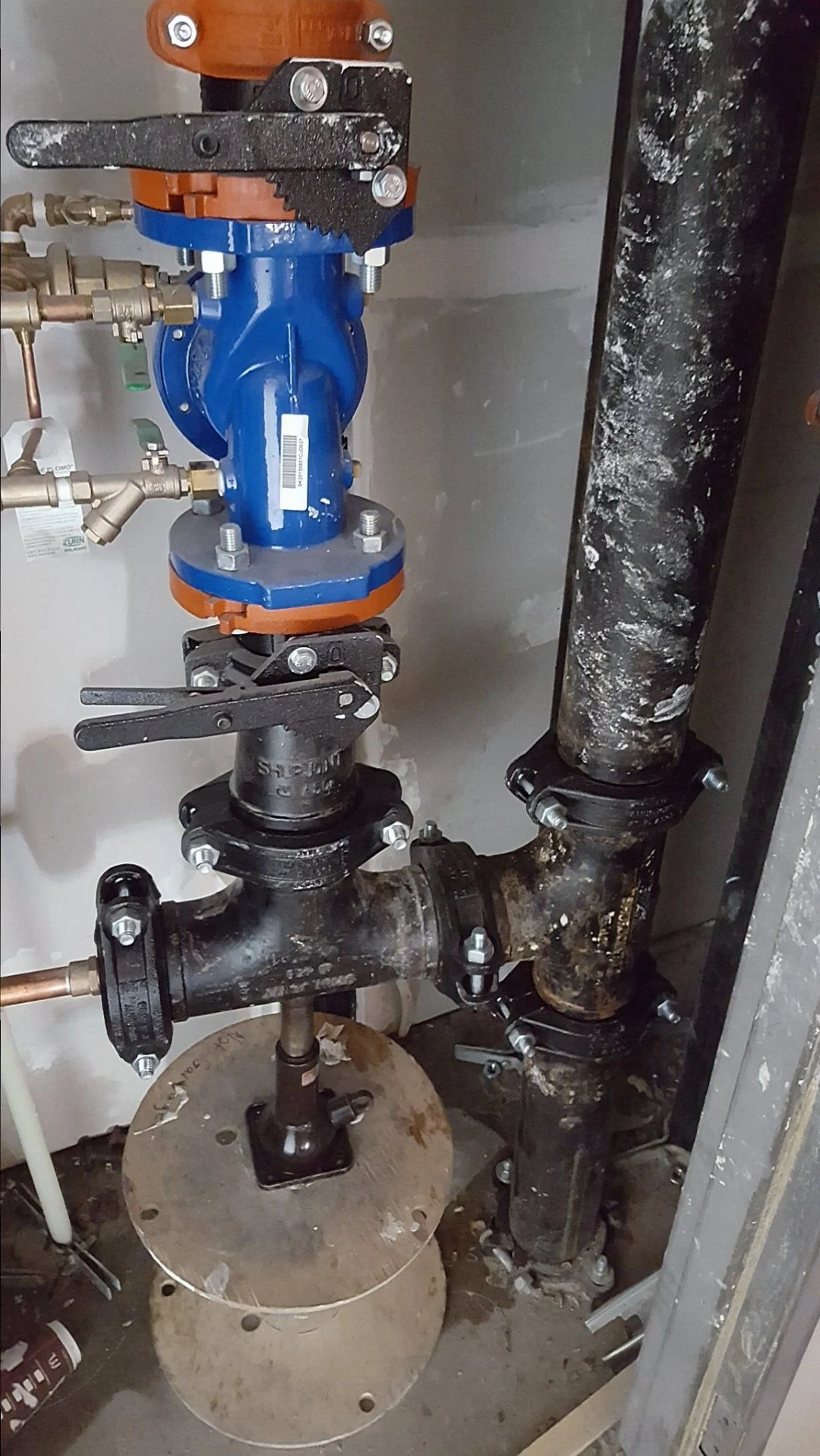

Holy jeez... What is that a 6" Victaulic flat reduced down to 1" copper??? Yikes.
The 1" part might just be for pressure testing.

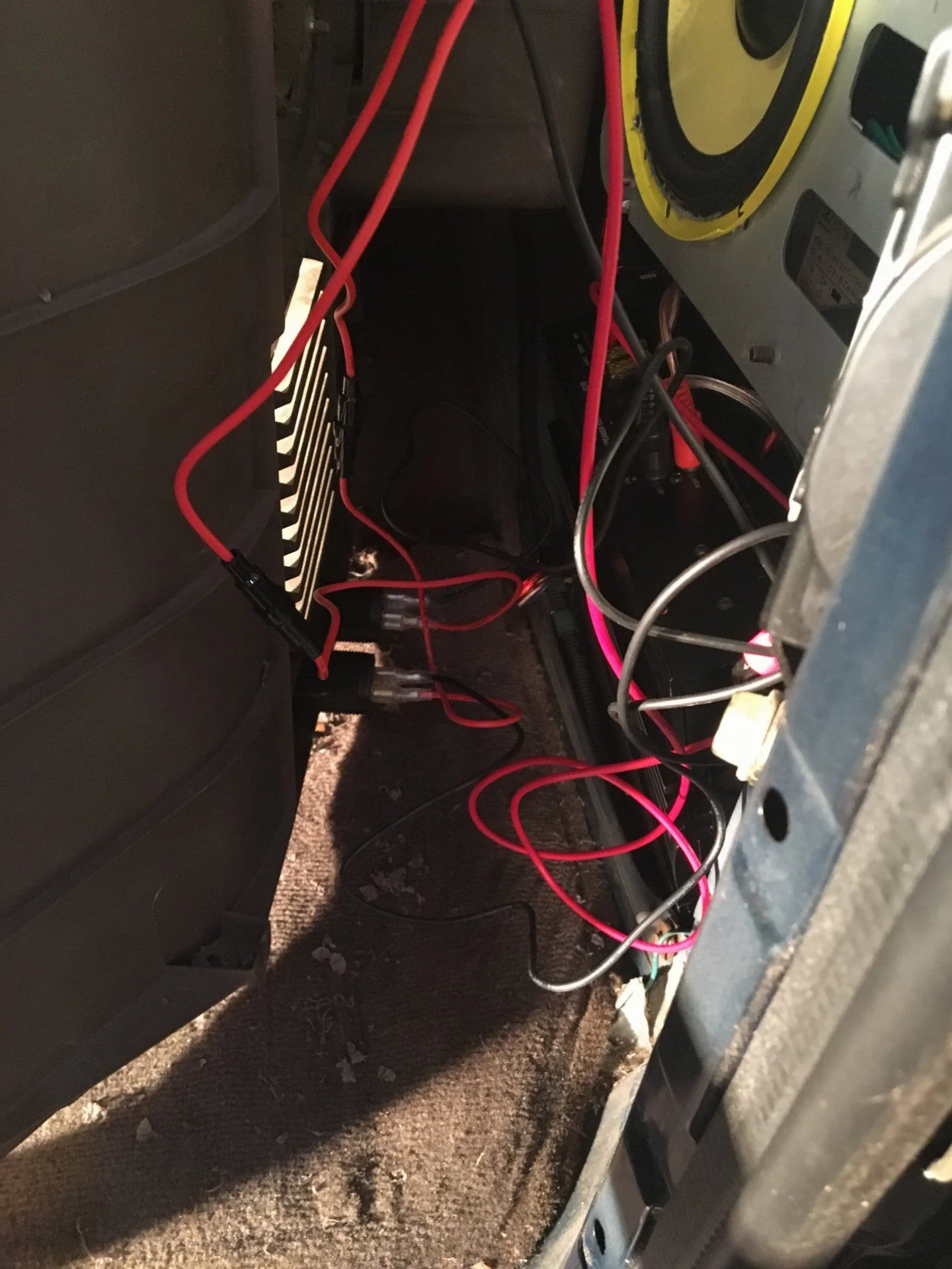

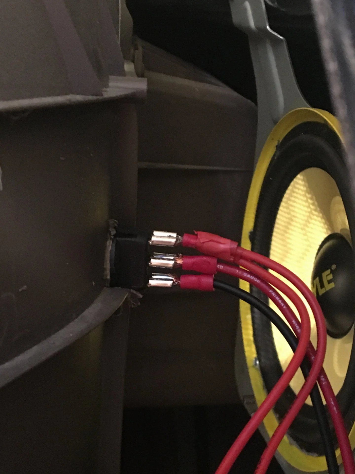

Switches came in so I installeda switch to turn the 'hot always' USB/12v ports on or off. That way I didn't have to worry about the LED lights on the ports phantom draining the battery. So now I can leave the LC off and charge phones, etc.
I already ran my sub amp back there so I piggy backed off the power cable I ran. The sockets have fuses to prevent anything blowing up that is plugged up.
Put the switch up high so it wouldn't get switched accidentally by stuff that might be stored in the back.

Yes 4" ductile to 1" copper. PRV stations are not complete. They will end up looking a bit different after whole building is done. Tested to 200 psi today and all good.

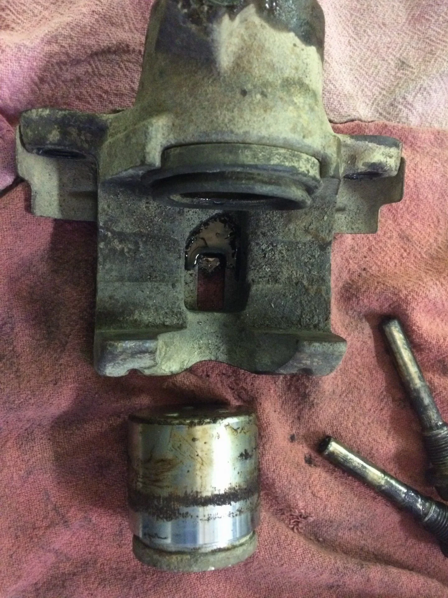

My rear caliper rebuild project hit a snag when I popped the piston out for a quick look-see. Lots of pitting, which probably explains why it wouldn't retract. Oh well. New calipers are on their way.
