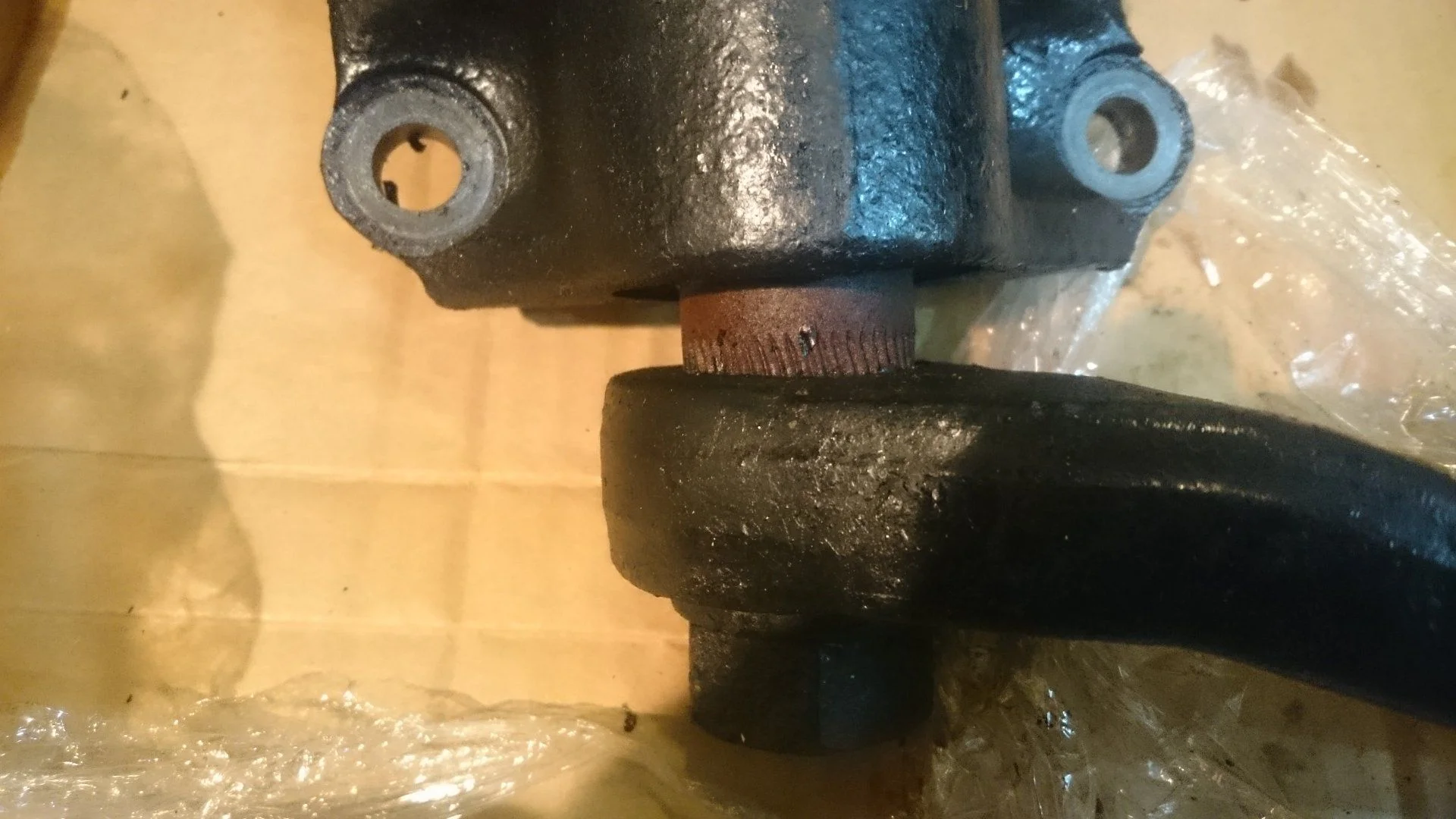

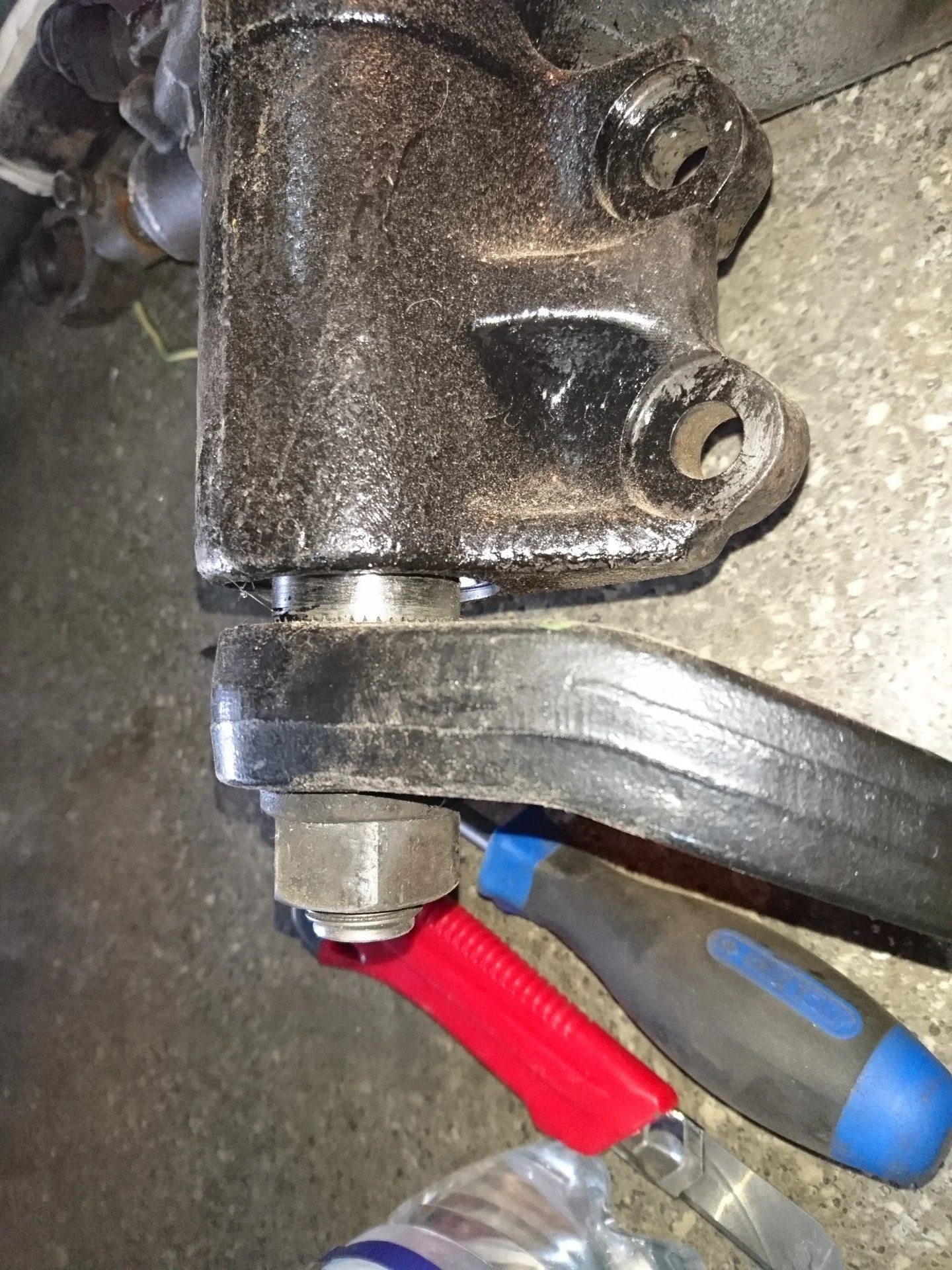

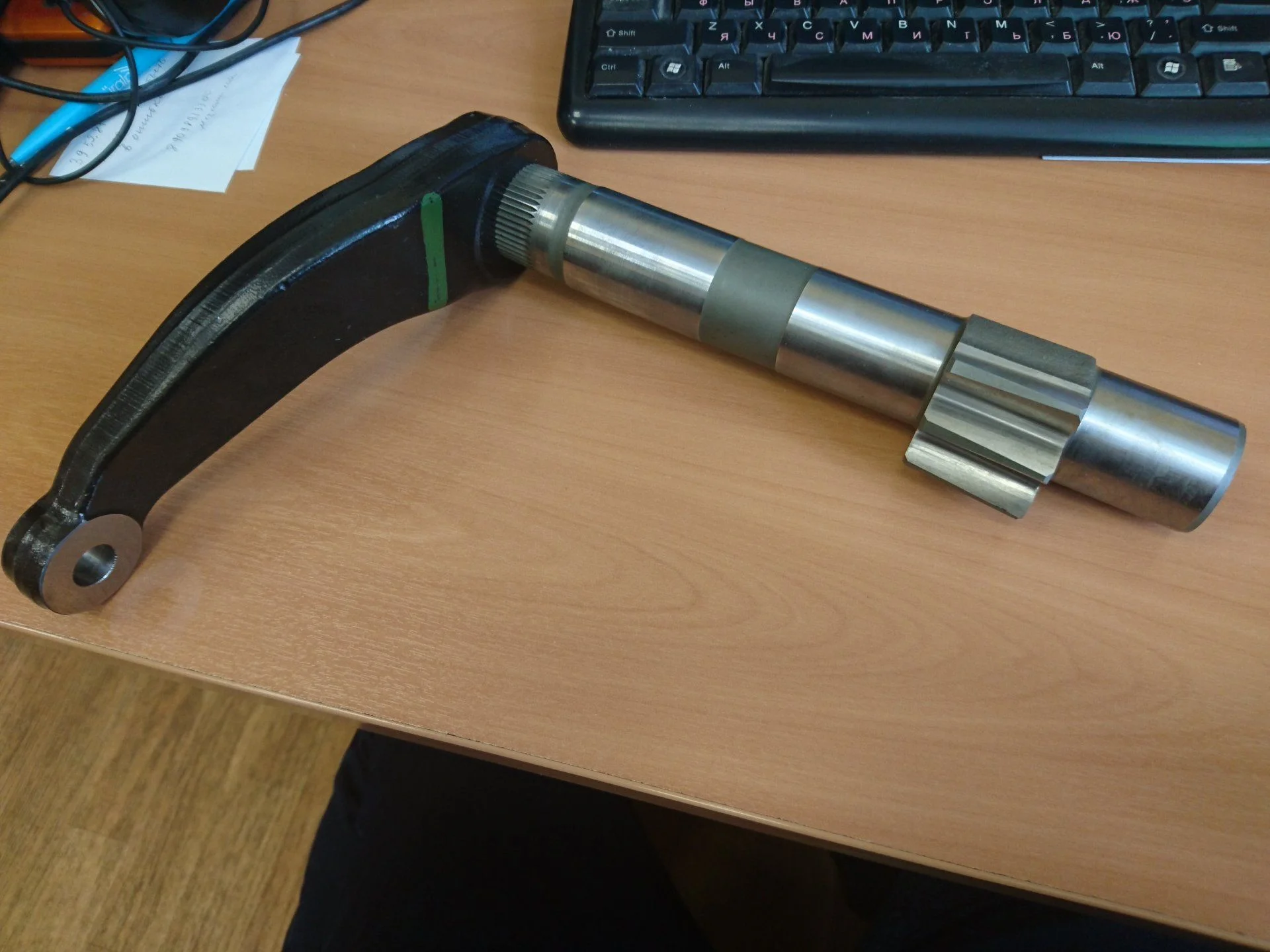

Rebuild my steering gear.
We have lots of problems with old steering rear shaft. Thay often get broken.
Slots became turned over.
Such as on the pic below.
I changed shaft and arm to new OEM ones from Land Cruiser 105 made after 2005 year. It has shaft 4mm stronger (thicker). Also rebuild all seals.
"We have lots of problems with old steering rear shaft. Thay often get broken"
Read of course as
We have lots of problems with old steering GEAR shaft. Thay often get broken.

@Alic, do you have to make any modifications to upgrade to the shaft from the 105, or is it an easy swap?
started the fun process of removing the factory Y-pipe to put in the Magnaflow with a single cat. Will have to make a short pipe to get back to the still factory muffler from prior cobble-fixes. 3 hours in and I am ready to put parts back in after having to clean the threads at the manifold for a while.
No modifications needed. Take off old and put on new. One note only, 105 shaft work with its own arm. So to change shaft you should change arm either.

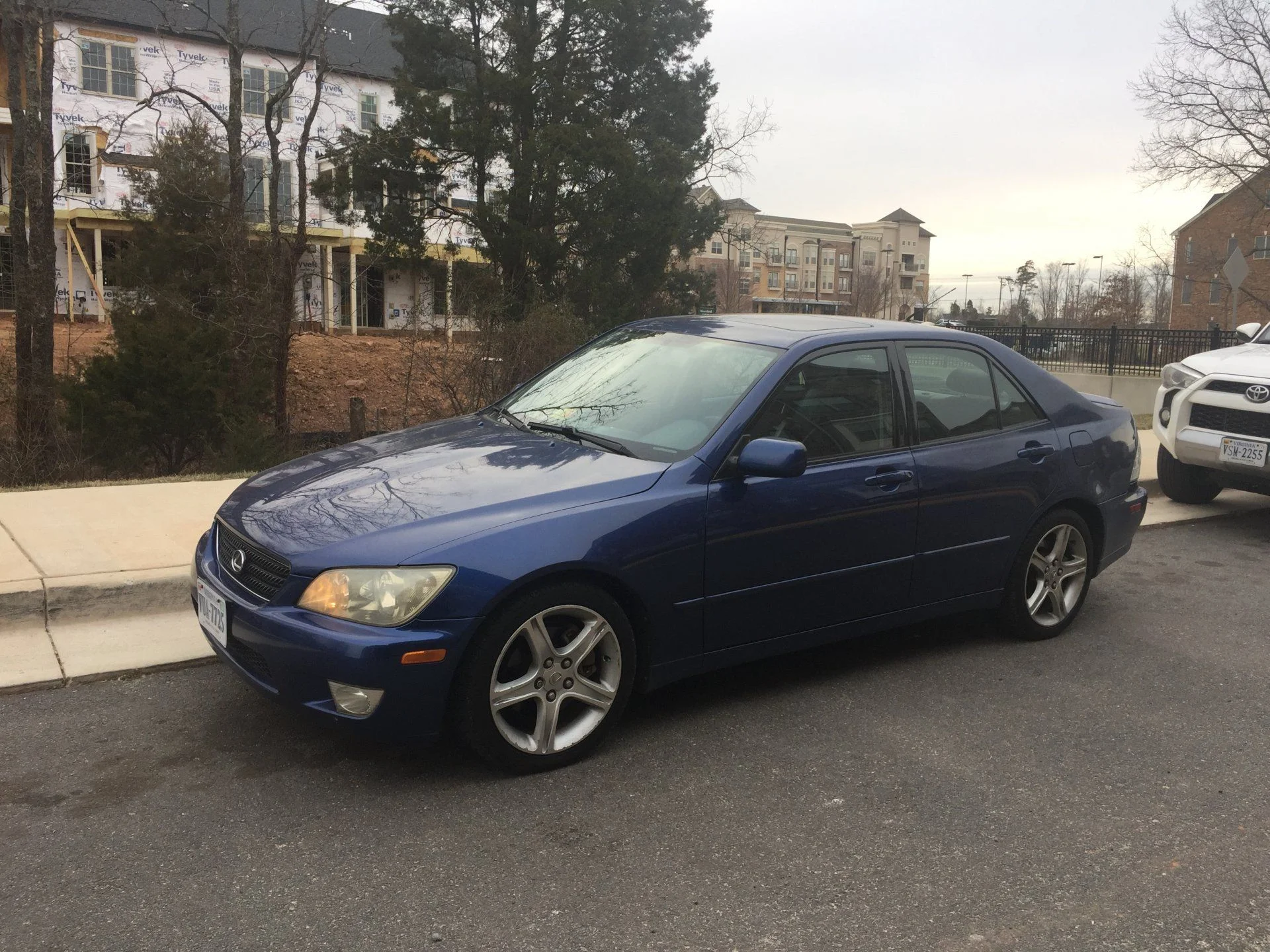

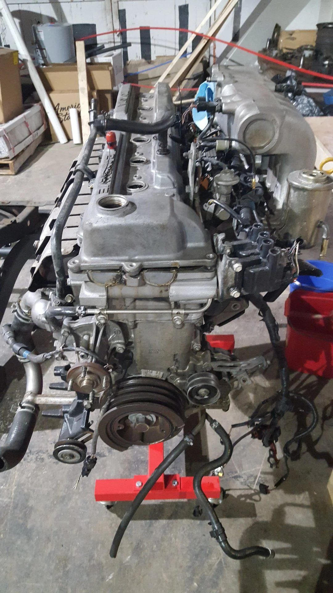

Dont feel too bad. I also joined the DD club for the same reasons. Paid $2500 for an IS300. Fun to drive. My 80 will be getting a heart transplant. Started tearing into my coilpacked 1FZ-FE from AU. Not bad only 1 hour to remove the head. Working on an engine stand makes this all a breeze. Plan on rebuilding the engine. Not sure how bad the "while your in there" sickness will be, but trying to keep it contained. Been traveling just got back from Cartagena Colombia on a magazine photoshoot for one our Land Cruiser Heaven FJ43 restorations.

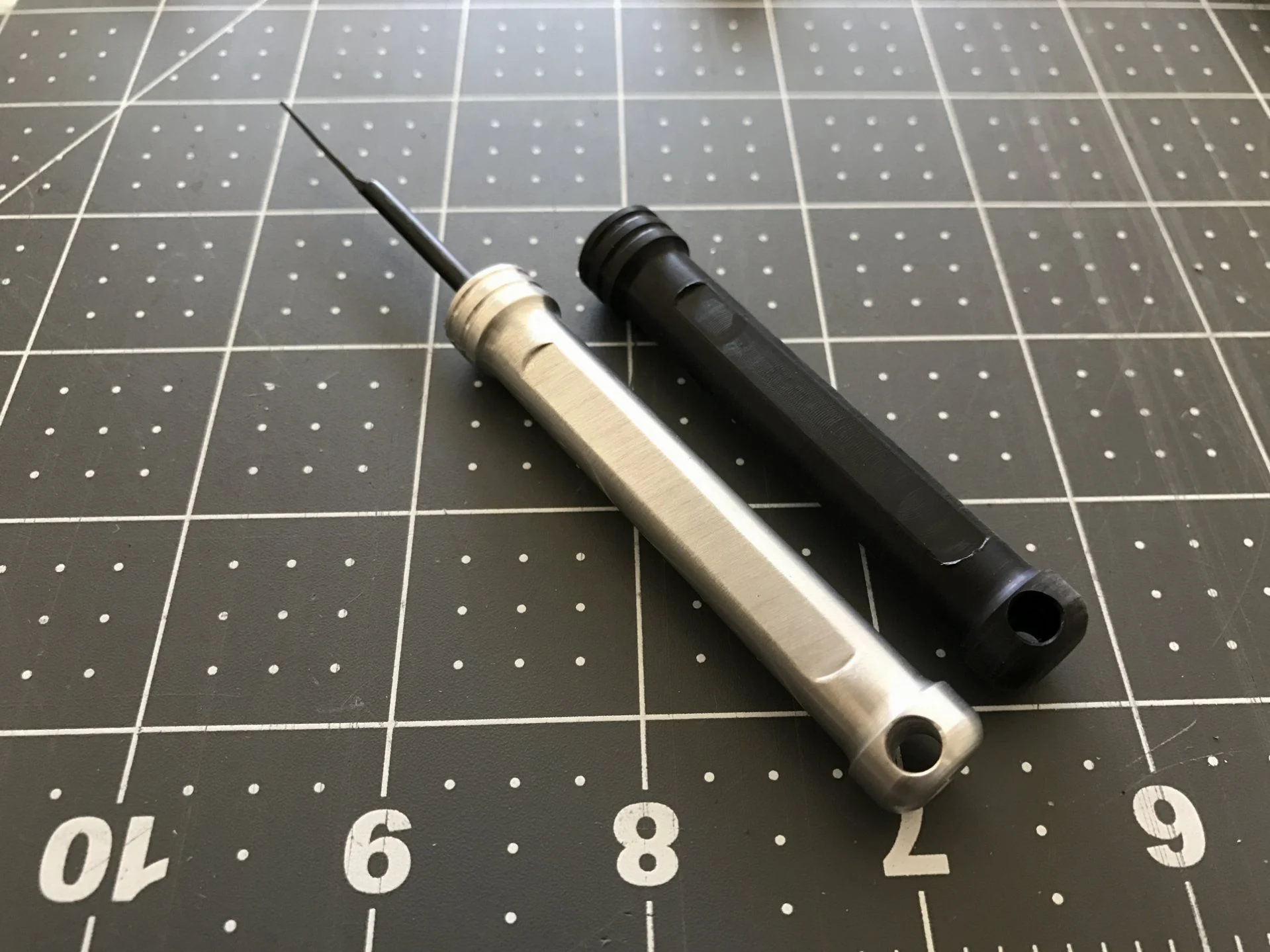

... Prison Shank Terminal Pin Removal Tool...
How much for one engraved with that phrase in the handle? I can't tell you how many random tools I come across in my hovel that I'm sure had a specific use for a specific car I once owned. Engraving will make it easier for my heirs to put on eBay in 2037.
Don't make me do it! Don't make me!!! I said don't!
