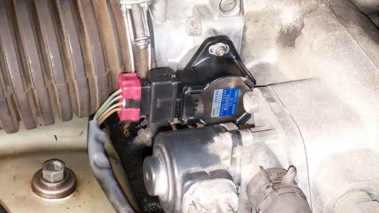

Replaced the TPS and connector. 26yrs and the last engine cleaning took it's toll.
BTW- The Toyota catalog # for the '89 3FE TPS was wrong. It's NOT the 89452-14050
The correct part # is 89452-20050.
The connector that I found was SKU: ST4PIN from wiringspecialities.com

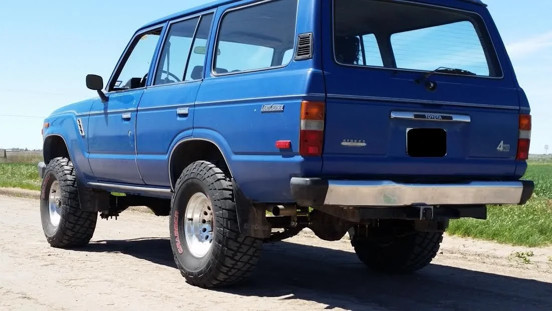

Lifted and tired my 84 FJ60. Wasn't looking for this but i just couldn't pass it up. Original owner 131,000 miles. Downey V8 swap in 95. Super clean.
I had contemplated what these Grabbers would look like on a 60 and didn't consider them
favorably...but I gotta say, they look real good. Brought them back into the purchase discussion.
I wonder how the 33x10.5 version looks, being narrower.
Have to say though, it would be pretty tough for me run reds out. ;)

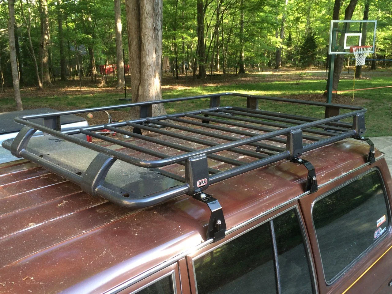

Installed an ARB 100 series roof rack (a friend had for sale for a price I couldn't refuse) on my 60 using Trail Tailor @reevesci gutter clamps and some homemade extension brackets.

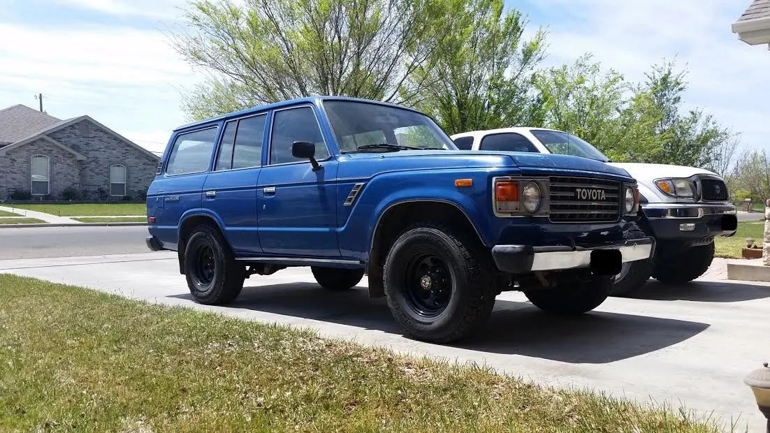

Got some Cooper Discoverer 255/85/16 mounted and balanced on some 70's steelies.
Those look great! Are those rims still available new?
