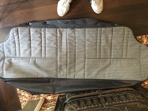

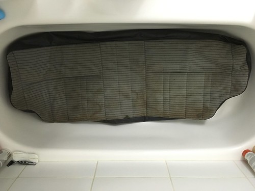

Cleaned the rear bench seat bottom cushion. Oxiclean soak for 3 hours plus light scrubbing and agitation in the tub. Most of the stains are gone. Still smells a little "old" but it looks 10000% better. :)

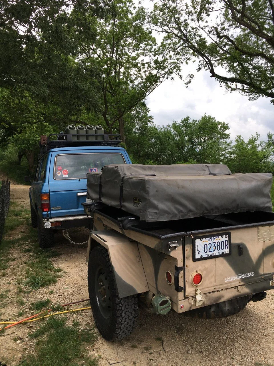

I used my 60 and my M416 to haul coolers full of ice, mulch and tables and chairs around for a fund raiser. It's not fast, but it gets more attention than a Ferrari.....

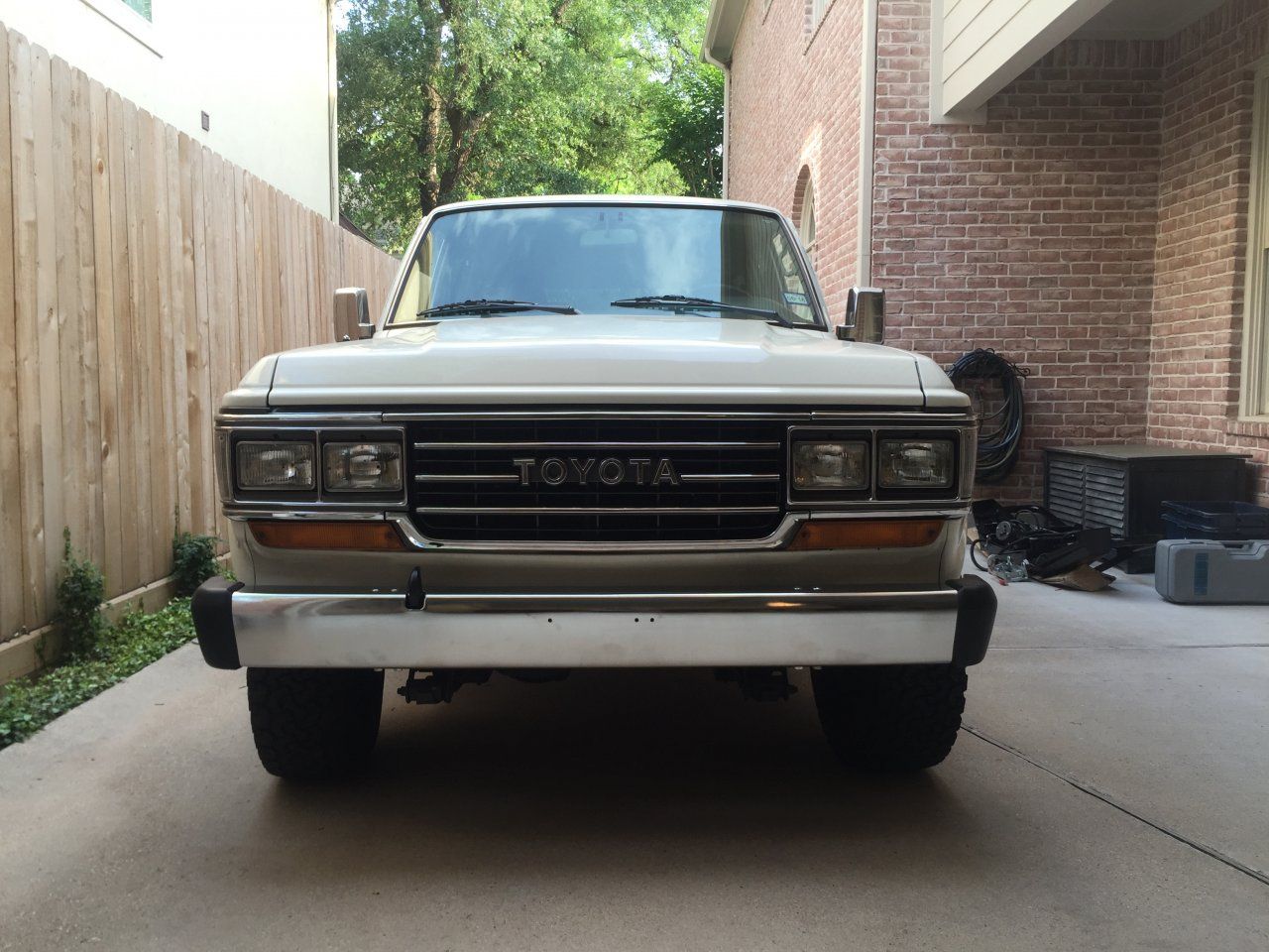

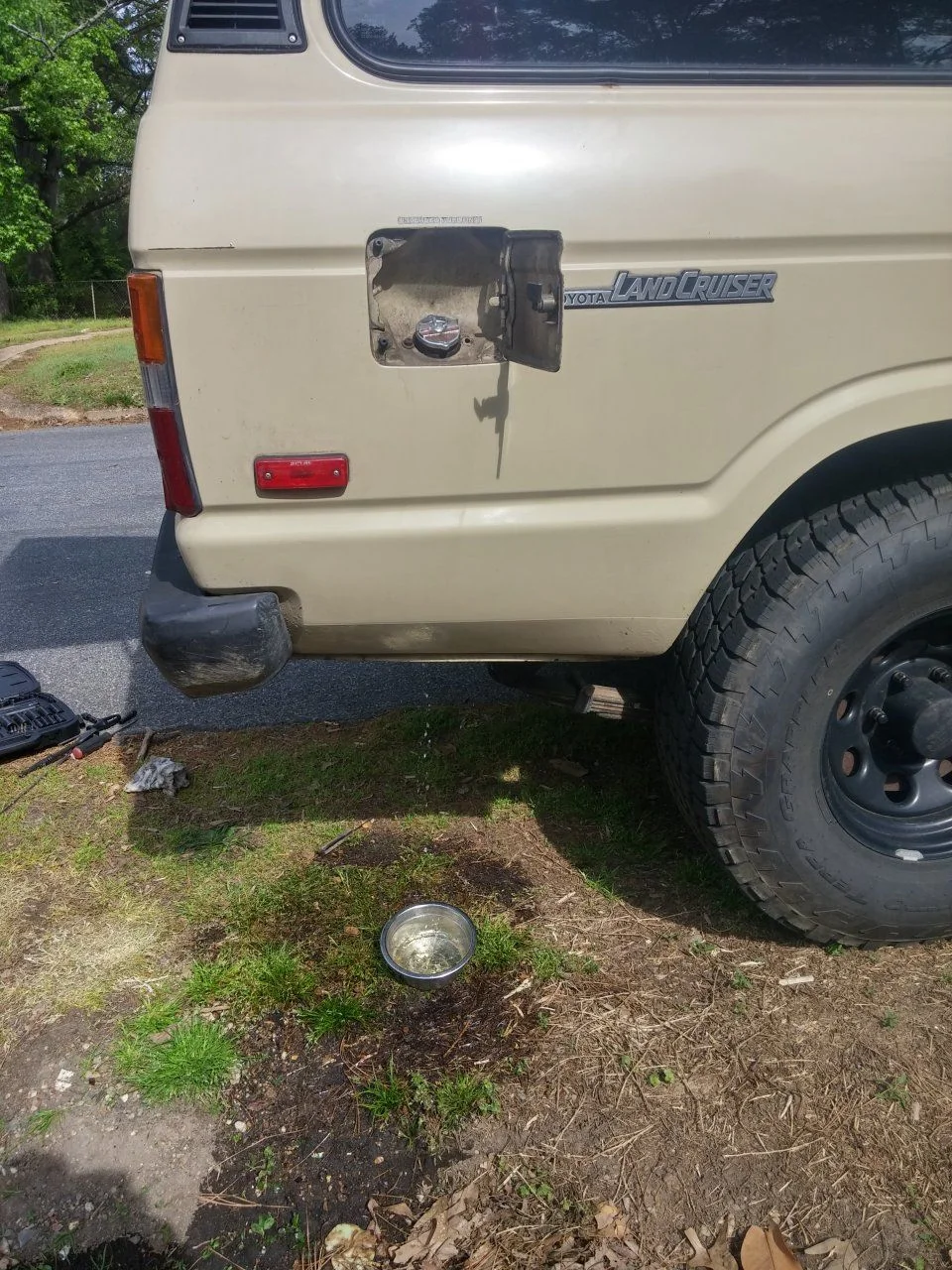

Installed washer #44 to fix sloppy shifter, fixed fuel door spring issue and went back to OEM chrome bumper on the front from ARB.

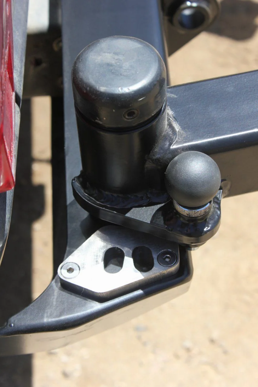

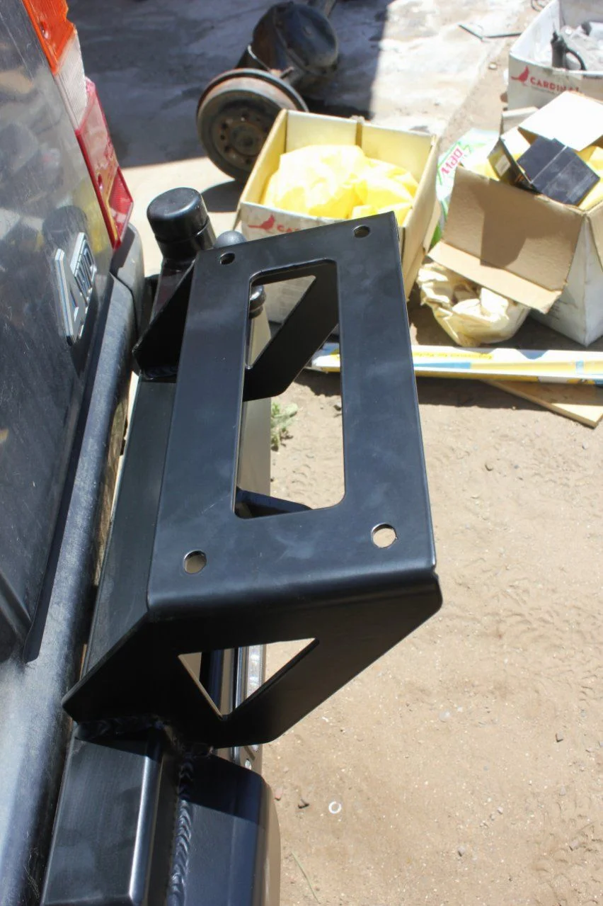

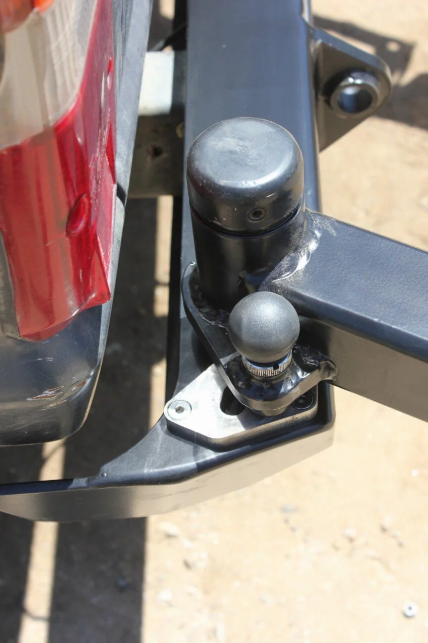

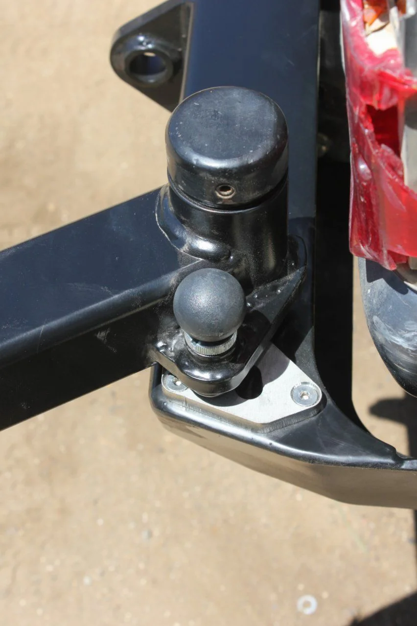

I've added a lock out I'm hoping will solve certain issues with lockouts. Simply having a hole in the steel that you paint or powder over leaves a
contact point where the lock pin invariably destroys the coating. Once the paint chips rust forms. In the case of powder the rust begins to migrate under the coating causing it to lift. I decided to use a 3/8 stainless lock plate that bolts to the top of the carrier. This allows me to powder before the install . Welding the plate to the bumper rather than bolting it would leave a gap between the two for moisture to collect.
Rust would form and rust stains would bleed from between the two.

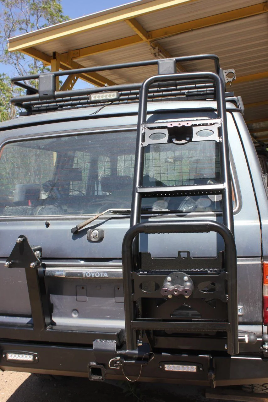

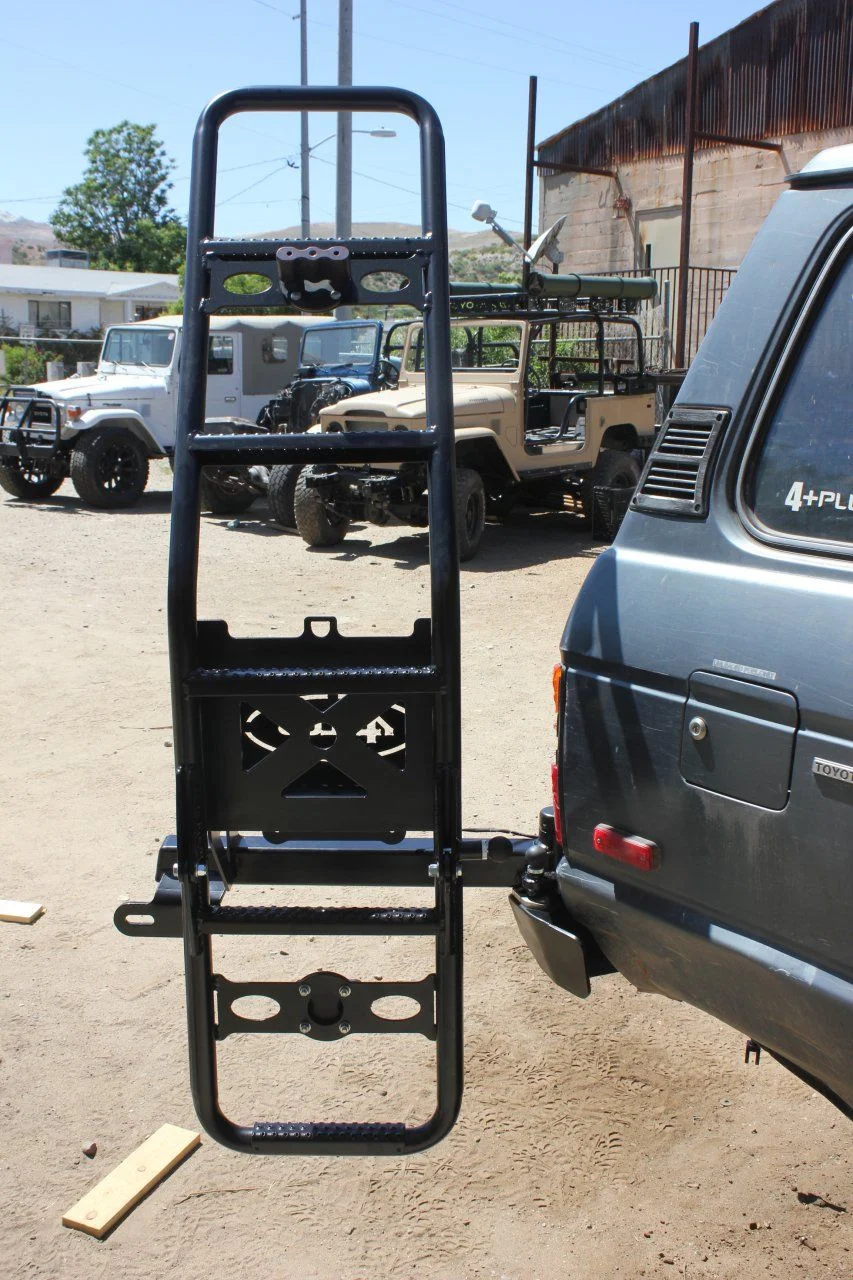

not much else has changed. I am considering a winch version since I have only pulled a trailer once in ten years. It means losing the hitch unless
I want to lose departure. I have gone to a shorter platform and changed the bolt pattern on the gerry can basket so now the ladder assembly
and can basket use the same platform.
Now the two can be swapped or someone that buys the bumper with the can basket can add a ladder in the event they buy a roof rack later
