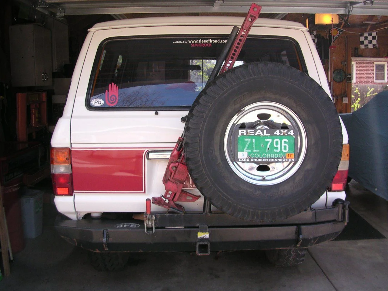

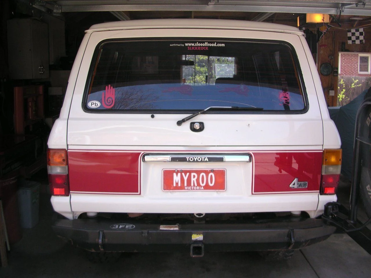

MS is so laid back compared to CO. I got a ticket at 5:30 in the morning, no other traffic around, for making a right turn and going to the left lane too soon. Even though I was turning left coming right up. Bastards. As for the plates, If the Hi-Lift wasn't there, less than half of the plate would show and I'm guessing yours is similar. That really wouldn't fly here so no Trasharoo for me.

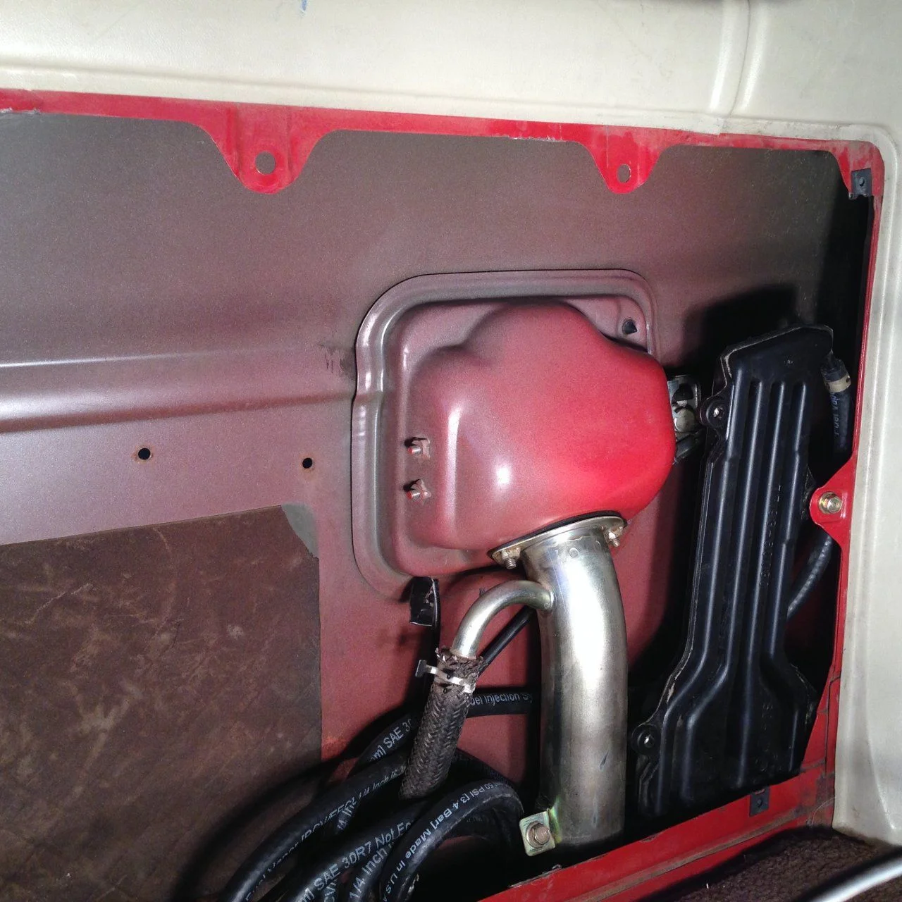

Spent a bit of time on relocating the Evap assembly on my 83 FJ60 to make room for eventual side panel storage. Hidden mod, who can find it?

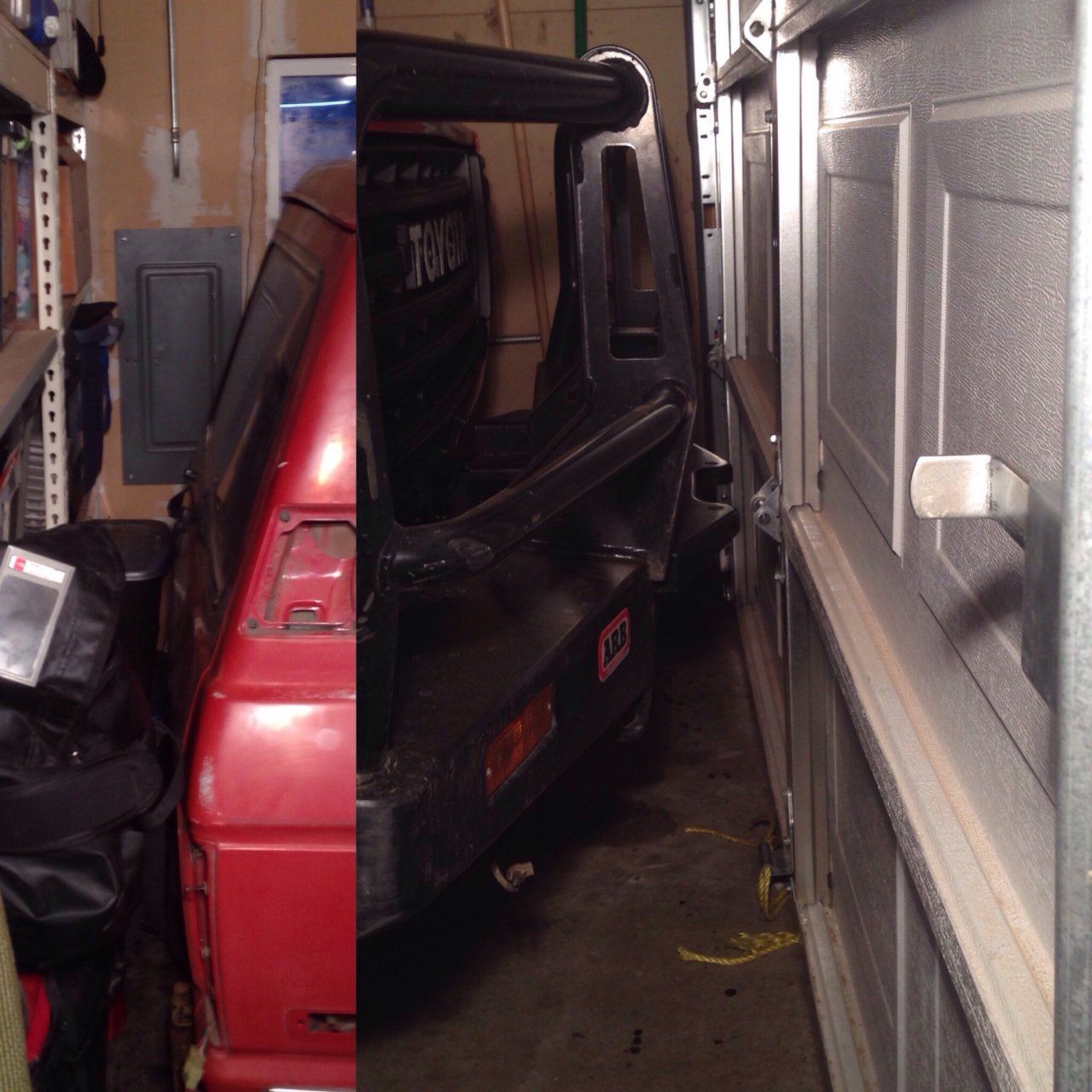

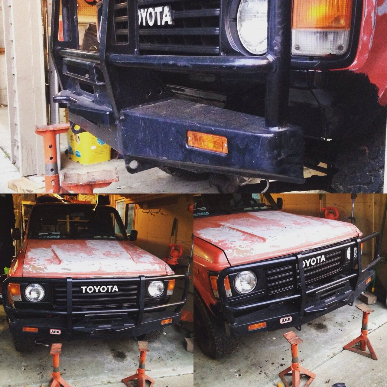

Also test fit the the bumper on the car. Sticks out a fair bit it, but I also haven't had a bumper on the front in a while.
Which made me think about if it would fit in the garage.
Tons of room. Looks like the bumper is going to get put on after the monstaliner is done and the car lives outside.
^^ remote latch for the fuel door?

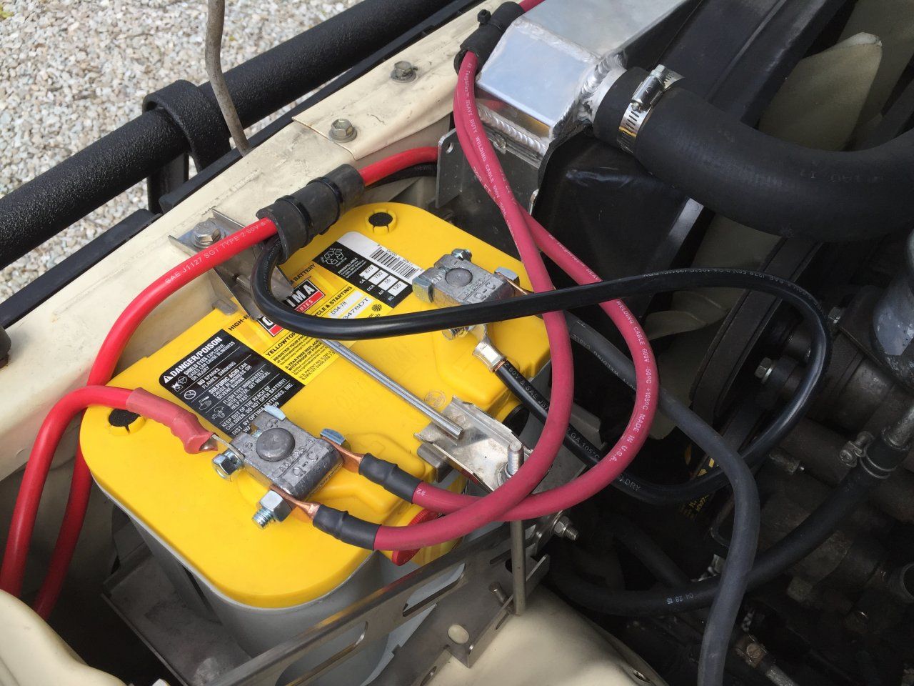

Hooked up my dual battery for the winch. Need to do a little wire trimming later.
image-jpeg.1246799
Beautiful routing and shock/rubbing isolation. Love those post connectors.

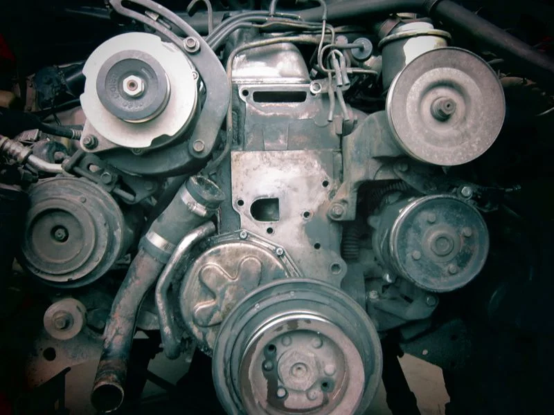

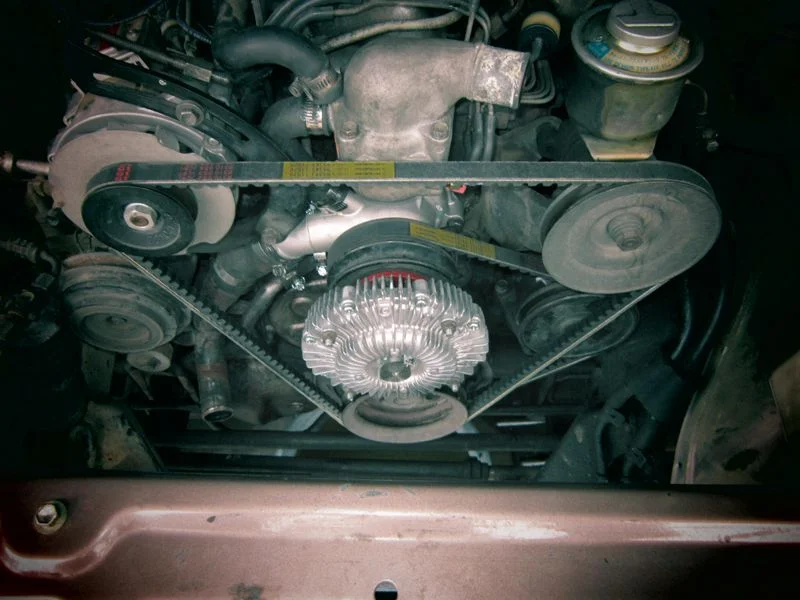

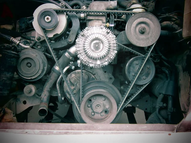

What I did today...a little messier but my own fault ;)
t-stat
waterpump
bvsv 1 & 2
clutchfan
gaskets
hoses
clamps
belts

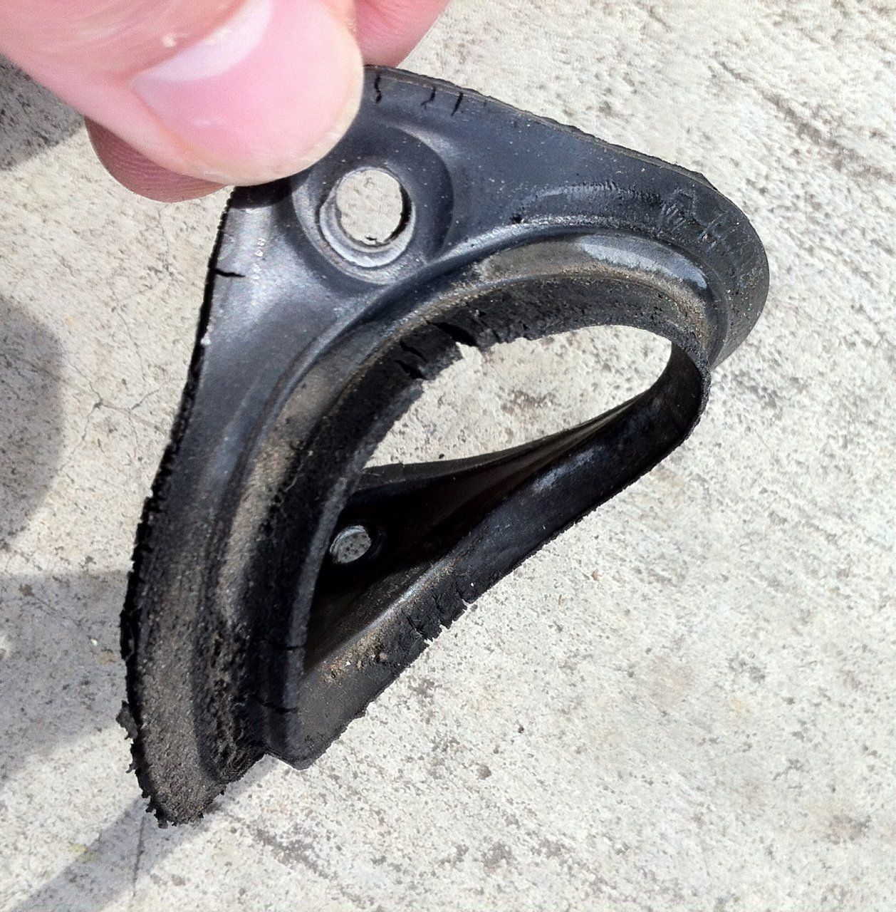

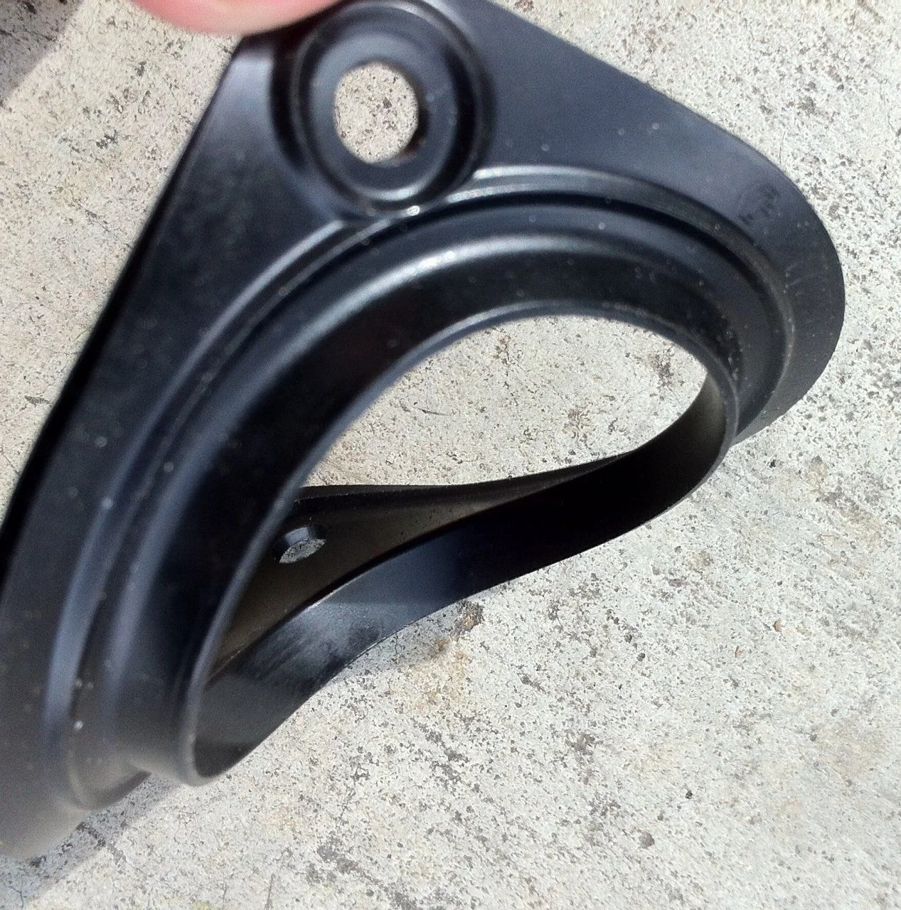

Pretty simple job but, I replaced the fuel filler neck gasket. It was leaking water into the rear quarter panel. Took about 10 minutes once the interior panel was removed so I could get access. Here is a photo of the old then new gasket.
This is definitely on the list for projects to complete soon. Glad it was easy!
