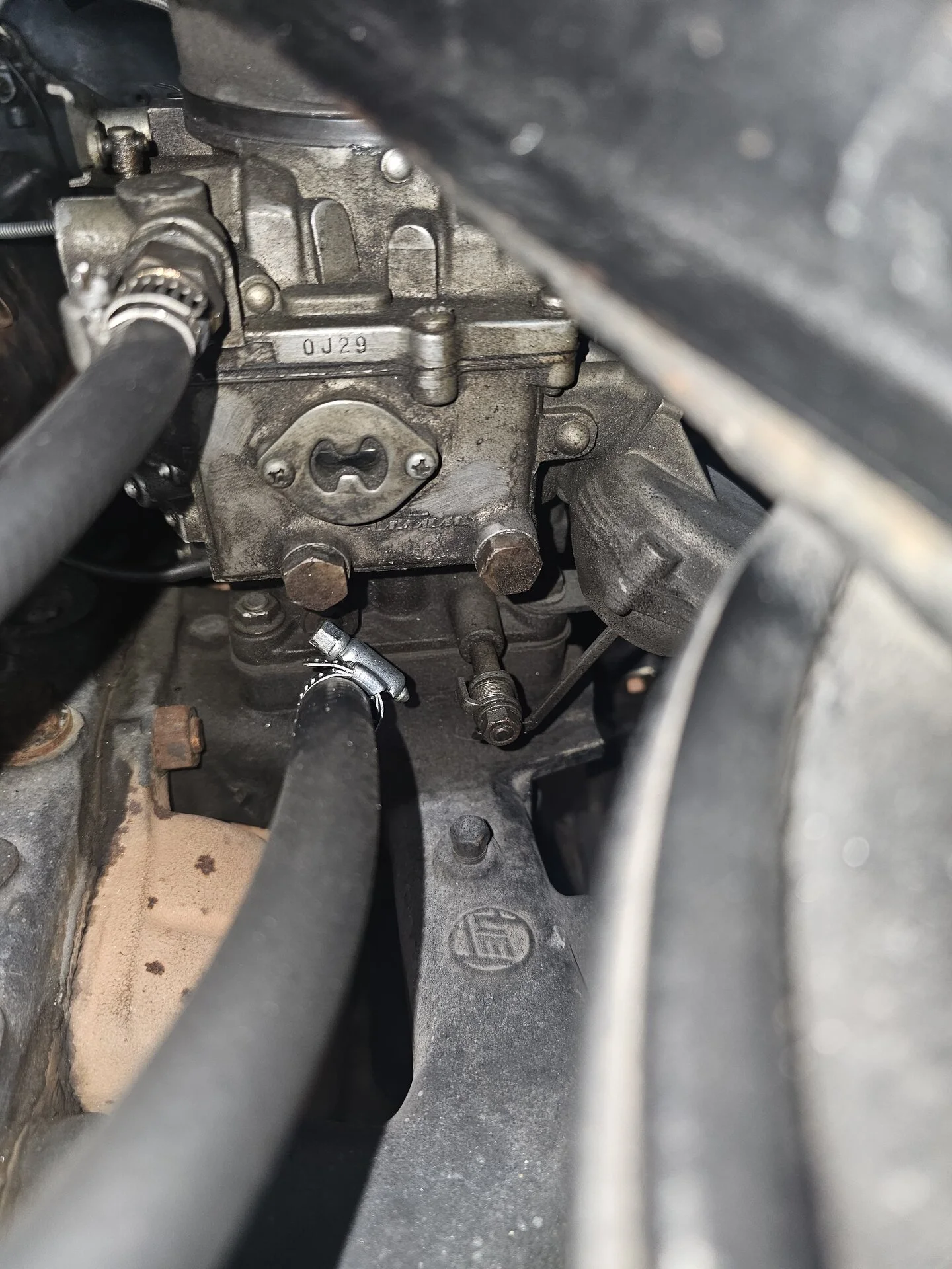

What carb is on this Jungle 43?
Oct 15, 2022
14
46
Saint Simons Island GA
Any ideas? The cruiser is a 74 fj43. Apologies for the potato photo
Looks like a vacuum secondary Aisin.
Second that, on top of 74 insulator. Linkage could be interesting, as others have said there were issues with the vacuum secondary carbs having clearance issues on F manifolds.
