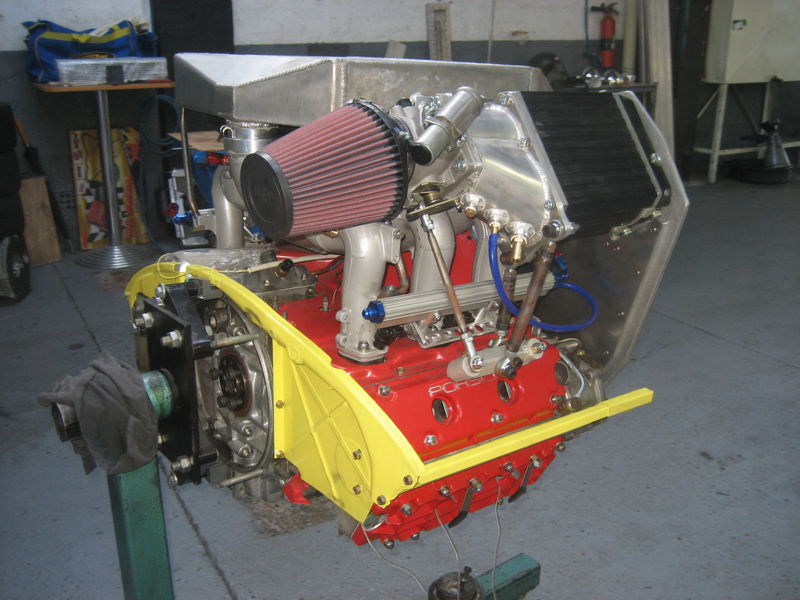

I have some with twin plugs too....;-)

These old I6 engines are water cooled...and as long as water is flowing through the head....and it’s not boiling over....exhaust valve seating duration shouldn’t be an issue....air cooled is a bit different (P-Car example above), old VW’s, Porsche’s, and Harley’s are sensitive to lugging where you have an open throttle at low RPM...lots of fuel/air, high combustion pressure and high temps...so high that the airflow across the fins can’t dissipate the heat fast enough....some of my early hot rodded VW’s...the hot setup was was sodium filled exhaust valves. I think for some Porsche’s, sodium valves are still available (JohnJL you need to check me on that, my P-Car is H2O cooled).
