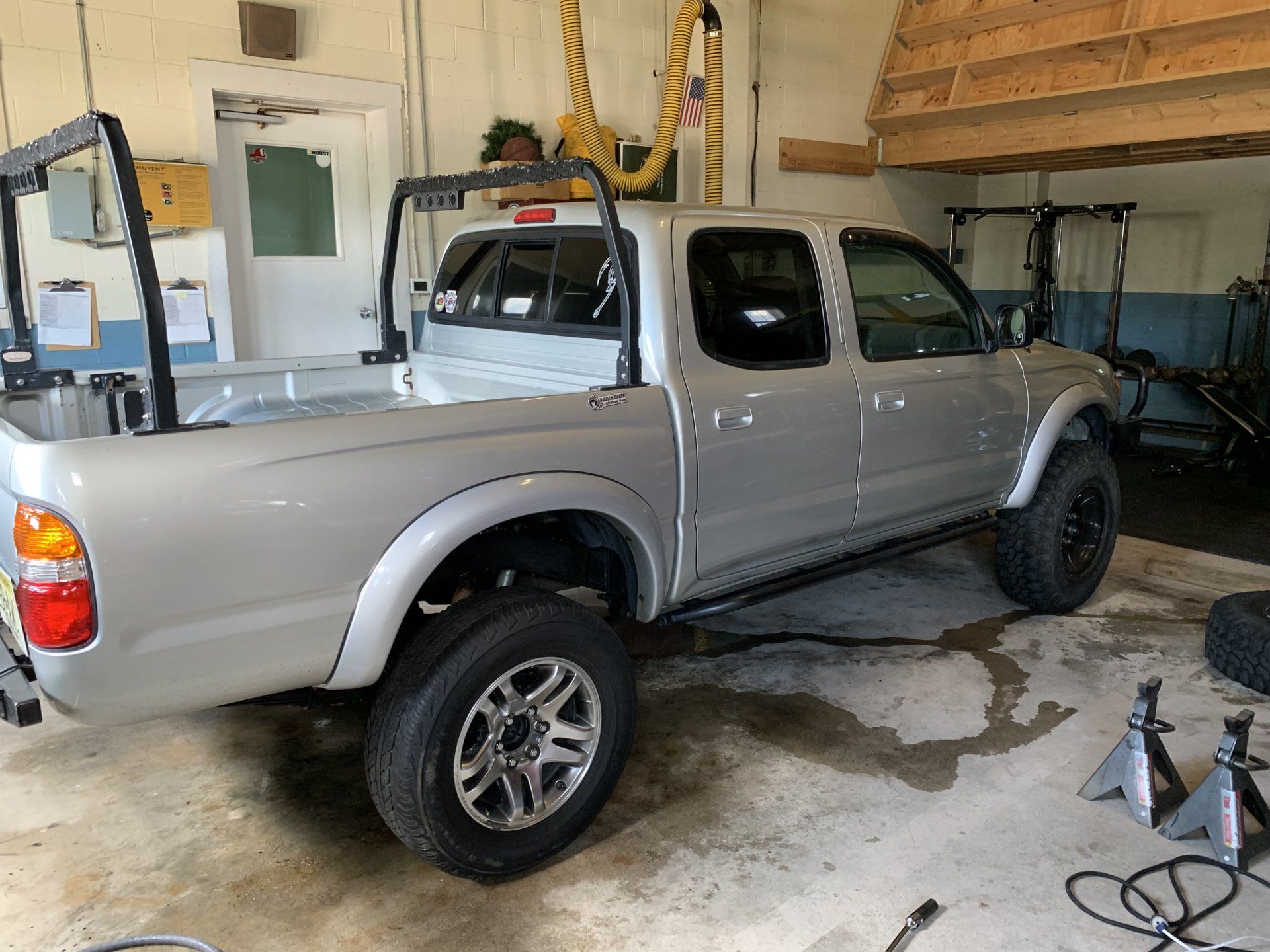

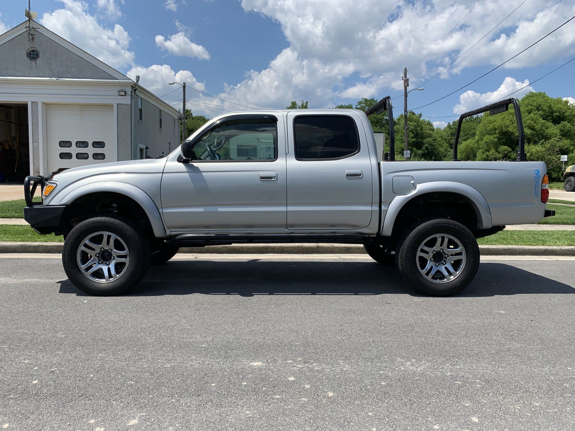

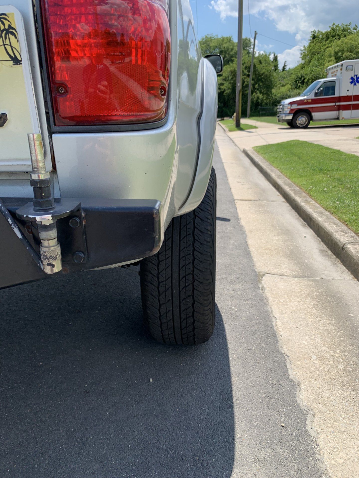

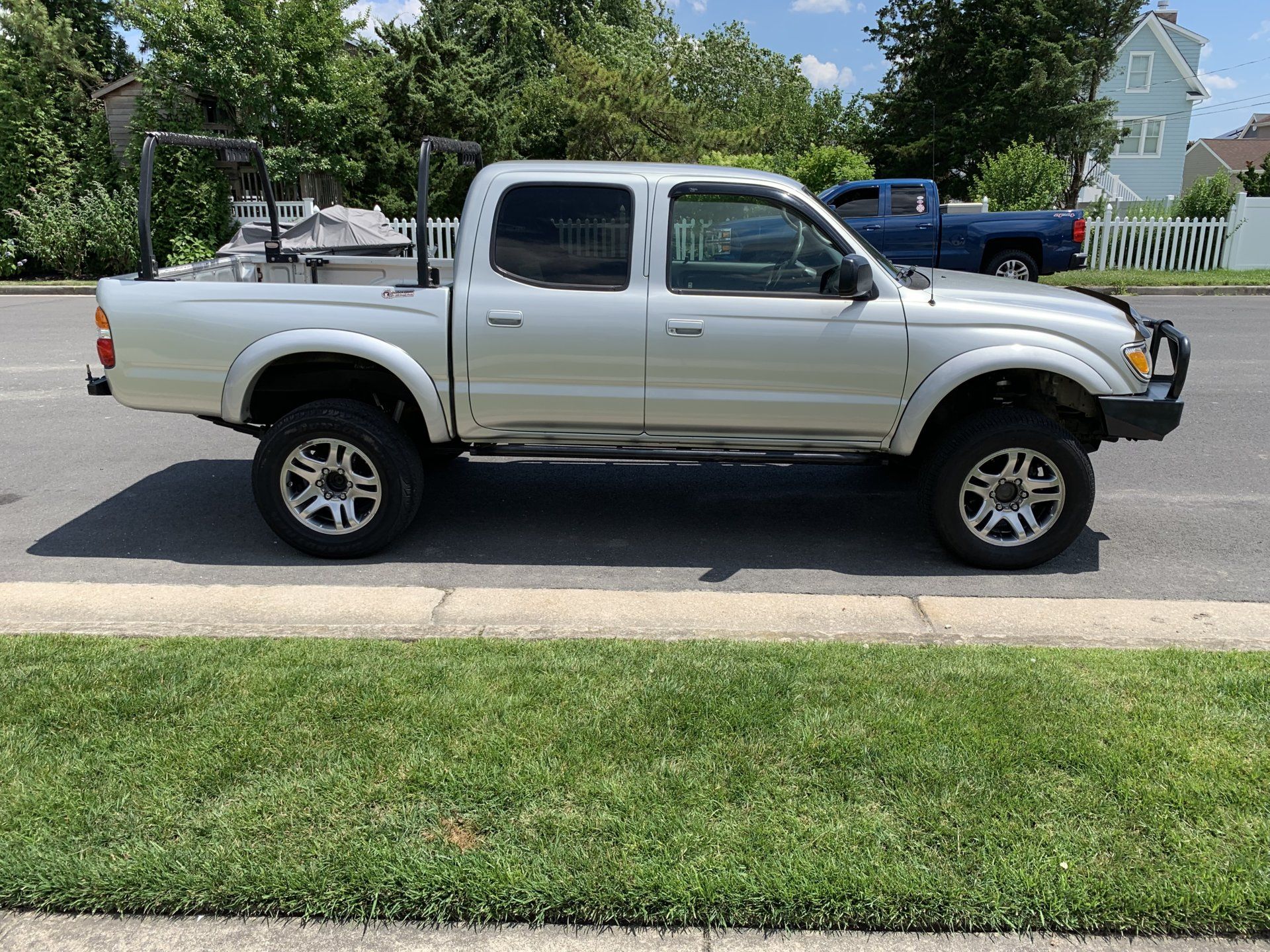

Did a tire rotation today so I figured I would test fit the new 17” sequoia wheels I plucked off Craigslist. I wanted to make sure there were no issues with the spacers and see how I like the silver on silver look. Gave them a good scrub and bolted them on with no issues. They actually drove really nice like riding in a limo! It’s been awhile since I drove my Tacoma with stock size highway rubber! After the test fit the bighorns went back on for another round of abuse. Let me know what you guys think- keep them silver or paint them black. The only thing I don’t like about them is the small slot between spokes is going to be a pain to keep clean and the offset is a little more sucked in by .5”

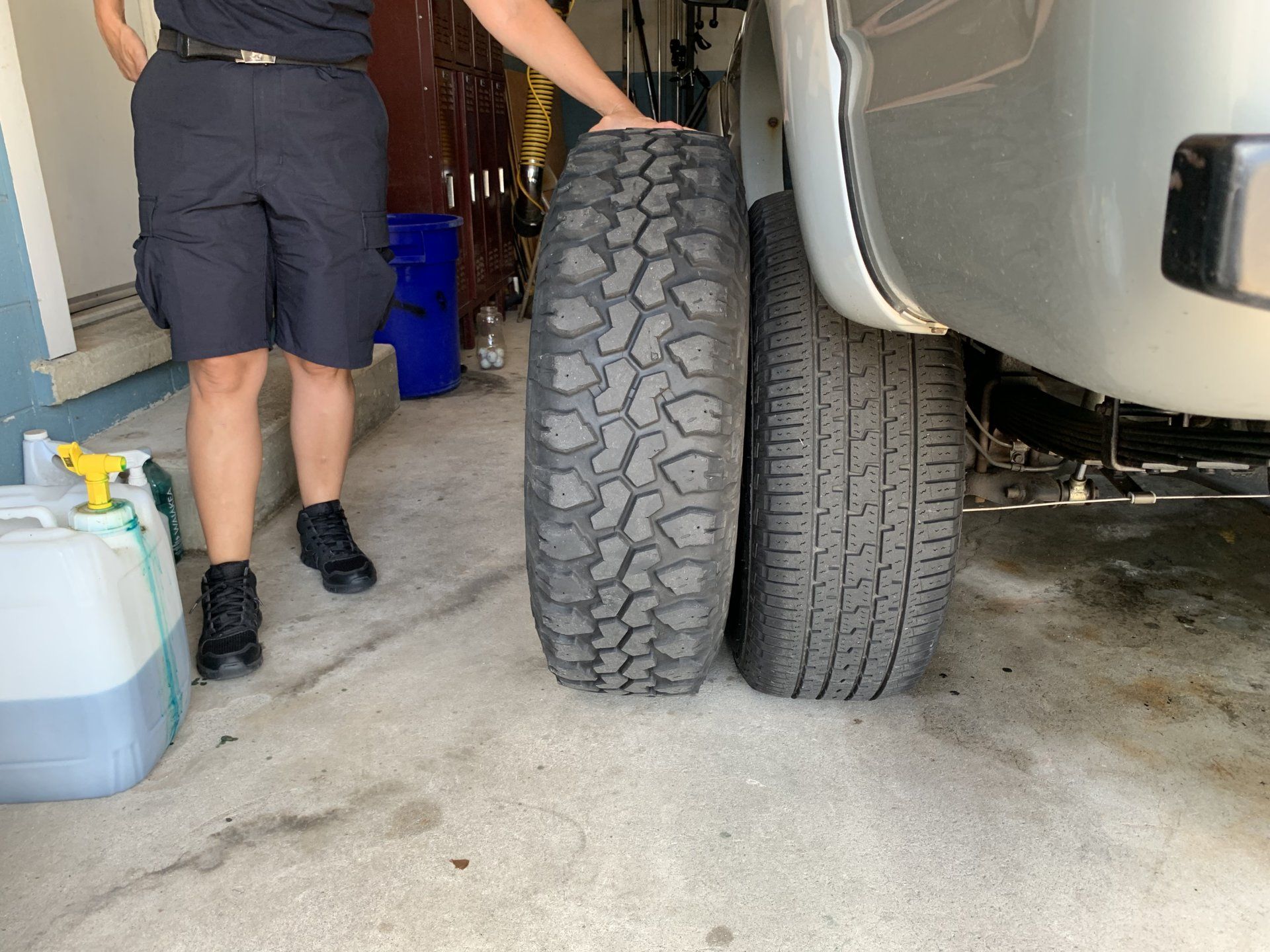

Here’s what a 255/85/16 looks next to a 265/65/17.

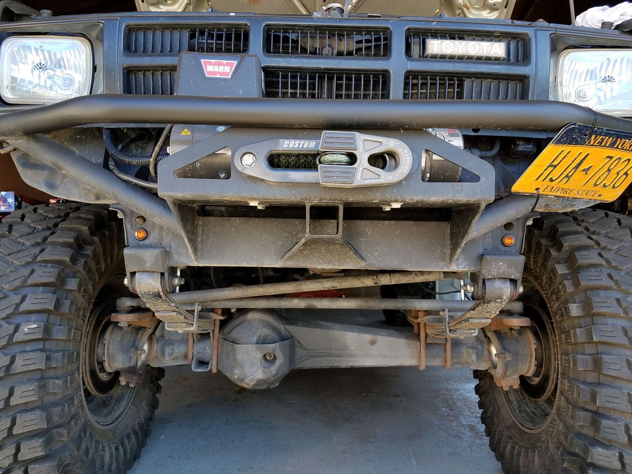

@hman913, I like those!
Would you please share some pics of your steering box and how it's mounted, can be via PM.
I'm installing cross over steering on an '81 and have some questions.
@Pacer thanks.
2019642
Typical IFS steering box with reinforcement plates welded to both sides of the frame. The box is mounted as far forward as the front crossmember allows. If you need anything else lemme know!

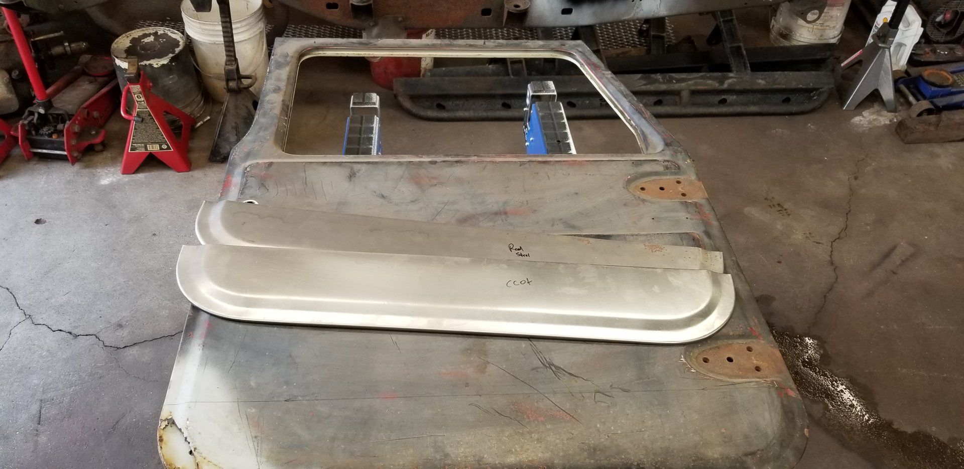

So are the CCOT panels any better?
apparently my standards are set too high, i'm not overly excited about either set.
what it's looking like right now, is using the ccot outer with rs inner panels.
That’s surprising - I though the corners of the inner panels on the RS set left something to be desired (clearly hand peened with minimum effort). I thought the outside panels for RS looked pretty good. I haven’t seen the CCOT to compare though.
