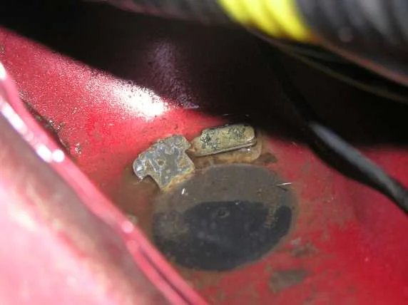

I know there are probably 1000 posts about wet vehicles. We've read about clogged sunroof drains and windshields. I fixed the leak in back windows with silicone. I am ever more frustrated though. Took the cruiser to Toyota to have them clean out the drains and see if they thought that was the problem. Both DS and PS floorboards are wet wet wet. Basically they charged us 180.00 to tell us that they ran water down the drains and the PS drained pretty well and the DS was slow. They then said that for $450.00 they would remove the headliner and further inspect the drains and sunroof to see if that is where the leak is coming from. They said they didn't want to ream out the drains because if they were brittle they could make the leak worse. I've done more investigation myself. I ran water down each drain. The ps did drain but also filled up the rocker panel. The ds never escaped through the drain, all it did was fill up the panel and enter my truck soaking all the electrical wiring.
My question is that obviously we could pull the plugs on the panel to let it drain out but they are there for a reason right? To keep water from coming in when you go through deep water crossings? Are the sunroof drains supposed to drain into the rockerpanel? I thought they were supposed to drain just behind the front tires.
Please help. I'll post pics under norcal sams name because I dont have the space under mine.

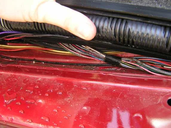

here are some pics. As I put water directly down the sunroof drain it fills up through the plug into the channel shown.
Teresa

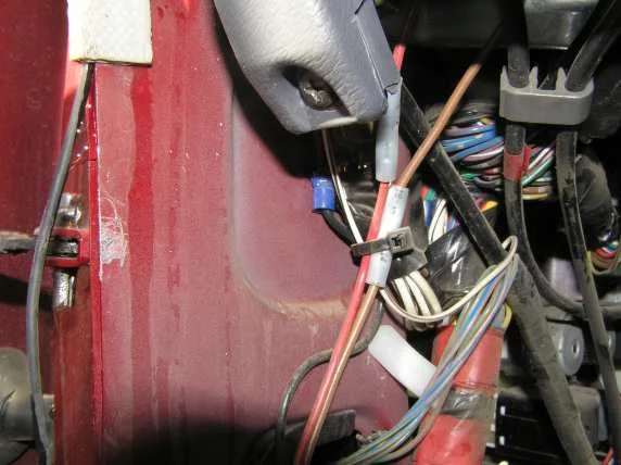

Then it starts leaking at the upper A piller and from the door molding. The last pic is the water draining out from the panel. Shouldn't it drain from 1 location if all is working properly?
