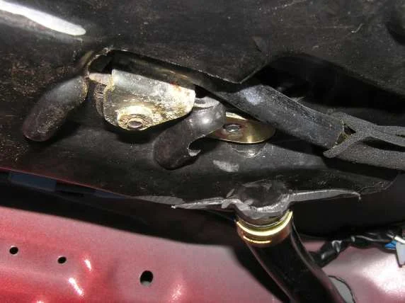

pics of slits
okay... my d-dide floor is soaked after the 12 inches of rain we got in the past 9 days. i popped the drain plugs on the rocker and no water came out. i made sure the slits were clear and they were. i took pocs of the headliner where the water is clearly an issue... looks like i have a clogged or busted drain hose...
what is the best method for clearing the drain hose?
here is a pic of the water damage, the drain hole and the elusive slits... there is a middle slit but mine was bashed on a rock.
