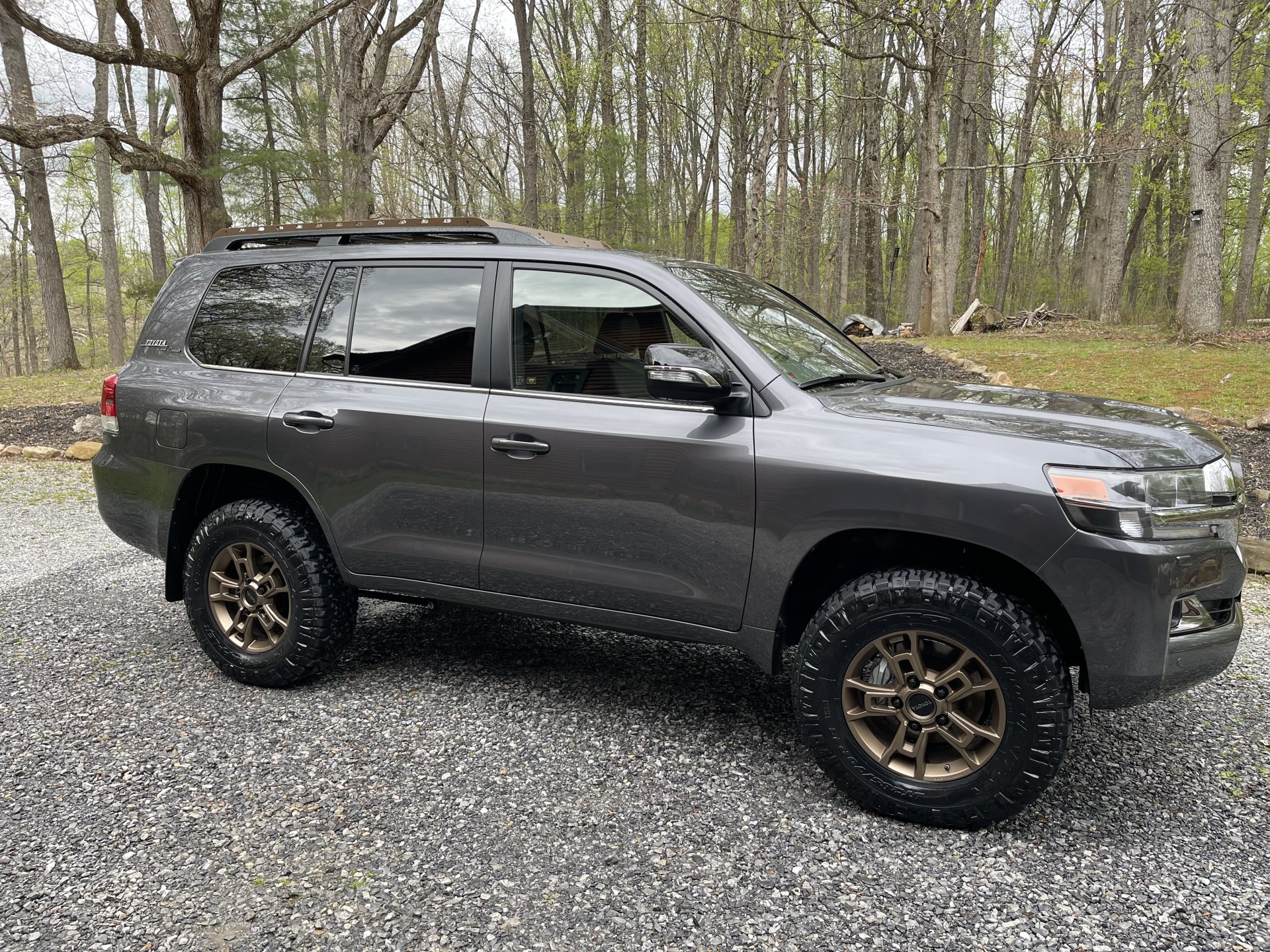

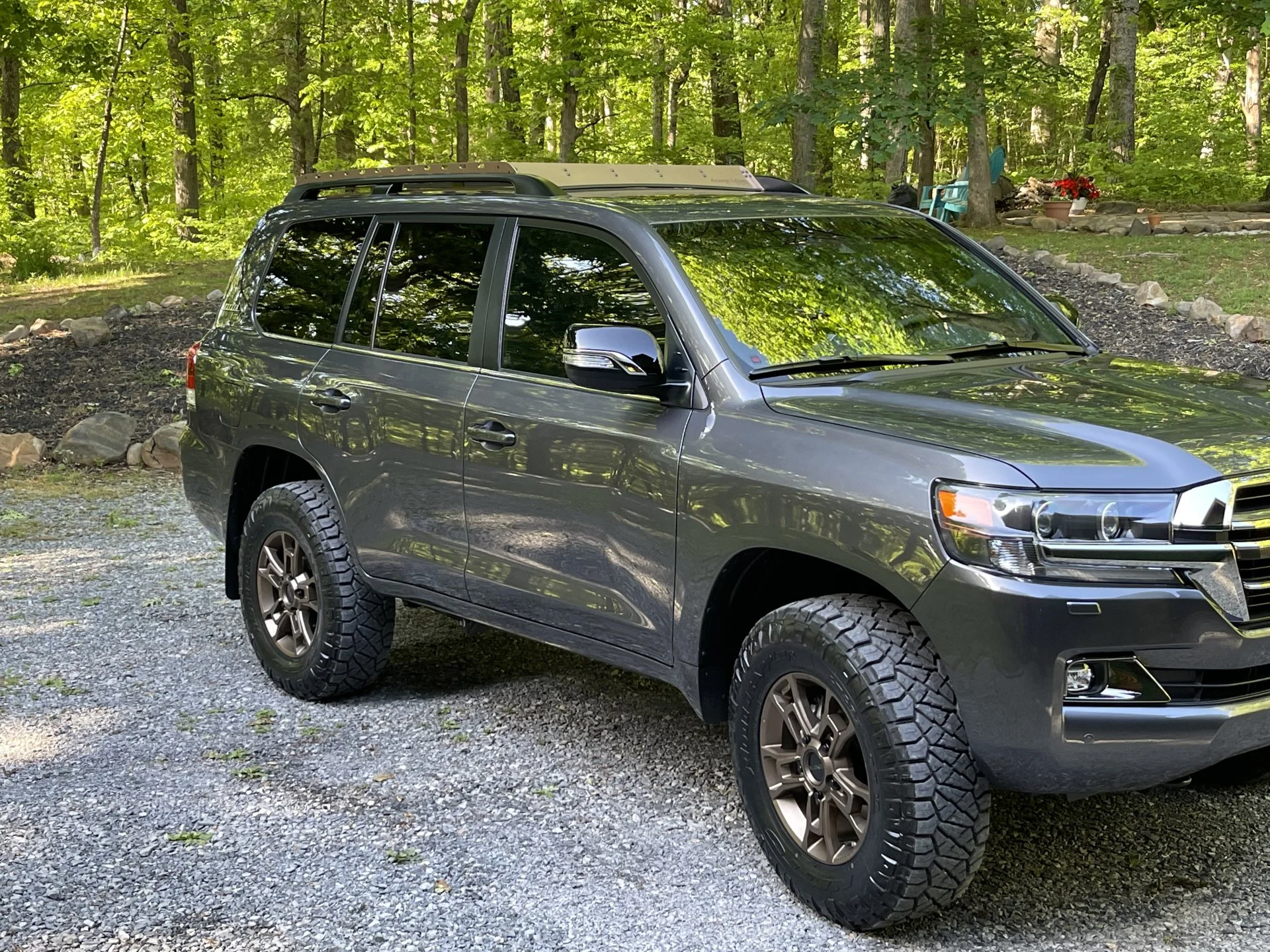

So I had the local Toyota dealership install my preload collar lift front and rear on my 21 LC heritage. Now I have what the tech calls a “dogleg” in the rear axel and it will not align correctly and tends to drift to the right passenger side. They told me to order an adjustable pad hard bar, which I have but yet to install (because if it doesn’t work I am sending back) may correct problem. Jeff at westcott said this would not correct my issue and he has never heard of this in all his lifts. The car stayed on a showroom floor til 12-4-21 and we now have 4000 miles on it. It was perfect before doing this. I put this on here hoping I could get some insight. Any help would be greatly appreciated

1. So you are running the Wescott lift without the rear coil spacer in that pic? Or is that pic with the rear spacer installed?
2. What size tires are those?
3. Are you running wheel spacers? If so, what width?
Thank you

It has rear in pic. I will post pic of without
Tires are 285/70 18 nitro ridge grappler
And yes 1.25 spacers

It is 1.5 higher on n rear without spacers installed in rear
