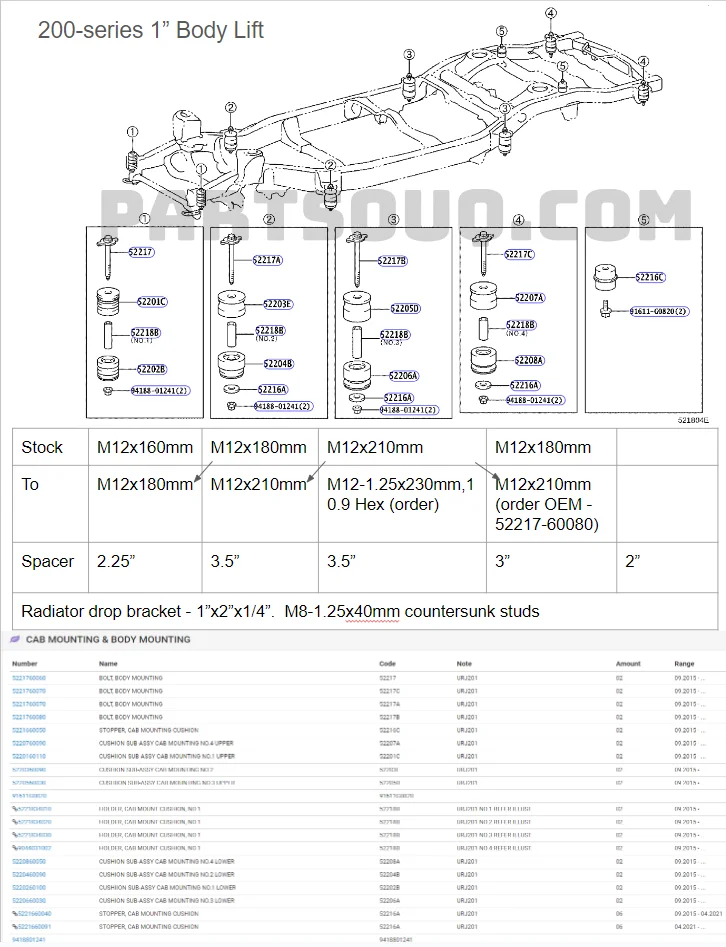

I am already running 37s. With the OME lift, there is just a bit too much rake. Do you know of a 200 body lift?
I don't know of a kit, but here's a great thread documenting body lifts. Some running tapered lifts @MTKID for his 40s that might be relevant for your setup.
I'm brainstorming on this too. Put together this cheat sheet for a square 1" lift with info distilled from that thread. Thanks to MTKID and @nwfl4runner for the details.
