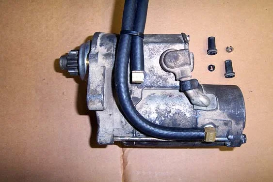

Chris,
Maybe a starter breather would have helped?
Bill
OOOH!
fancy! :D
I like it! did you have to tap the NPT holes?

Thanks Doug.
Ya, just 1/8" NPT. No big deal as long as you don't run the bit into something important.
Bill

Photoman, is there anything left on your truck that you have not modified in some way? :D What did you seal the starter with before the breathers?

Junk - Actually nothing. I had water on the hood (bow wave) and half way up the doors and never had a problem with the stock starter after that. It's just when I took the starter out for the contact replace I saw the little rubber factory breathers on there and decided what the hey, extend them. Probably fine for 99 percent of things but I figured if I ended up sitting in water for awhile it would make it's way in the starter and solenoid. Now probably if I end up sitting in water for awhile, it will still make it's way in the starter.
