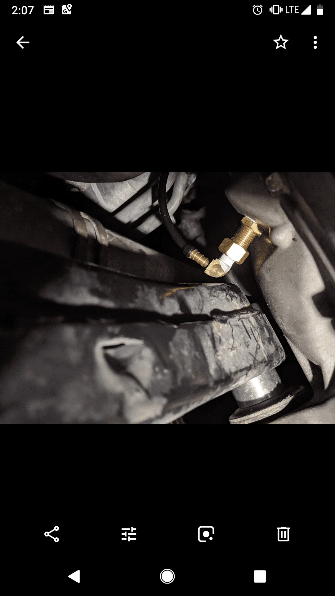

Have any of you guys that have installed the front locker noticed how close the brass air connections 90 degree elbow gets to the steering rack cross member below it? I have the slee diff drop, so of course that makes things tighter as well. I ordered the complete 3rd housing from nitro and I've got minimal space in there between the fitting and cross member. Nitro installed the fitting in the standard location used in the tjm instructions and the other installs I've seen. I'm worried it will make contact, especially in low range going in reverse, since the diff moves down on the front bushing when in reverse.
Edit: I have installed all new bushings and have torqued everything to factory specs.
You mean like this....I had to shave it down to give it more room
Yes, exactly! Have you had any contact issues after shaving it down? I really don't want to have to remove the diff again, so i'm hoping I can remove my front diff drop spacer and jack the diff up enough to get in there with a dremel.
No issues, that's exactly what I did, lifted it up enough to make adjustments. I was not about to remove that thing again.
Awesome, thanks!

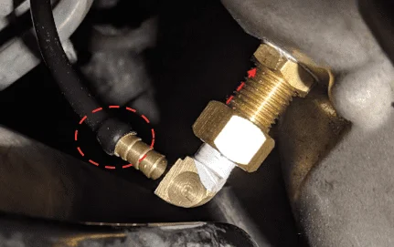

I would not be happy with that fitting if it arrived set up like that- with a little thought they could have used a shorter through fitting to maximize the clearance, and a nickel push to connect 90 degree elbow instead of the barbed fitting. That will eventually split or blow off at the most inopportune moment.
1920327
That actually was just in there for testing not the final product. The final product had a high pressure high temp rubber hose with a lock clamp around the fitting. The screw it self cannot be adjusted much at all, it doesn't have room on the inside either. Just enough room to work I guess..
I will be squeezing a rubber hose all the way on with clamp as well. I agree that there was no effort to optimize this for the 100 ifs vehicles.
