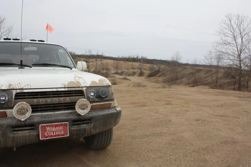

Well, I need them because I'll be on a voluntary Rescue service in rural Indiana, while I am at college, The "city" has VERY few Emergency personnel and even fewer EMT's/Paramedics. The way it works is that I am on call, and if the scene is closer to me than the station, I am going right to the scene in my personal vehicle using the jump bag provided to us. Also, in the winter, after heavy snows, going to the station would just take way too long.

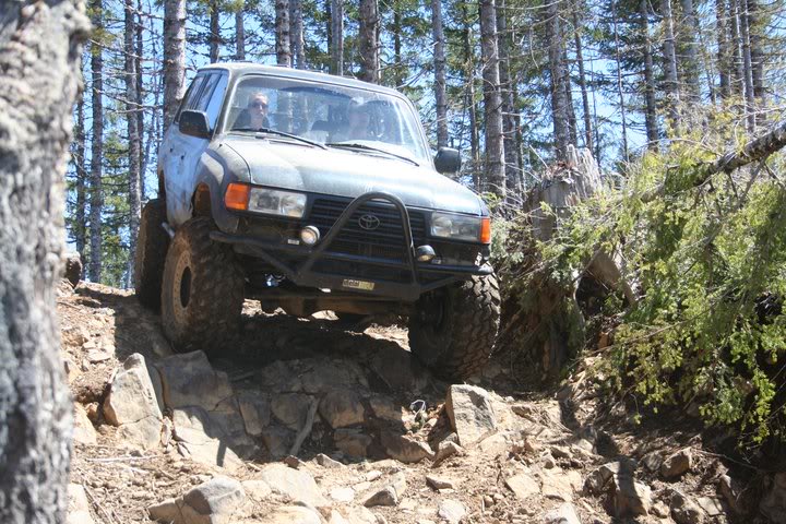

I put Whelen Hide A Way strobes in my rig 2 years ago. I found them online for 200 bucks with a 90W power supply and 6 strobe heads. I put them in the corner marker lights and tail lights. They have worked great for my application and they turn a lot of heads.
You never know when you need to be seen. I use my rig as a support rig to my snow removal business and doing roadside tree work so good visibility is a must! Also i was coming home from a friends house a few months ago at 4 am and was surprised to find a tree blocking my only way home, i had an additional peace of mind knowing i had quality strobe lights alerting drivers, something that 4 way flashers cant compare to.
