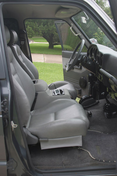

How are the seat?.. Change them out too!!! ;) 1000 miles a trip, you will thank me later!
Best mod I ever did on my old FJ62!

OOoh me likey the seats and console! DO TELL.
x2 Find seats that specifically fit your back. Get nice new ones. It will make the drive completely different.
