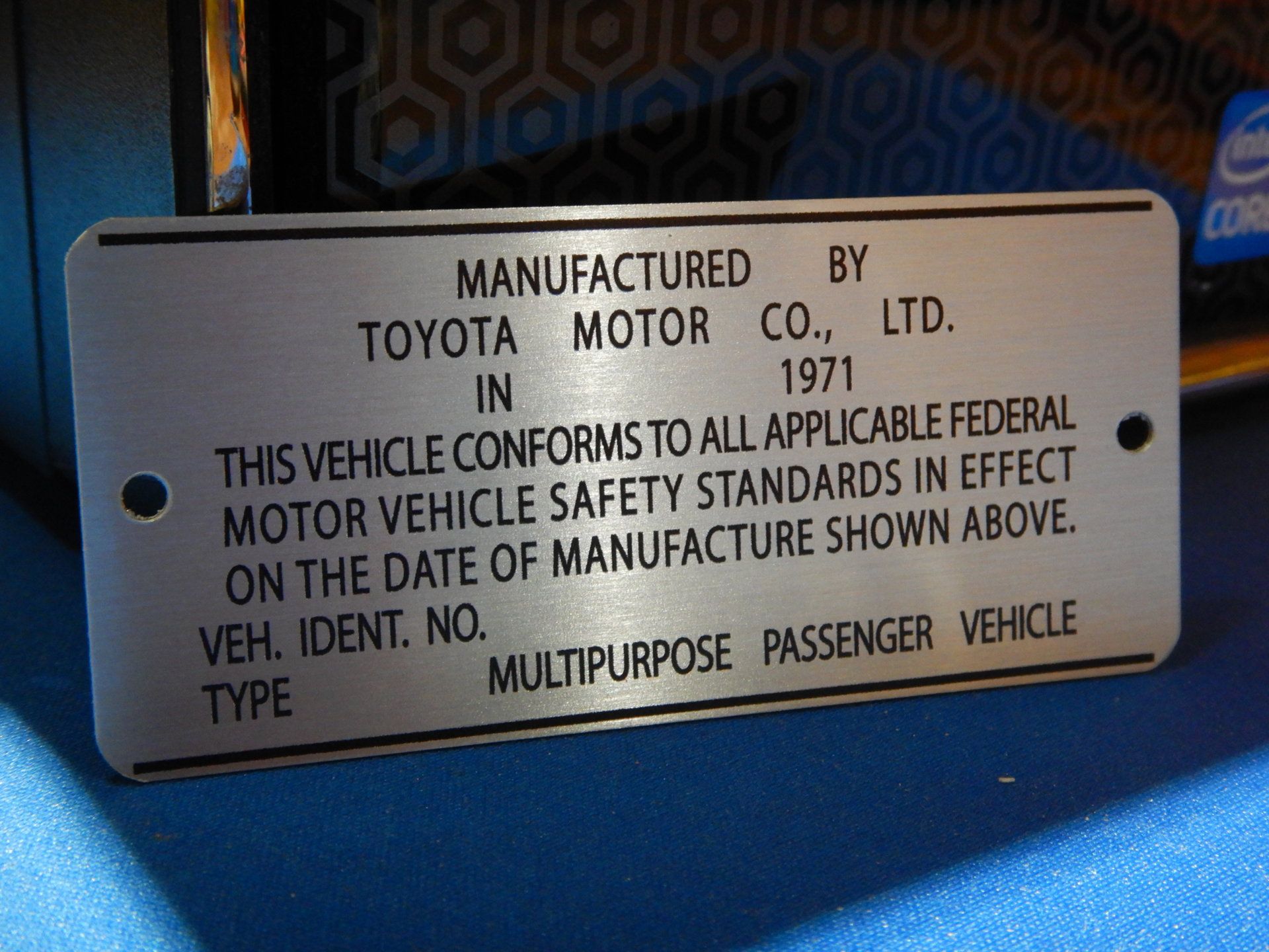

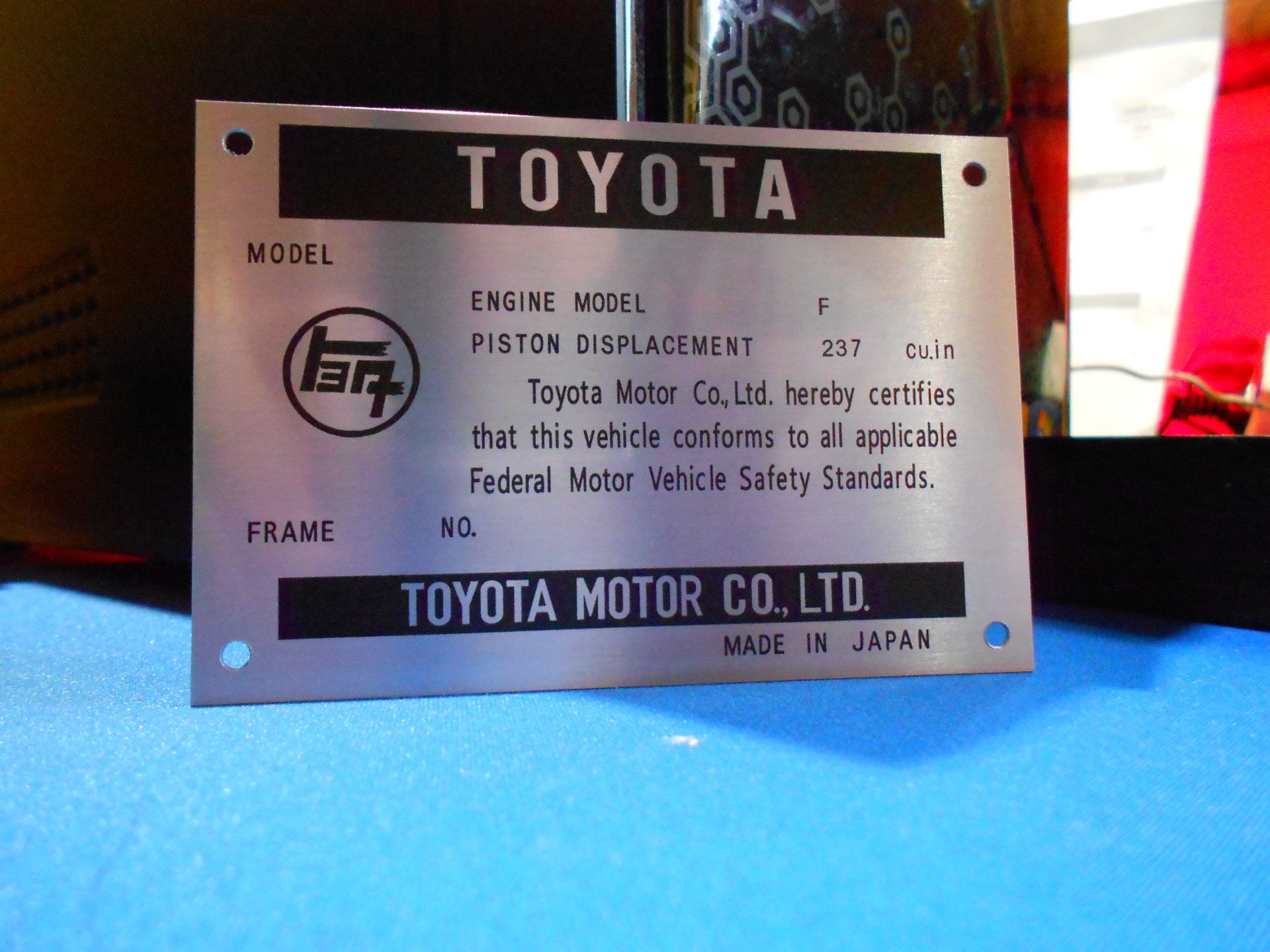

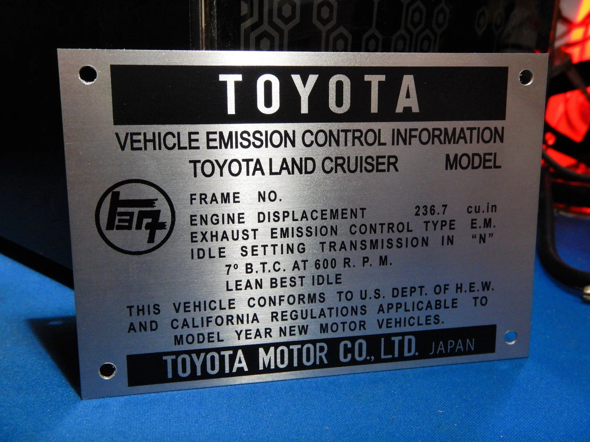

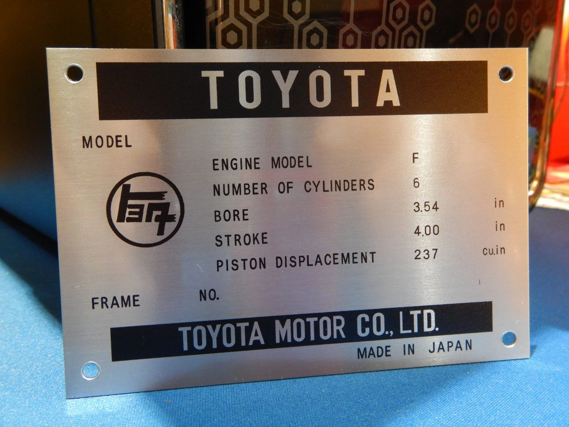

The average person , automotive safety Inspector , or insurance claims adjuster has no idea about the or locations of the Frame
# on the RH FT passenger side frame rail , That's a Toyota Thing , What they are looking for is the Drivers Side windshield VIN
17 digit strip tag , They did not start till 1981 , so Next
would be the A-Pillar / Drivers Door Jamb Aluminum Plate , if need be , Next they would pp the Hood and Look to
the RH Inner Fender or Firewall DATA ID Plate , Your 7/71 @sproggy would of had both ID plates originally , held in place by OEM-Type Rivets Or sheet metal screws
as long as u have both matching plates and a registration card & insurance u should be OK
Something like these :
DATA I.D. Plates Tags & Engraving Service

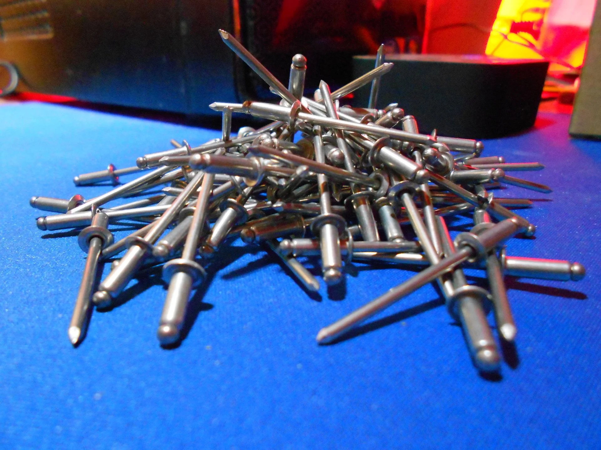

Seventeen digit VIN started with the 81 model on the FJ40. The extra digits we're only on the VIN plaques not stamped into the frame.
In 71 the under the hood VIN was attached to the passenger's fender and held on with sheet metal screws. Wasn't until the 78 model the under the hood plaque moved back to the firewall and for the first time pop rivots we're used. Until the mid sixties the under the hood plaque was on the firewall and machine screws and nuts were used. The A pillar started 3/69 in the US market and those always used pop rivots.
This has come up many times and everyone is correct so far. The frame number stamped into the front frame rail IS the VIN number. However, frames can rust out and it is almost always in the rear and under the body. The frame rails seem to survive better. That said , I have seen various tactics to be in state compliance. One is to take a donor frame and weld on the frame rails from the one to be registered. Another is to just use a good frame and just cut the square VIN stamp one from the other. As @RAGINGMATT said, body VIN tags are an easy thing to do using rivets. ( His plates are also very nice and I would put his in as they look better than new). The FJ40 seems to be in a grey area with all this compliance because it does not fit what most DMVs are used to.
