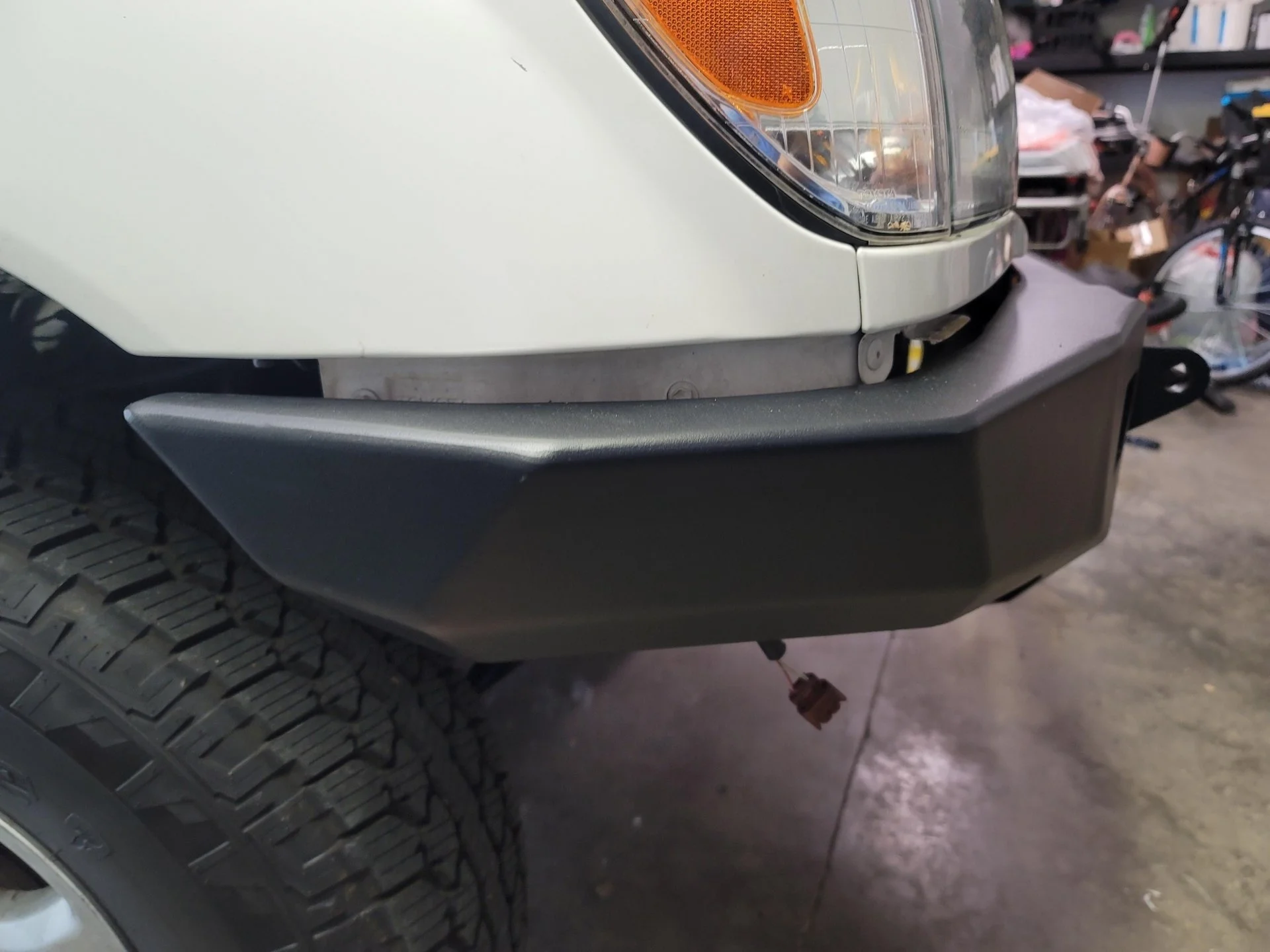

Those welds should be full penetration. I bet those pieces weren’t even beveled and it was a single root pass on the front.
To be fair, I think all you'd need on a 1/4" butt weld is one pass. But hey, what do I know... I'm just a certified online weld inspector.

Not entirely true, when asked about metal thickness, victory replies with "that's what the steel mill has been sending us for 20 years". Not anywhere on the detail they present here.
$500 shipping, more like I paid $250 shipping, or maybe they forgot that
Mentioning bolts, now they say "we are a relatively low volume manufacturer", why they mention "OE" we know they are not OE, come on man, that is nothing but lip service
Install video? they state "100 specific install video" then "used a universal video" WHAT?
Who/what company puts a picture of a "prototype", and then uses this as there flag ship model to sell
They say " added more room for flex offroad" I would think with the body and fenders and such bolted to the frame, and the bumper bolted to the frame, if there were enough flex to cause the bumper to hit the fenders/grill, then there is probably some serious structural issues / rust on the frame.
They keep mentioning a return, you know, I just want want I ordered and paid for nearly 4 months ago, Taking the easy way out by offering a return over and over, doesn't sell.
The entire body flexes at the body mount bushings. This is why ARB, etc., specify in their install instructions to leave a minimum of 1/2” gap between the top of the bumper and the bottom of fenders, grill, etc.
