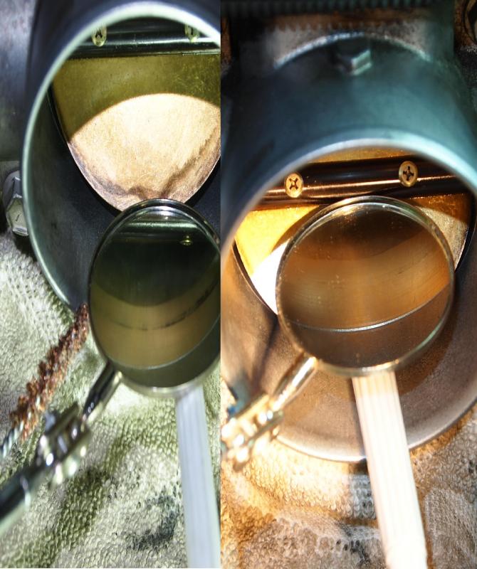

I just cleaned the throttle bodies on both my 1997 LX and 2007 LX. Both were vibrating and dropping idle when in drive or reverse with the brake on. The newer one had a dirtier throttle body, but it was a lot easier to clean.
Now they both run better and don't vibrate. They also don't drop to 600 rpm when sitting in drive or reverse...more like 750. Their park and neutral idle seems to be the same as before at about 800.
I saw a picture once showing that if you shine a flashlight in the throttle body,a little bit light should go through other side around the throttle (like a solar eclipse), which means when idling with the throttle closed, a little bit of air should be coming through. So, it makes sense that if it's dirty at idle, less air is coming through than should be, and therefore, the idle drops below the ideal level and things start vibrating.
This is my take at least. I guarantee, if I had taken this to Lexus, they would have started looking for things that were vibrating and still not fixed it after charging me a lot. I am convinced the things that were vibrating were just symptoms of the problem and that the dirty throttle bodies were the issue.

44K seem to have given me the best results, along with Tb cleaning. Old gun barrel cleaning brush helpful in cleaning throat & rim of valve. A drop of 3M oil on TB valve axle ends worked in then wipe down with solvent is a good idea to finish up.
I believe getting out that last little bit of vibration (so far so good) was something I learned while helping a member recently: Disconnect battery post for 30 minutes while cleaning MAF meter along with cleaning & greasing battery post. This reset ECM/ECU which may have adjusted to the impeded fuel/air system mixture over time. Plus a number of FSM test state check battery first, a drop in voltage may impede any number of systems.

Cleaned the air induction system including the throttle body, 90% of vibration gone. I'm going to put this on my list to continue to clean every 120k miles ;)
