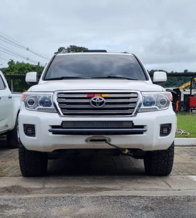

Hi All
I am considering doing the IFS swap on my Diesel 200. I am concerned with the front spring rate # and front shock valving. The reason for this is that the 3UR 5.7 gas engine weighs around 485 lbs. while the 1VD 4.5 diesel weighs in a whopping 822 lbs.
Current Setup
Stock IFS
Front - OME HD Springs/shocks (they came with the used truck, I don´t have the part numbers)
Rear - OME Std shocks
Wheels - Tundra 20" wheels +60mm offset
Wheel Spacers - Spidetrax 1.25" spacers
Tires - 305/55 R20 Falken Wildpeak ATW3
Front end - Has 10K Smittybilt winch (hidden) + 1" DOM light bar
I have some minimal rub with this setup, I feel she needs some UCA´s to get her road manners back. Stiff front spings.
Intended Setup
Tundra IFS
(UCA´s, LCA´s, inner/outer tie rods, axles)
Front Springs - Coilover below come with springs, I would have to swap them out for higher spring rate?
Front Coilover - Eibach Pro 2.0 Coilovers
Rear Spring- 200 Series Eibach 1" lift
Rear Shock - 200 Series Eibach 1" lift shock
Wheel Spacers - Spidetrax 1.25" spacers, would run only rear with Tundra IFS
Let me know what you guys think, I am looking for on road comfort with occasional offroad use. I live in Panama and we have a mix of good roads and crappy washboard roads.
