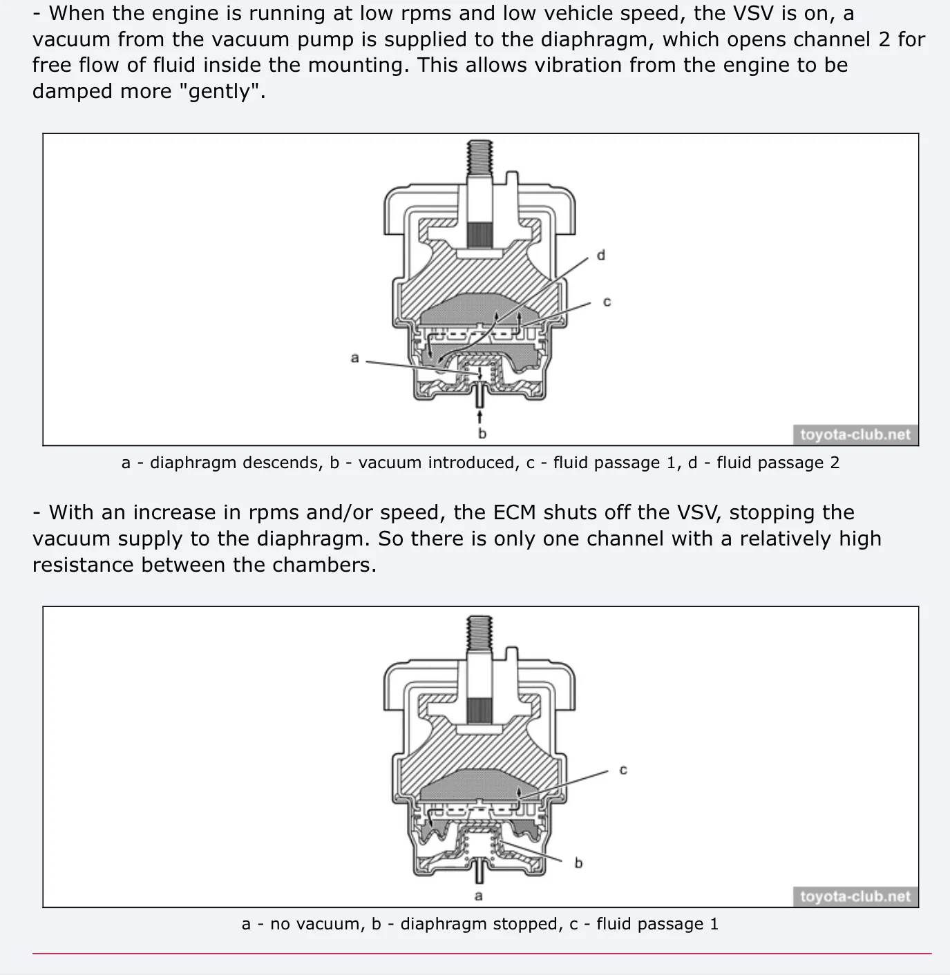

Here are the vacuum mounts.
That’s a more clever design than I had imagined. Thanks as usual bjowett
The mounts will be more rigid when installed in your vehicle. They need vacuum applied to soften.
Thank you. That’s very useful information.
