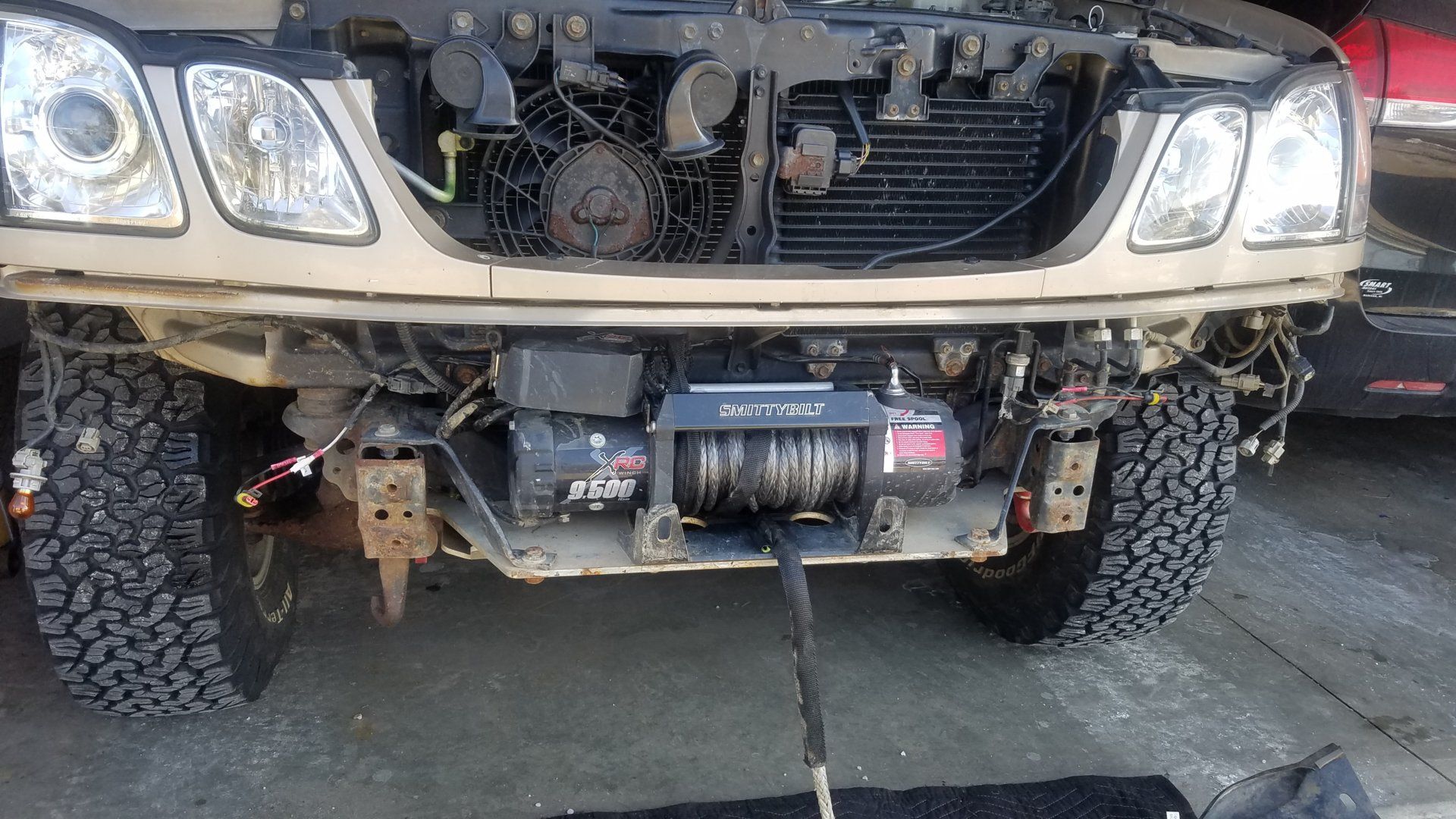

I used it for a while after I bought it from another member here used. It was pretty solid for a couple of times my heavy ass truck was stuck behind a big rock going up a slope. Here's how it was mounted:

Debunked? How?
In my phone conversation with TJM they said this plate was not designed to be used standalone; The fairlead mounting tabs are intended to be supported by a metal bumper. The fairlead can obviously be left unsupported, but that's up to the individual.
Both the Trail Tailor and Asfir mounts have welded gussets on the underside to provide additional fairlead support, and may be made from thicker plate in general.
