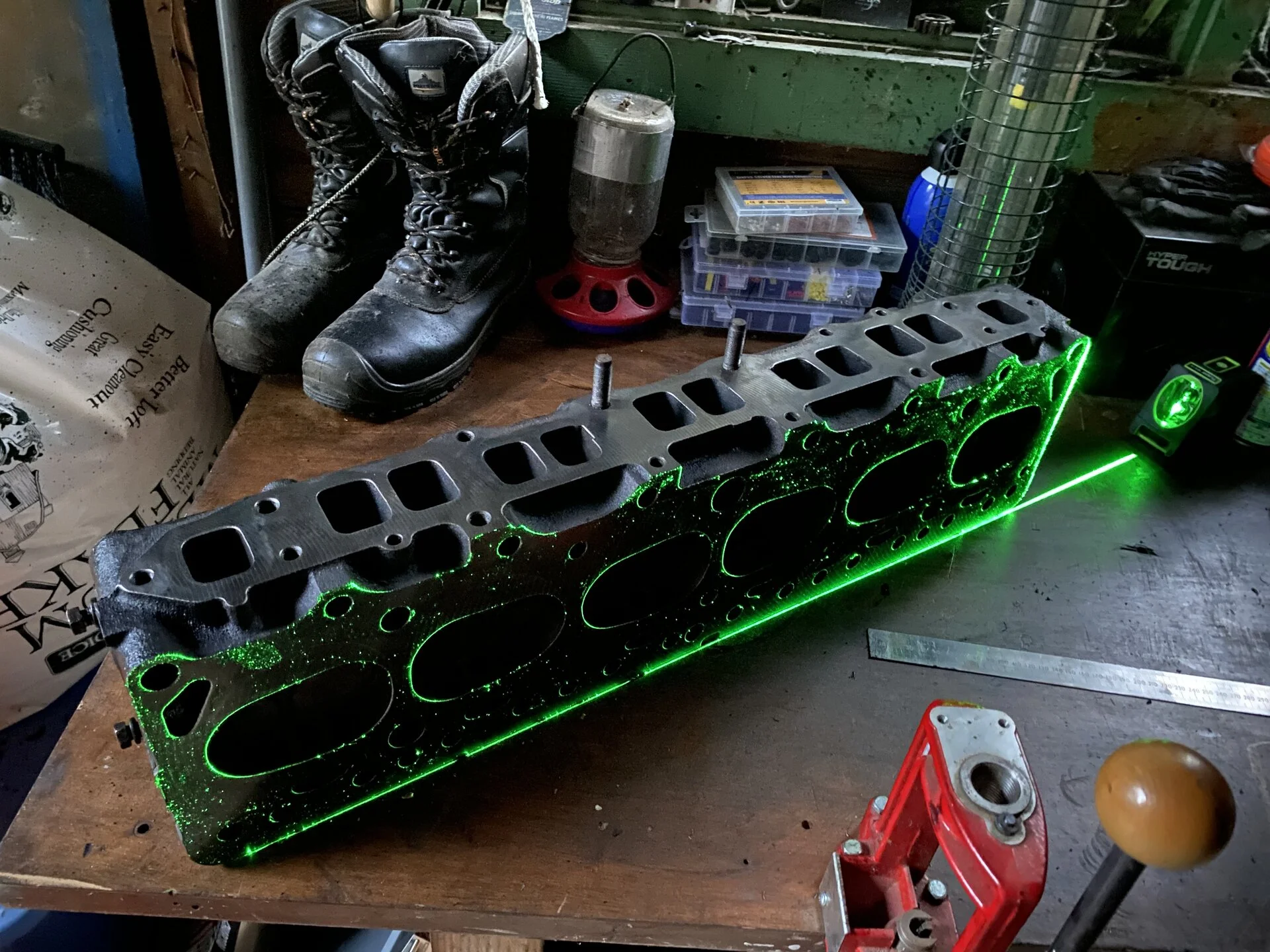

Using a laser to check if a cylinder head is flat - any reason why this wouldn't work?

If you can position it such that the whole surface of is illuminated with no parts in shadow, then wouldn't that mean you have a reasonably flat surface?
seems somewhat reasonable but can you guarantee you aren't at a slight angle pointing in toward the far end of the cylinder?
I'd like to see the same laser on a freshly machined head.
ALSO, if you're going table top laser level/flat gauge, maybe just give it one of those glass table top/sand paper flatting jobs to be safe
Don’t use sandpaper and glass. I tried that and had to stop because the glass was warping just enough to follow the warpage of the cast iron. I used 5/8” tempered shower glass and it still had too much movement. Just go to a machine shop. It’s nice to know how much material was removed and you can’t know that using sandpaper.
If you’re in the middle of Sub Sahara Africa and you have no options then sandpaper would be your best bet, however, if you can get to a machine shop that’s what you should do even if you have to wait or take a trip to the next town.
