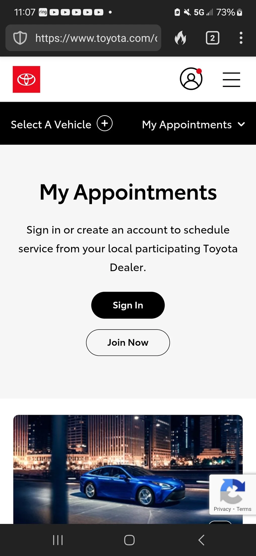

Create an account on toyota's owners website and plug its' VIN in to verify the service history. If the tranny and coolant have been changed at a toyota dealer it should be listed. These services sometimes don't populate on a carfax.

I tried doing the same process for another one but Toyota website didn't show anything, am I doing something wrong? Should I be using the Toyota website, logging in as an owner and then adding the VIN? Trying to look up this VIN, JTMCY7AJ8H4051949.

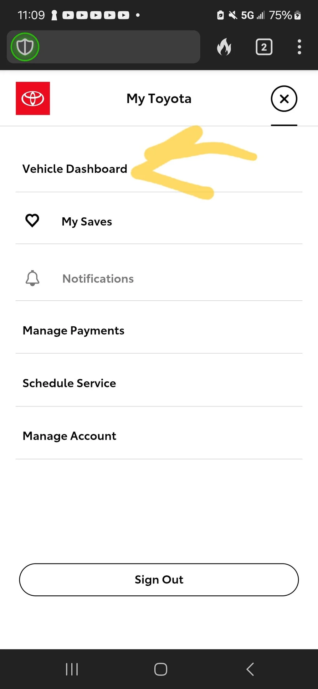

After logging in and inputting the VIN go to the vehicle's dashboard and you'll be able to select the service history.

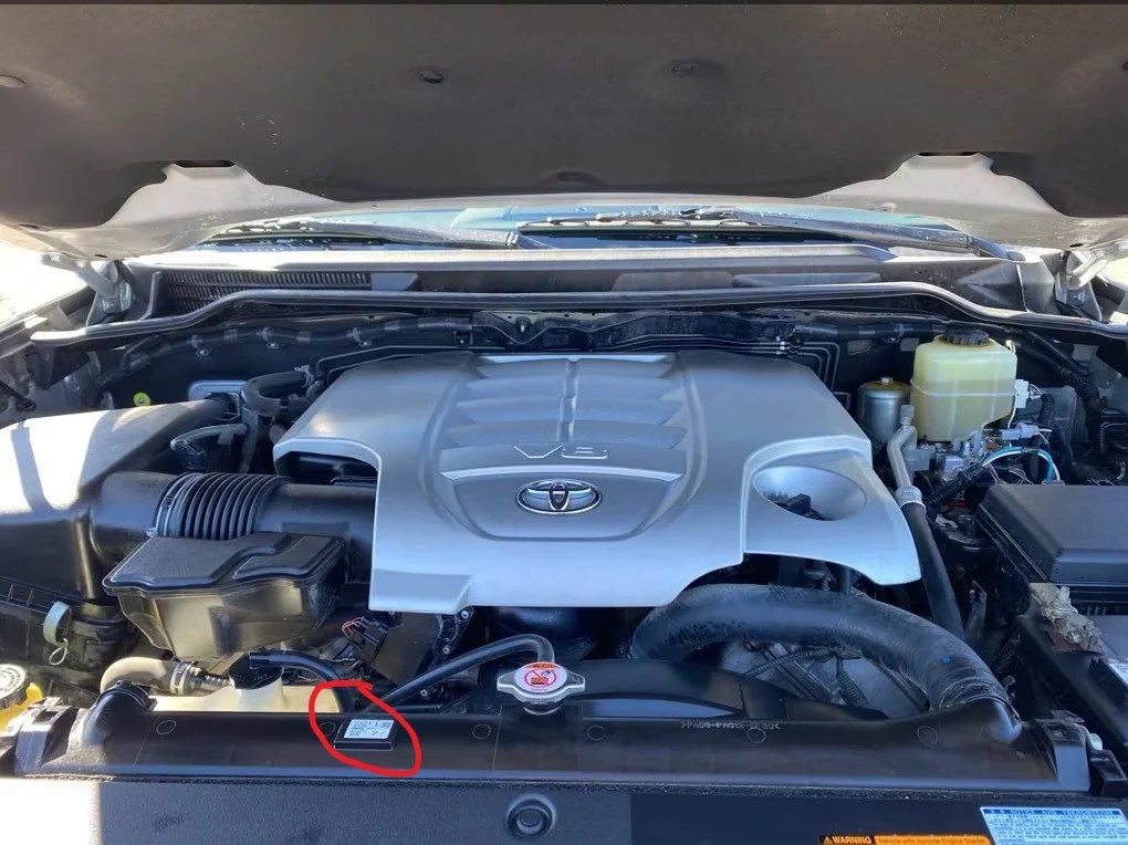

Original radiator so you know it wasn't ruptured and engine overheated, just put it on the list of things to do.

Can someone expand on the radiator some more. Is it standard to just replace these at a certain mileage? Or is there a known issue people are trying to avoid?

Pre 18's like to usually start leaking at the "tag"/"badge"/"label" on the top of the rad. This one shows no signs of leaks so I wouldn't be worried. Put it in the back of your head for a rad eventually.
