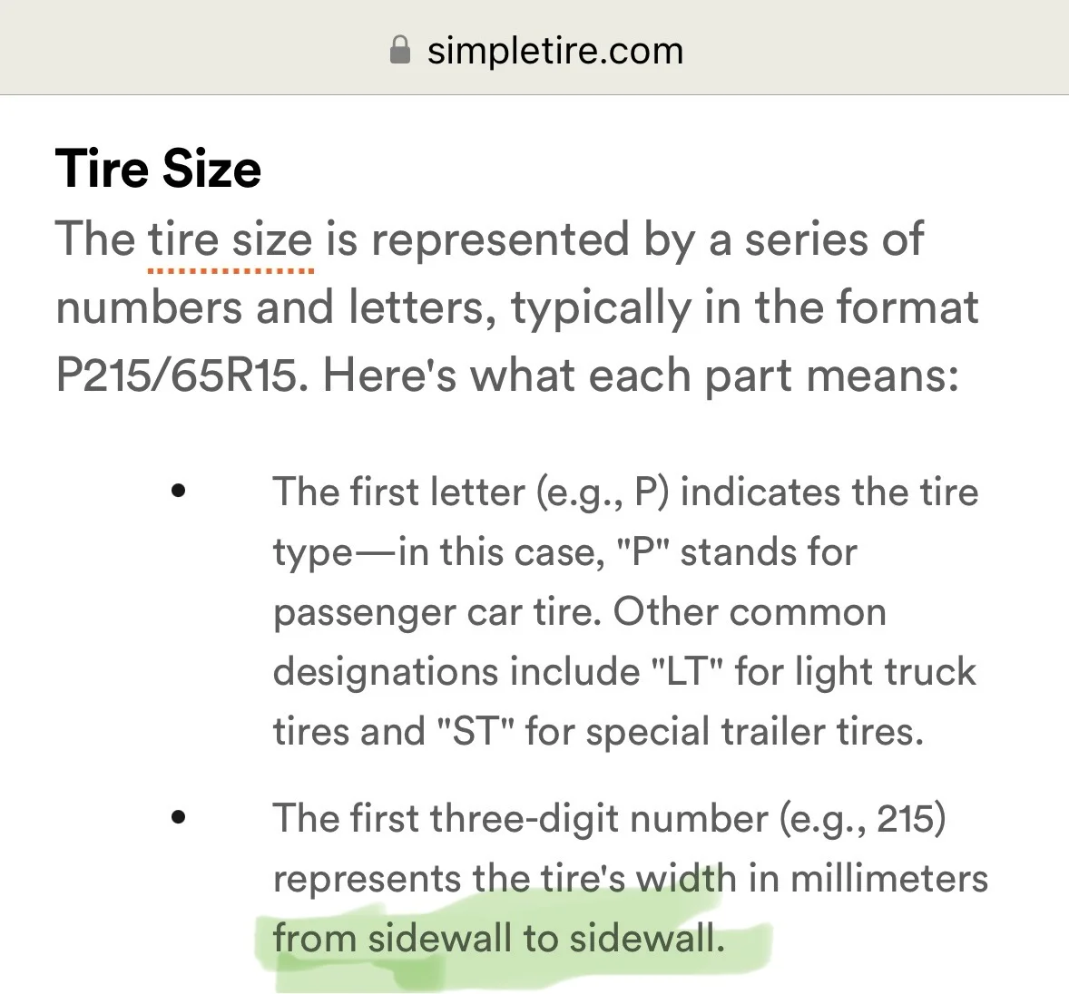

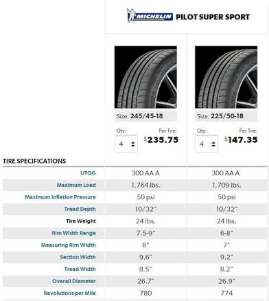

Some manufacturers list both the section width and tread width in their specifications.
Take a look at the first tire on the left.
245mm is 9.6 inches. Which spec is closer to 9.6”?
I took this from your link:
Ok, I can see I misinterpreted what you were saying originally, and learned section width is a thing.
