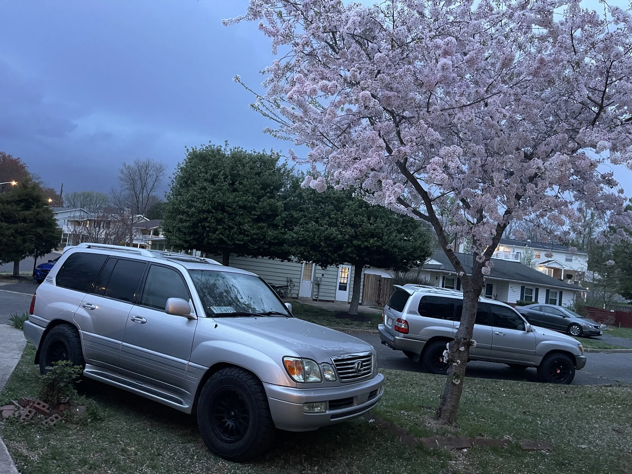

My LX is my daily/baby hauler and it’s on 275/70/18 grabber ATX SL. That couples with AHC makes driving a dream. My offroad vehicle is the LC, on regular shocks/springs running D rated tires. It doesn’t ride bad but nowhere near how smooth the LX is. My kid sleeps soundly in the LX but in the LC he wakes up when we hit a bump
