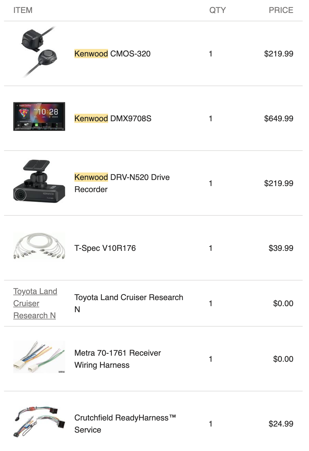

Here is what I initially purchased and installed:
