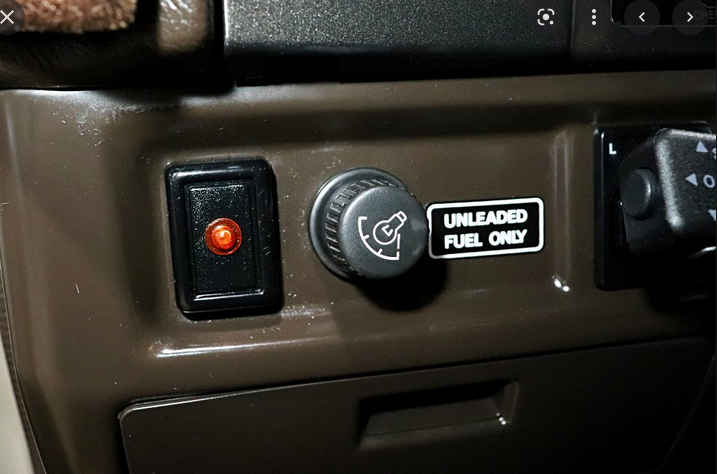

do you know there is a rheostat to the left of the steering wheel that controls the brightness of the bulbs? I'm sure upgradiing to LED bulbs is nice but you should make sure the rheostat is working properly too. The LED dome light upgrade is great, but frankly I've never had any problem with the instrument lights being too dim.
I stole this pic from a google search:
My dimmer still works normally. I'll say for my 62 the upgrade to LED was well worth it. Gauges were previously candle-lit.
Yes, I have it cranked all the way up and it’s still very dim.

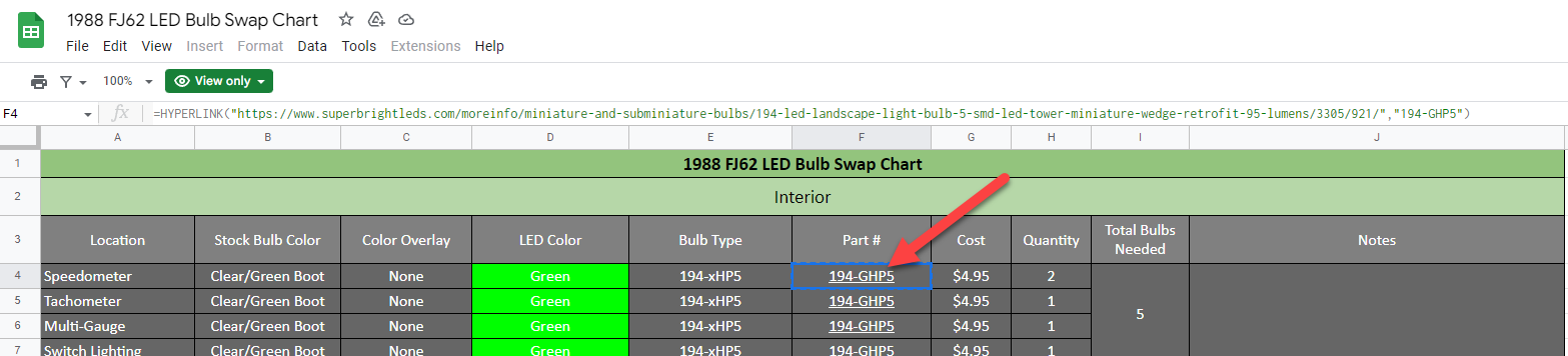

I must be an idiot, but I can’t match up the led part number on the 1988 FJ62 bulb swap chart with the part numbers on superbrightleds.com. Also, I found the search by vehicle tool but it didn’t pull up very many options either.
The Part # column on the spreadsheet is a link to the product page in most cases. If that doesn't help feel free to message me.
