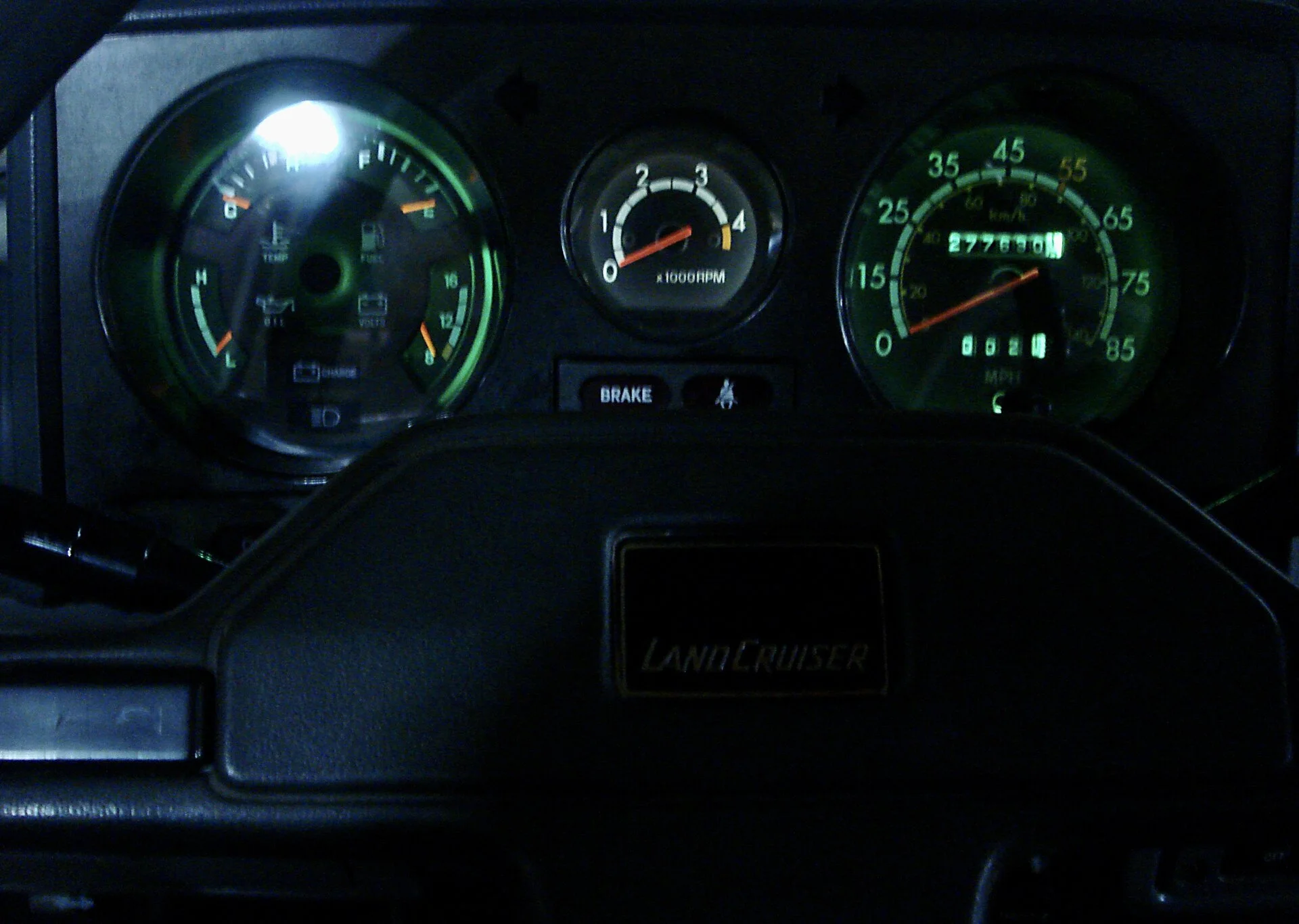

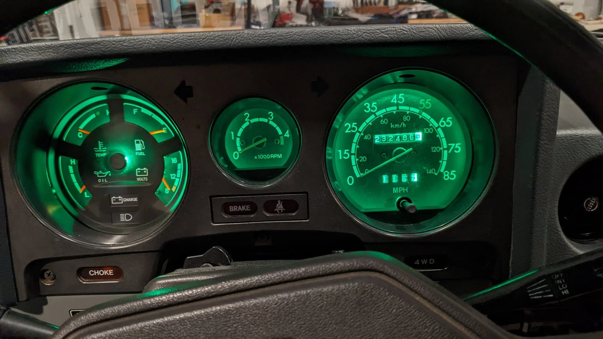

This is the color and intensity of the lights bought on Amazon linked above with the original condoms on. Since the bulbs are rated 6000k you get a more blue look to them. I like the color. if you found a similar shape with a lower color temp rating it would be more green. This is with the dimmer all the way updo you have a picture of how these LEDs look in the dash. I just ordered the above list from Superbrightled but I’m interested in a less intense look, too.

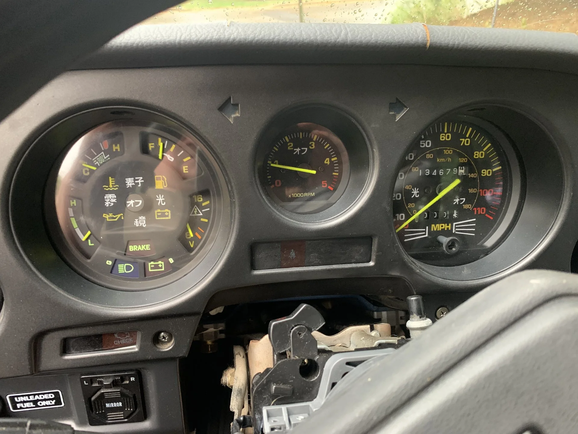

So you are swapping the plastic face plate/panel and putting your gauges into it first? To swap lights you'll want to remove the AC bezel panel on lower middle as well as the gauge cluster. These all just require a screwdriver to remove. Most of the lights just require you to turn the housing to remove it them swap the bulb. The most difficult part of this is getting the speedo cable disconnected so the gauge cluster comes out enough to access it all.Ok, I got the replacement cluster panel. It looks like I can replace that panel without disrupting the gages themselves. I’m worried about getting in over my head. How involved or technically difficult is it to remove gauges and swap the bulbs?

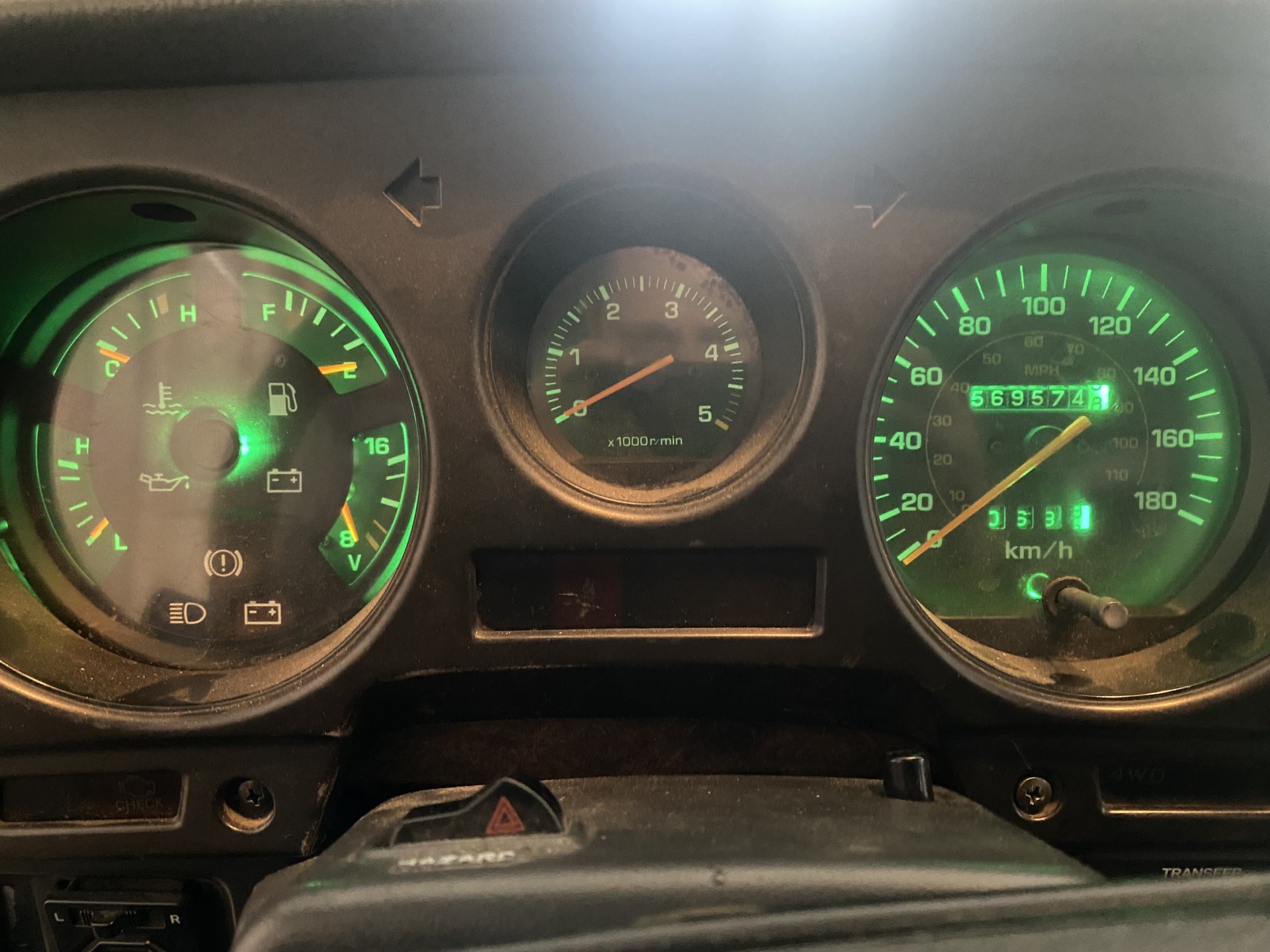

Was this pack enough to replace all the bulbs for the instrument cluster?I found some white LEDs that are the same dimensions as the OG incandescent bulbs. This allowed me to use the original green condoms to create a dimmer look and closer to original color. They will dim and the original covers tame that bright LED look that just floods the gauges with light.
