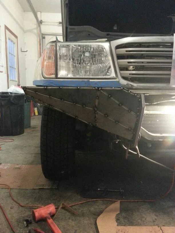

Click pic for link to final wing mock up video. Let me know what your thoughts are guys. Thank you.
How do you feel about the AC condenser being exposed like that, assuming the other side will be symmetrical to your mock-up piece?
I think it looks badass. But I share duggy's concern for certain front bits. Would there be an integrated skid plate, or perhaps an add on skid plate for protection?
It wont be fellas. Check for latest vid. Getting ready to start welding!

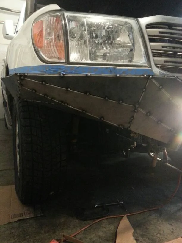

What say you?
It comes out pretty far past the fender flare and is a hard corner. I don't know about anyone else, but i think it should be a little more round unless you intend on incorporating a slider/rail on there. Just my 2 cents.
I think the dimensional idea is cool but why keep the flat top? Actually that is a beef I have with all but Slee's front bumper! He's the only one who got rid of the flat top! And you still can add a grill guard to it if wanted!
There needs to be space for the bull bars. The bumper only sticks past the fender 1" and the corner is only out about 3".. not much really. The camera always seems distort what your trying to show.
Ya I hear ya... this is enough welding and work lol do you see all the welds :bang: what did I do??? Lots of beads but wait till I blend it all on the outside and you see the beads I'm laying inside. Best I've done thus far. More pics coming.
