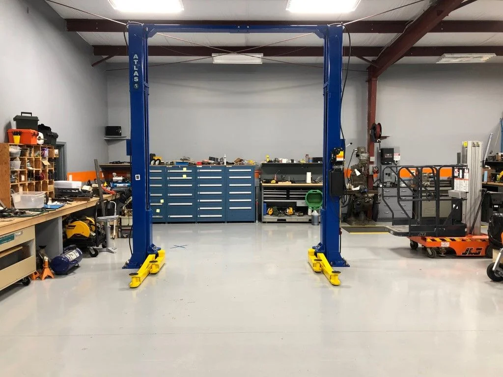

Atlas 10,000 lbs. Bought at least 10yrs ago from Greg Smith but could never find a place in my old shop where both posts would be on thick enough concrete. And shop really wasn't tall enough but probably could have made it work. Lessons learned - go taller than you think you'll need and be there when your shop is being built.

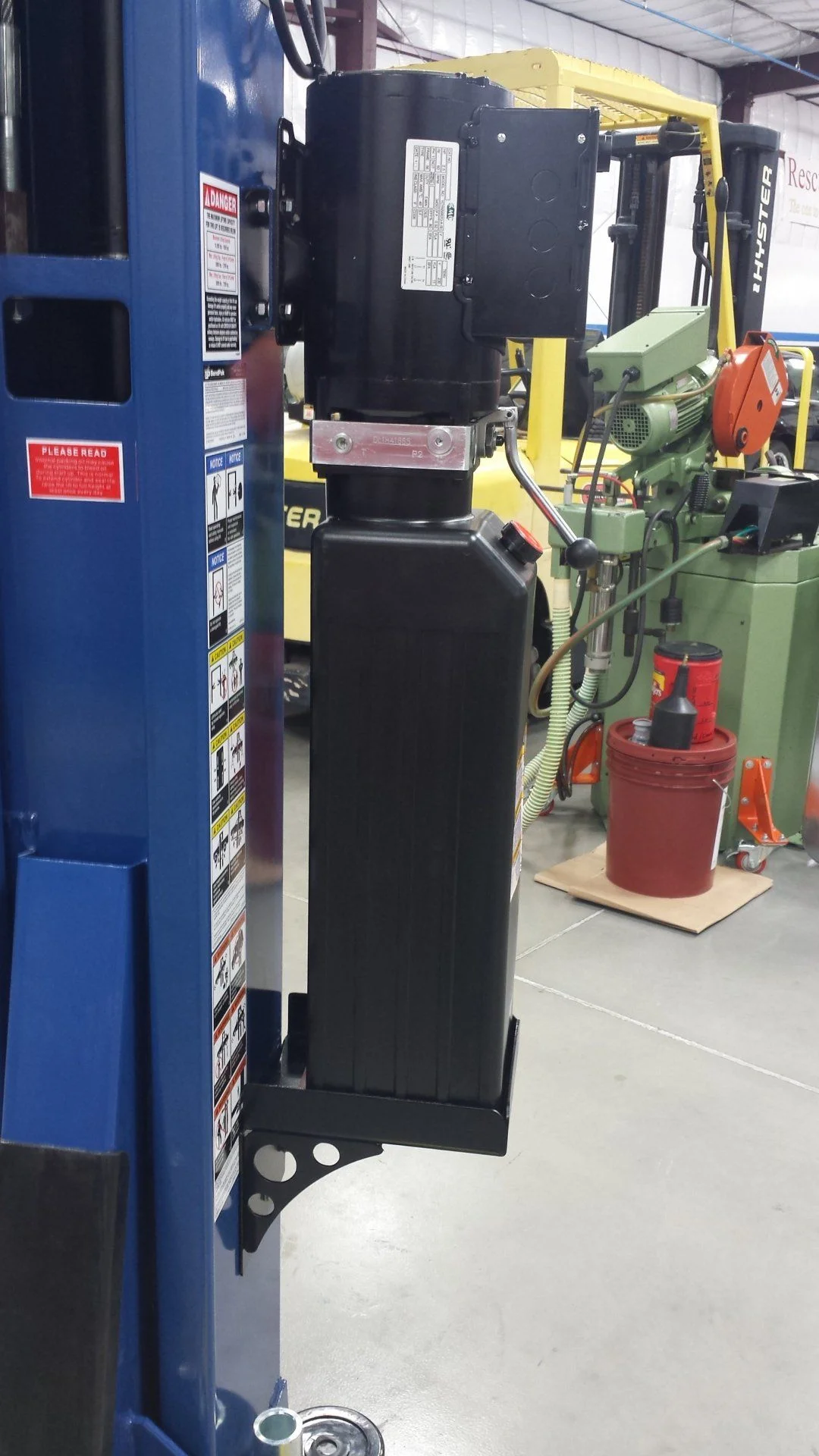

On the reservoir support. Three sides are broken and a piece of rubber mat provides insulation between the bracket and thin plastic reservoir.
Nice shop. I need that Hyster! Let my old standup lift go with sale of old place. Was old/worn out but worked well enough for what I needed. Haven't had any success finding decent replacement for decent price.

And I like the reservoir support idea. Hadn't thought about that.

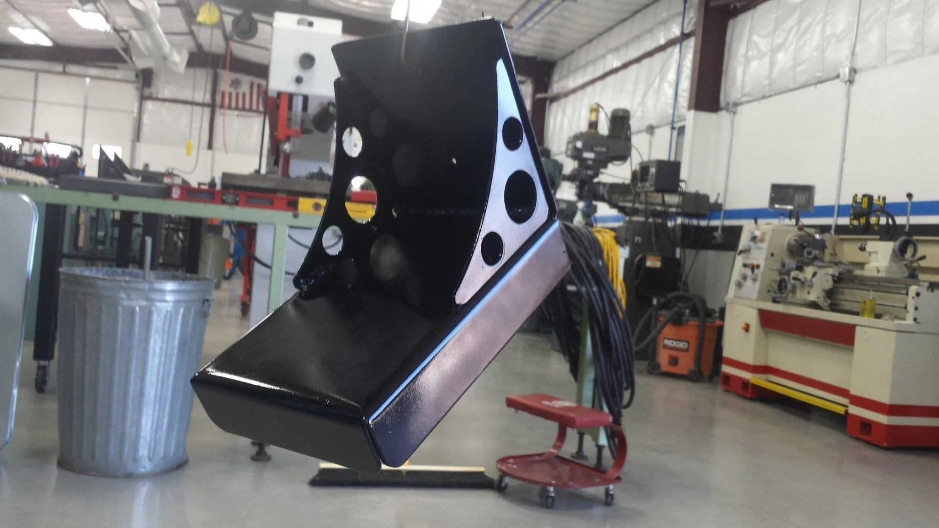

if you want measurements on the reservoir support, say the word.

Like the idea of the round feet, had already thought about something like that. And thanks for offer on support dimensions but I can come up with something. Yours reminded me of an ammo can holder and that gave me some ideas.

On the reservoir support, I used #10 tek-screws to secure the bracket to the post. If you look between the post and the actual arm assembly you'll see a clearance (gap) to select a safe length.

BTW, i meant to pay you a compliment on your beautiful work space. I was especially admiring your Vidmar cabinets.

Thanks, I thought it looked like something was missing.
I've already mounted a couple of hangers on the lift posts and the steel is thick enough to thread for short machine screws. 50cal ammo can holder is 3/4" too narrow for support. Thought that might make for a simple/interesting solution.
Took me 6mo of ebay searching to find some Vidmar cabinets that were relatively close (without going to Atlanta) and weren't absurdly expensive. No more Atlanta driving for me and that's still $2400 worth of used cabinets!
