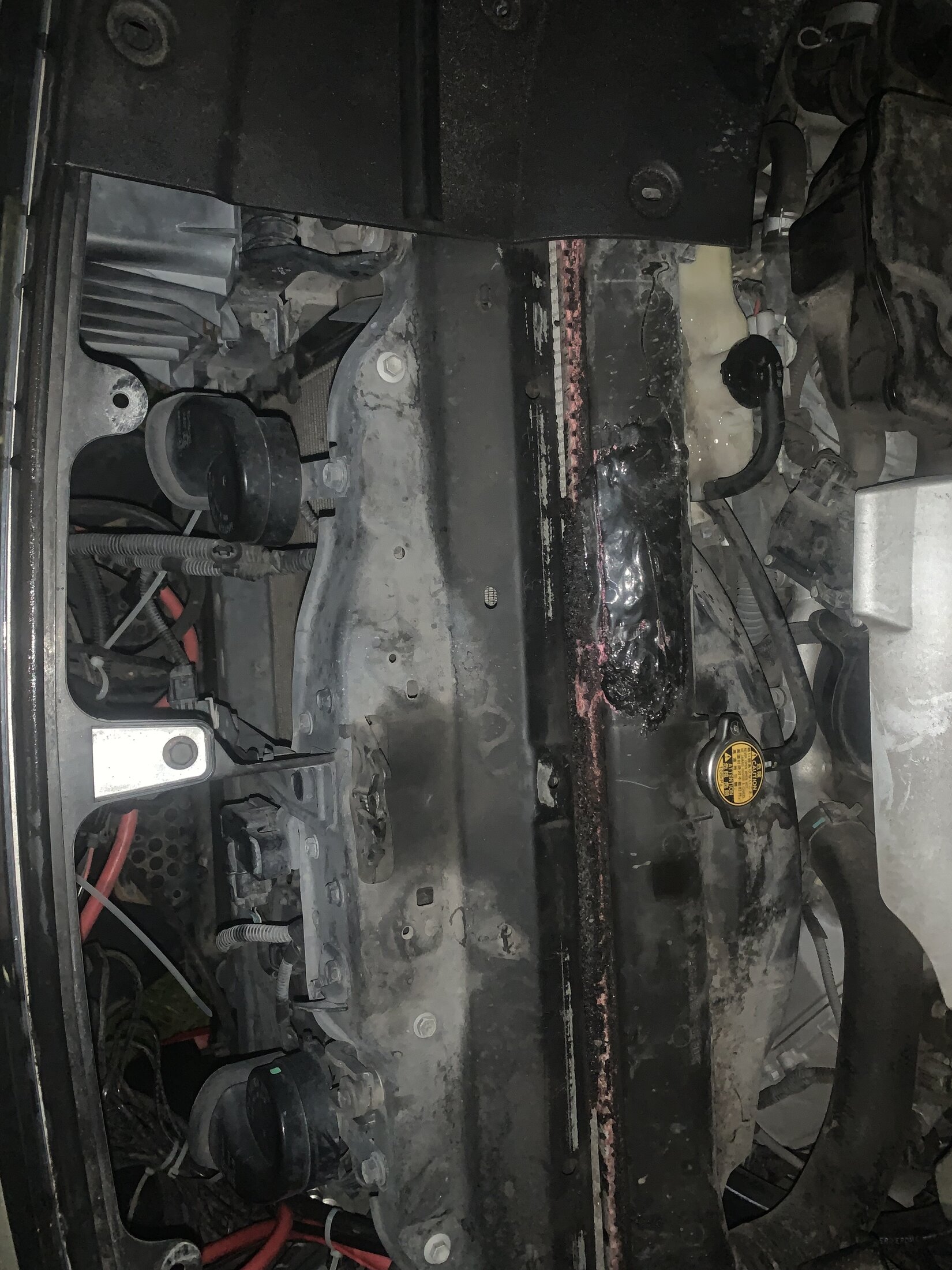

Pre emptive jb weld Radiator repair lasted something like 20k miles (don’t remember when on the 80k range I put it in) and maybe 4 years…the white witness mark was present so I used the jb weld patch so that if it blew maybe the radiator patch would hold it in…or perhaps the patch would strengthen the radiator enough to keep it from blowing.
After a couple hour road road trip yesterday, I got home and checked coolant to find that I’d lost 8-12 oz of coolant (radiator still full, little low expansion tank) and pink coolant around my patch.
I don’t know how the cracks in the radiator usually give out, but it appears perhaps my patch job made this a “not catastrophic” event. I actually periodically checked my temp gauge yesterday and it was always fine.
Time to take advantage of the parts sale currently going on.
