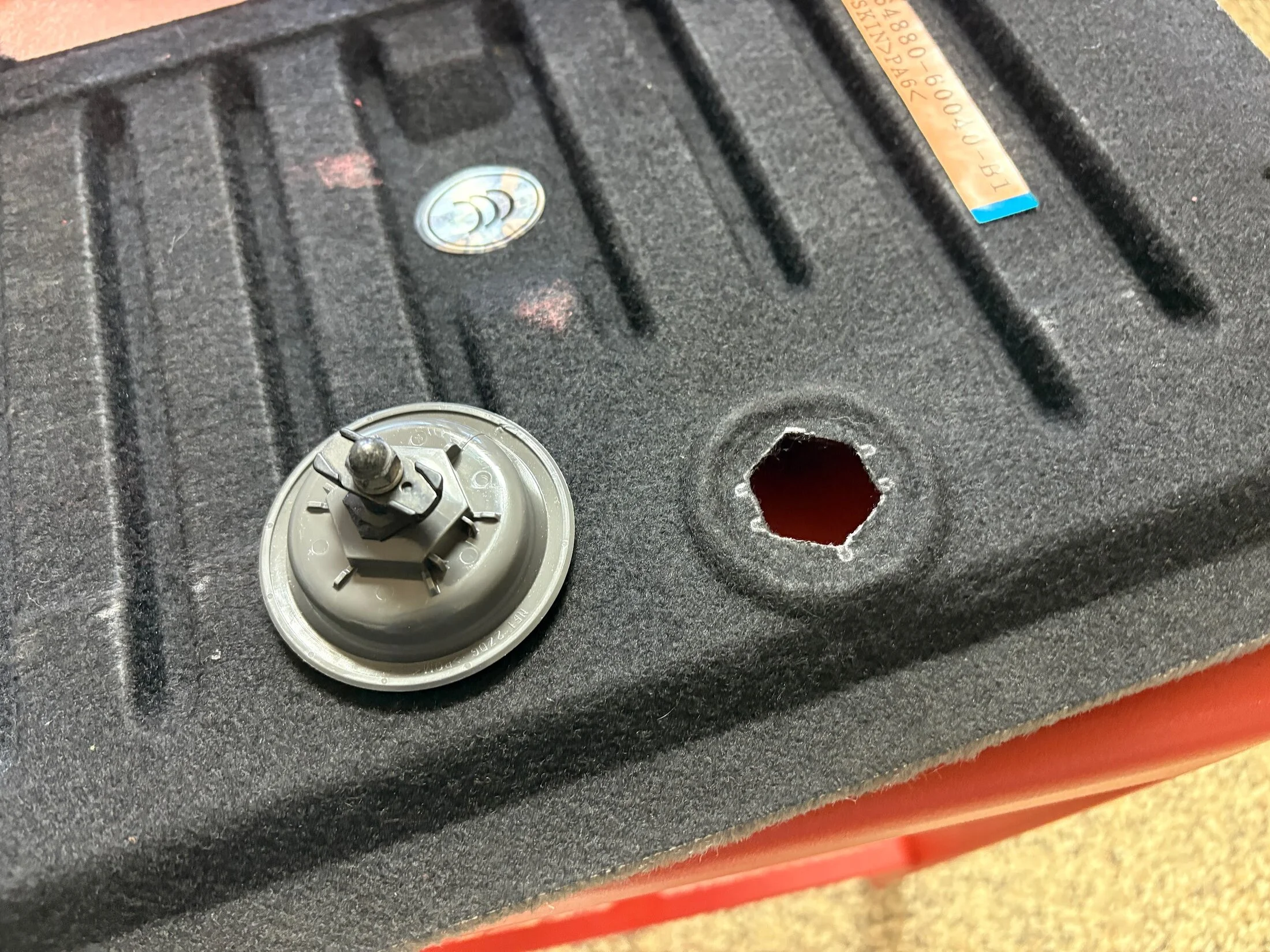

So one of the rotary latches in the storage cover panel in the tailgate disintegrated :(
Turns out the part is not available separately and the whole cover ($115 from partsoq or cool ~$230 from a U.S. dealer) needs to be bought (and is not in stock).
Does not seem to be easily repairable, maybe combination of some big and small washers could do the trick, need to play with it.
Did anyone encounter this and solved somehow? Or maybe someone has a cover laying around unused? :)
I guess I was alone with this issue. Finally got around to fixing it. A fender washer plus shaving of the broken plastic piece did the trick.
