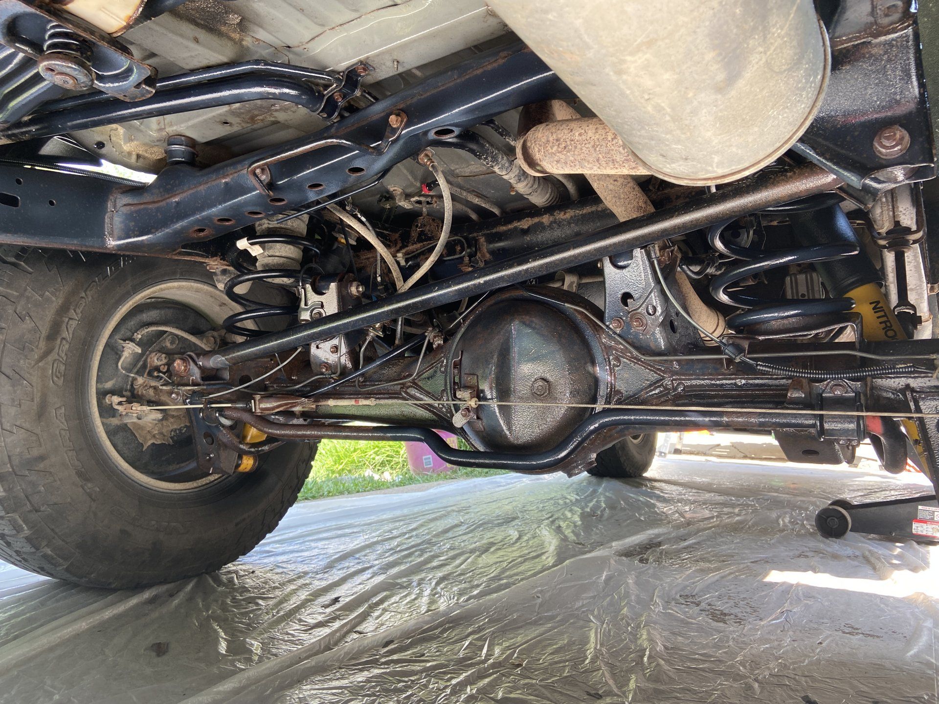

Shown below are two pics of my 100 getting the treatment and 1 of the 80 after a year of normal use, with several trips off pavement. It “collects”from the road and that helps thicken it up.
