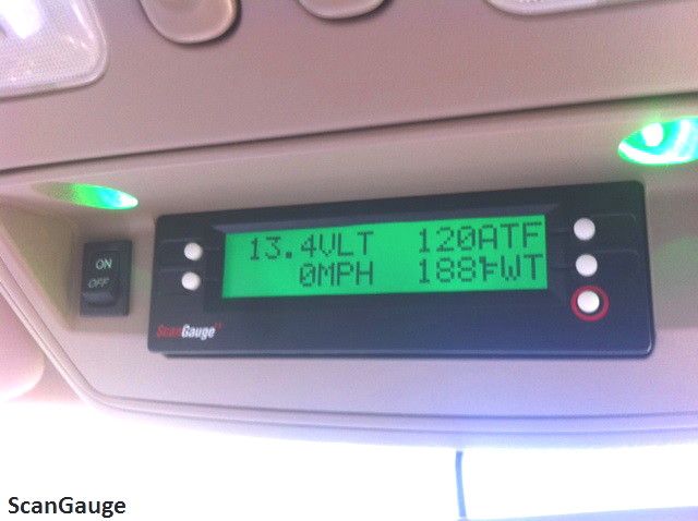

I like Scanguage II for a small in vehicle monitor because I can add extended functionality to monitor transmission temps and fuel trims. The extended codes work for my 99 Tacoma as well as my 99 model LX470. So the same extended function codes work for both Toyotas.

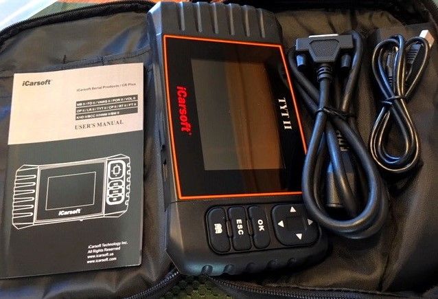

I keep an iCarsoft TYT II in my vehicle at all times. It is Bi-Directional but will not let you control as many vehicle functions as TechStream.
It doesn't require a laptop to run, is small and easily stored. It will provide a wide range of diagnostics (since it is manufacturer specific) and is more than a 'read only' scanner. Shop around....there are many choices out there.

I am running the same setup as @OwnerCS in my 2004 LX (Scangauge II and TechStream). I too really like the small form factor and auto on/auto off. I keep mine velcro'd on the top of the steering column and it is right in line of sight with the other gauges for me to glance at. ATF temp was easily programmed and all others parameters can be "cycled" through and selected for constant display. Went on a 2,600 mile trip to AZ and no rattle, squeak or issue with the unit. I did try and duplicate this setup, but found it too busy and did not work for the LX like I had hoped (inclinometer was inversed and many settings were not available for the 100 series). My choice was based on simpler and less "bells and whistles" or "gadgets and gear". Who doesn't love cool gadgets? Very happy with the basic looking, little Scangauge II.

Another ScanGauge II user here. Simple readable display. Reliable startup, with no action required. Easily customized. Easily mounted, with a number of mounting options. Easy to coach a wife/kid to "read a code" over the phone.
I've looked at the Ultragauge, and while it looks interesting, it seems to have limited mounting options compared to the Scangauge.

I would consider the scangauge more of a monitor than an actual diagnostic scan tool. I intend to run a scanguage on my LX and sprinter van to be ontop of potential issues before they leave me stranded or cost me a bunch of money. For example both vehicles are sensitive to cooling system problems and both vehicles generally wont indicate a problem until its too late. The scangauge will monitor a tighter preset temp range and alert me when temperatures begin to move outside of that range. This is something that the dash needle/CEL typically wont indicate (in my opinion) until its too late. There are a ton more features on the scangauge but my point is that I don't see it is a viable diagnostic scan tool, its more suited for monitoring.

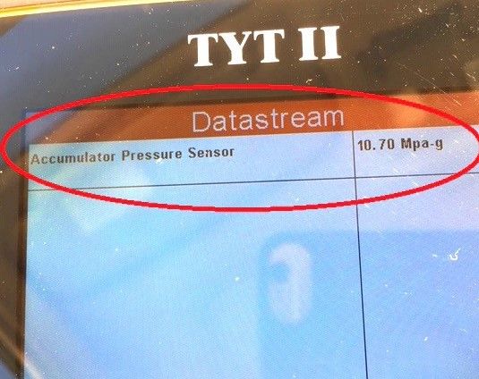

@flintknapper sidebar about iCarsoft, can you read AHC pressures on it?
Thats cool! What is the difference in capability between iCarsoft and Techstream?
I don't have Techstream to compare so can't really say. I'm just going by what I have read about Techstream here and my limited experience (to date) with my TYT II. But suffice to say....Techstream is the more powerful tool with respect to 'commands'. For basic to moderate diagnostics and datastream the TYT II seems quite sufficient for the home mechanic. I'm still learning what mine will do and have been pleased so far.
With Techstream you can control DRL lights, how long lights stay on after turning off, program keys, control the tilt/scoping of steering wheel, when to lock/unlock the car (ie. when turning on or when putting in drive etc..) Some other neat things I can't remember. I have the icarsoft too & like it just to read codes & AHC pressure. Although with techstream it will show you all codes at once where with icarsoft you have to scan for codes under each major section.
