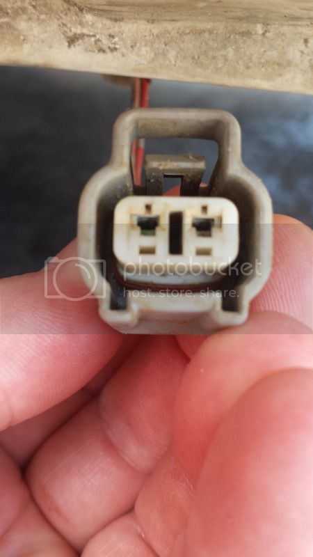

@nnnnnate @Ramathorn15 - Unfortunately, I couldn't find anyone selling the connectors online and my local dealership wasn't able to get the connector for me either. @bamabrock said that his dealership got him the connector, but it was just the external housing and didn't include the internals. I ultimately found the connectors from a supplier in China. They offered a "sample" connector for free, but it would cost $20 in express shipping. I needed more than one connector in order to build strips for me and my brother, so I bought the minimum order quantities of 100 x male and 200 x female connectors. I use the SN-48B pin crimper to connect the 18 gauge wire to the terminals.

Would you be willing to sell me some of the ones I would need? I think the stepside is the male side, right?
I'm in for two male connectors pinned with a little length of wire. Thanks for doing the legwork!
@Ramathorn15 This is the female side that is hanging down from my 04LX after removing the running boards.
