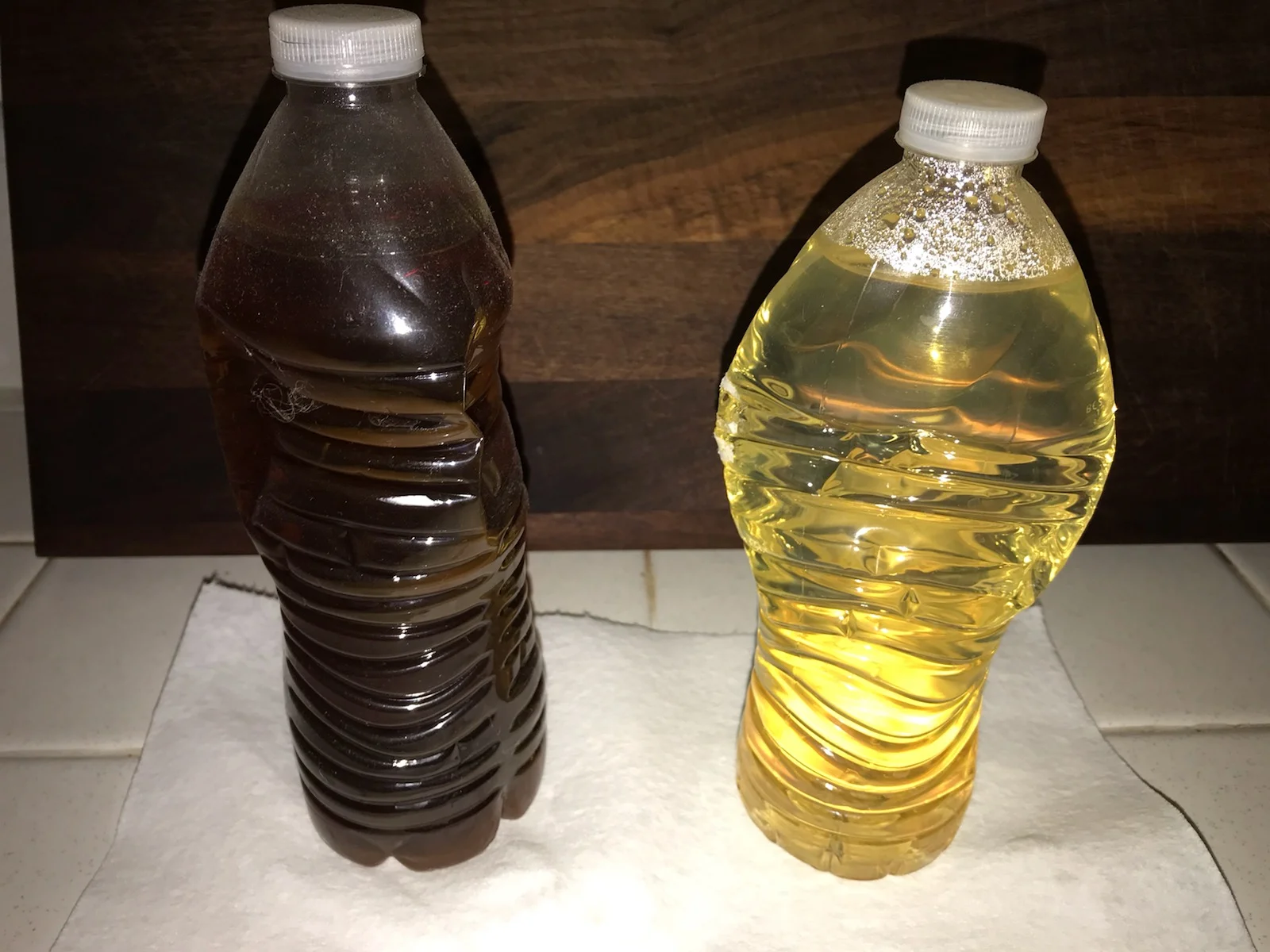

So, came across this excellent thread from @NLXTACY on the 60 forum, and am wondering about the applicability / advisability of doing this on an 80, and how (other than vinegar gallon-count) the process might differ with an FZ.

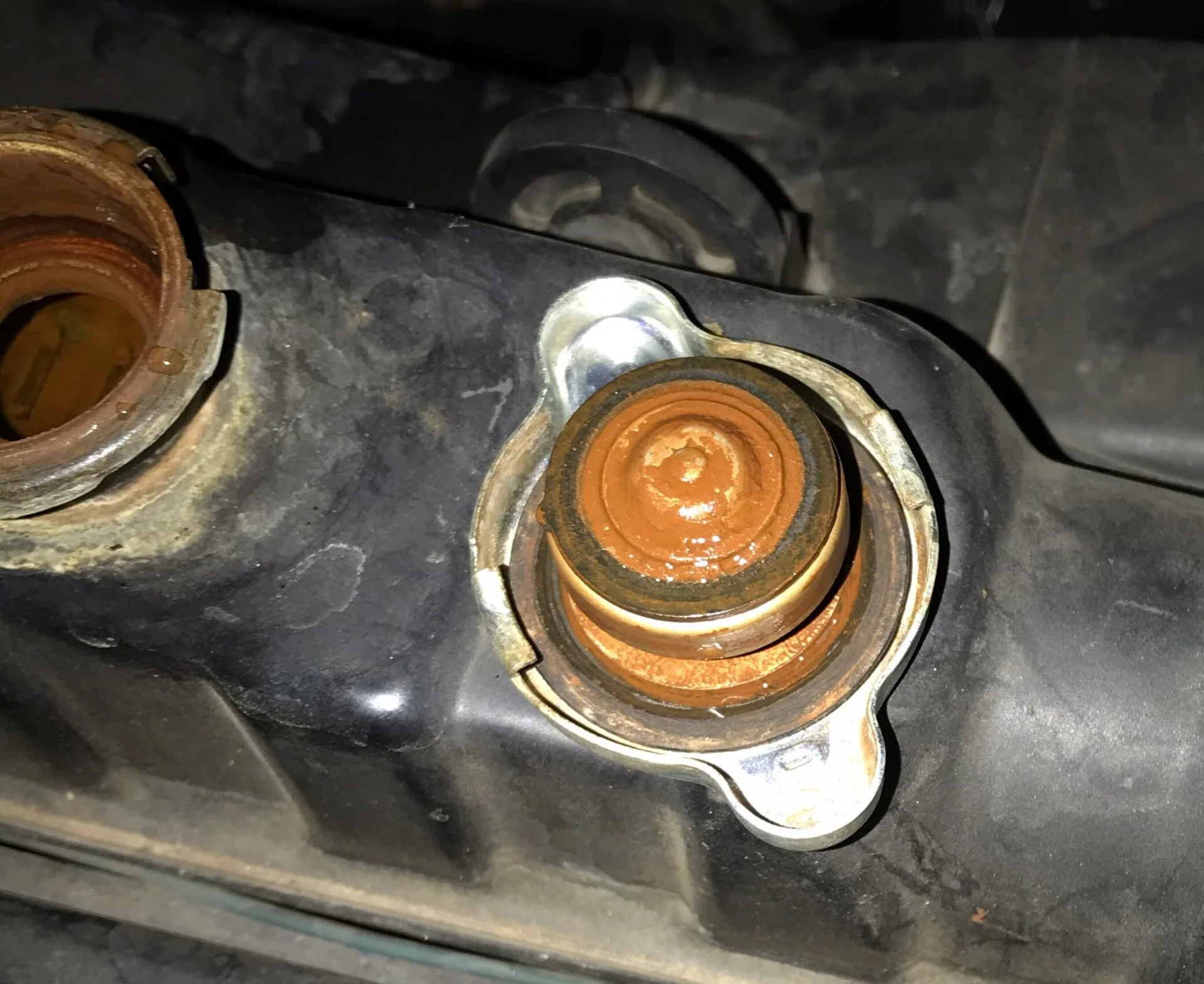

My particular issue as that the radiator seemed to be running rust-colored mud when I bought the rig. I flushed, refilled and drove around 12x in a row. (Samples of first and last flush below--and, mind you, the liquid in those bottles has had several years to settle.) New hoses, water pump, rad cap and off I went. Some time later, the radiator sprang a leak near the top. Been topping off every few days. Got tired of doing that with Amsoil coolant and started using distilled water. (I know.) So, now things have regressed to what you see in the other photo. (Still waaay better than it was originally, believe it or not.)
Gotta finally do front main seal and oil pump cover, so gonna put in a pricey new rad that's been hanging around the garage while I'm at it. I need to get the system as pristine as possible before dropping in the new rad. And I thought @NLXTACY's method might just be the ticket. Not sure whether that means changing all the hoses again, too.
Thoughts on this?

I started from a similar place with my 80 and ran vinegar for a day or so in my 80 with no ill effects in the following 4 or 5 years to date.
I first flushed with the water hose into every hose/port that I could access to get most of the "chunks" out of the system. That included opening the block drain and pushing water into the heater cores in both directions, etc. I also removed the tstat for this and the following flushing though I reinstalled it for the vinegar run to help get things up to temp.
When I ran vinegar (white vinegar from grocery) I topped the system off with distilled water so ended up with 75% vinegar in the system roughly. I left the vinegar in the system for about 24 hours and ran/heat cycled it few times with the vinegar in the system. This included bleeding the air out of the system and running both heaters enough to ensure that they were cleaned as well.
After the vinegar I flushed with the water hose again into heaters, rad lines, etc. to try to get the acid and chunks all out. I may have done a brief run on tap water and baking soda to neutralize any remaining acid, but I don't recall exactly what I did. Since I flush with tap water I finish the process by connecting a shop vac set to blow and I blow the tap water out of the system to minimize deposits. You can put the shop vac outlet into different radiator hoses/inlets and leave it for a few minutes until no more spray comes out, etc.
I then filled with distilled and ran for a few days, followed by a drain and another shopvac blow out to remove the distilled water and was then pretty clean and ready for the refill.
Since all of that flushing 4 or so years ago I now dump and refill just my rad annually with 50/50 by disconnecting the lower rad hose (since this is easy). I also clean the overflow bottle and rad cap valve at the same time. There's still a light dusting of rust/red build up in the overflow every year but it's better every time I clean it out and the rad cap valve/seal stays pretty clean with no clogging at this point.
I've been considering one more vinegar flush in the next year or two as I assume that there are deposits that have built up over time in the engine but I may skip it and just continue my annual clean-outs since the system seems to put at least some, if not most, of the gunk that makes it into suspension in the coolant in the overflow tank over time.

I'll attempt to answer your "Why?" question. The quick answer is to make the 80 more reliable in situations where flushing isn't getting enough of the build-up out of the cooling system.
If you run an 80 with a lot of gunk in the coolant you are at risk of experiencing a handful of issues with the cooling and hvac/heat systems. With my 80 the main issue that I had, even after flushing was the valve on the rad cap repeatedly clogging up and preventing proper flow from the overflow tank as the engine temp cycled. I flushed/backflushed multiple times over a period of weeks and while the coolant was getting cleaner the clogging would resume over time and after heat cycles as more of the rust build up would break loose, start moving through the coolant and collecting in various points, notably in my case the rad cap. Running a mild acid solution for a brief period helped loosen up more of these contaminants and made the follow-up flushing more effective. Being able to stop doing the flushes was also welcome after so many of them. I've continued to see low levels of rust come out of the system in the years since but the cap clogging hasn't returned post vinegar so I think I did just enough cleaning in my 80s case.

Some folks go a little overboard and go extreme. The fact that you've had multiple instances of the radiator cap clogging and other issues would be indicative of serious issues from the PO. (Bar's Leaks?)
