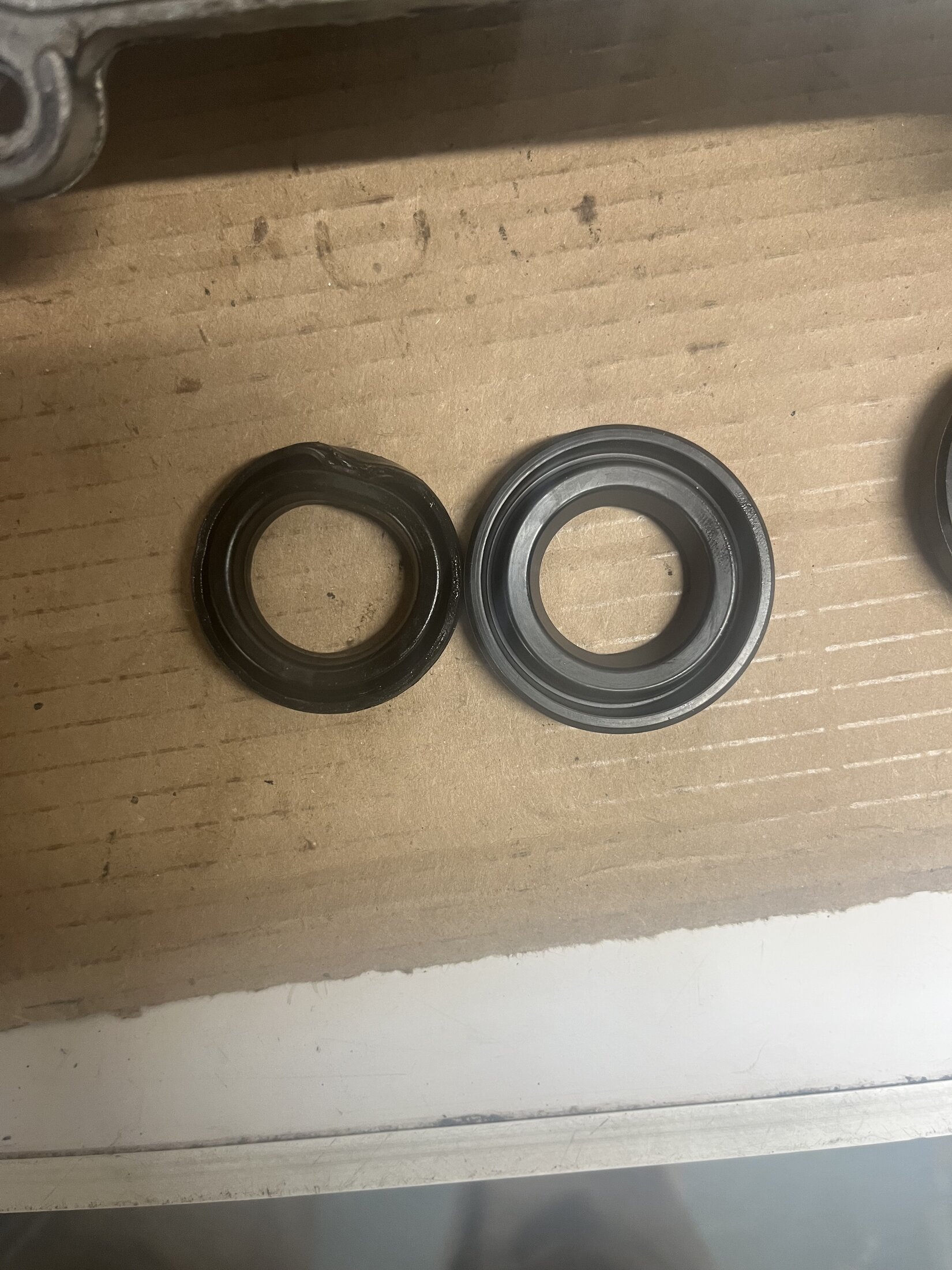

Well strike 1 for the Ishino Stone gasket set.
The spark plug tube gaskets appear to be the wrong size. Unfortunately I discovered this after removing all the old ones. So currently hunting for ones that fit elsewhere.

Update it appears late model 1FZs got smaller diameter seals that match a 2Uz. So this Valve cover or the entire engine must be newer than '94.

For anyone wondering,
The part number for the small spark plug tube gasket is 11193-50010

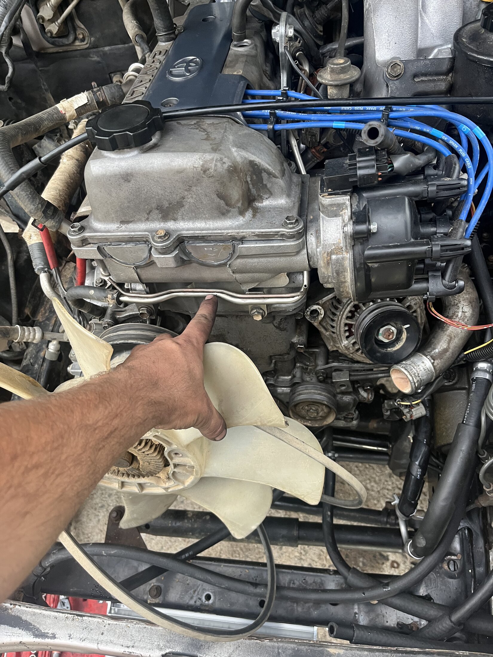

Discovered I forgot to install the hard coolant pipe that runs to the throttle body, and had to remove the fan, belts, alternator, and alternator bracket to fish it in but got it.
Then realized again that I had to install the fan and the fan shroud at the same time. But eventually got it.

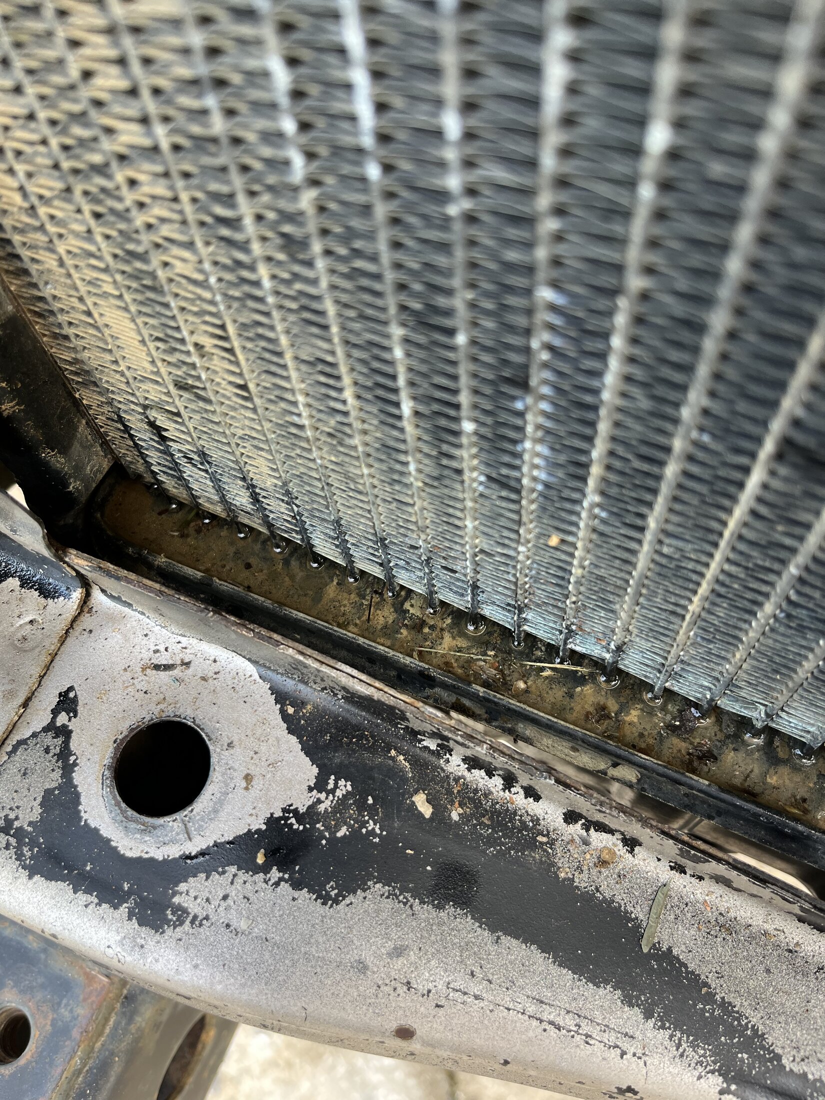

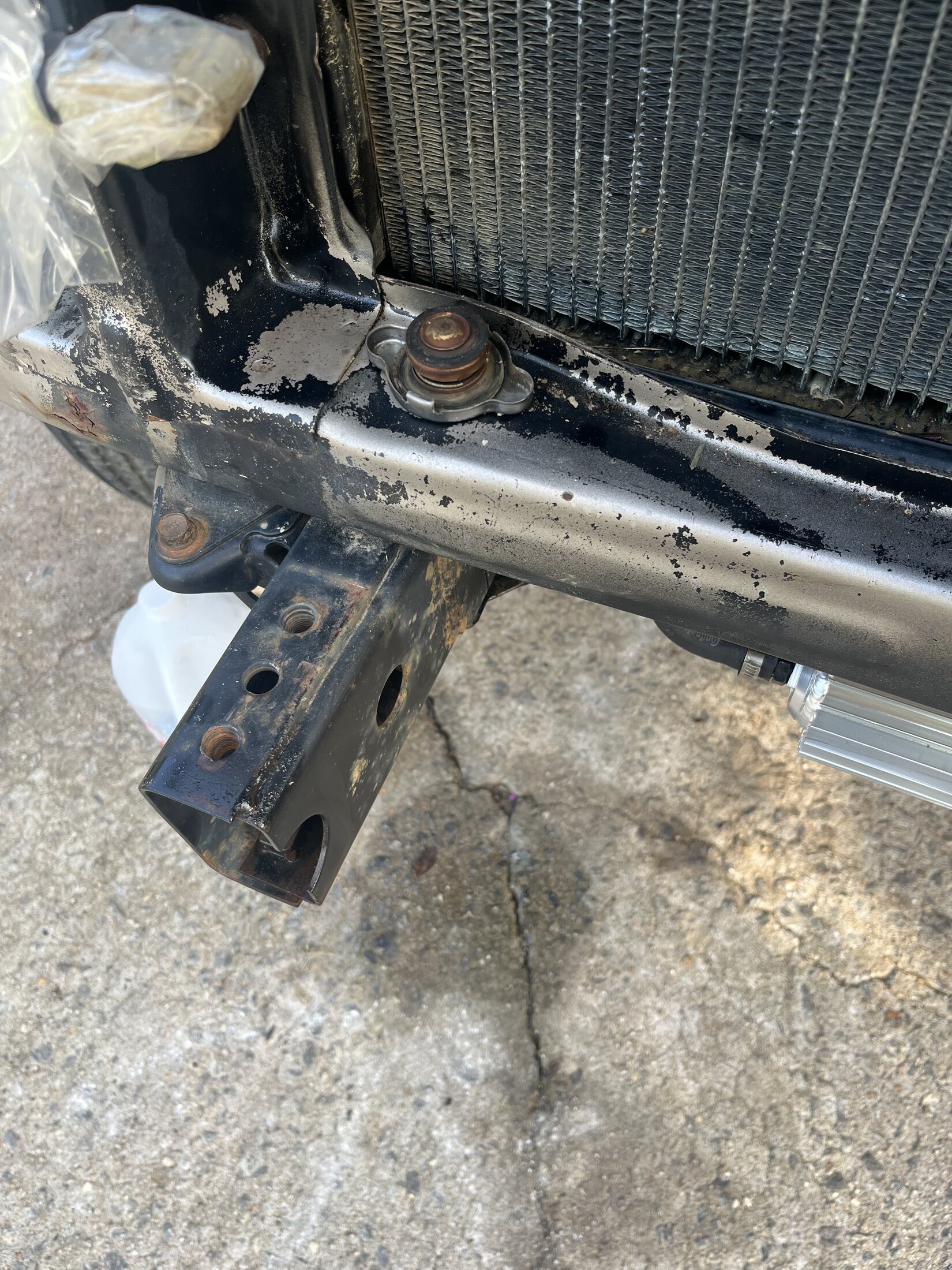

Well the radiator is 100% leaking. Noticed damage when i removed it. Honestly probably a large part of My coolant loss before. But it never left spots on the ground before.
At least the machinist confirmed the head gasket had definitely been blown so I don't feel like all my work was in vain.
