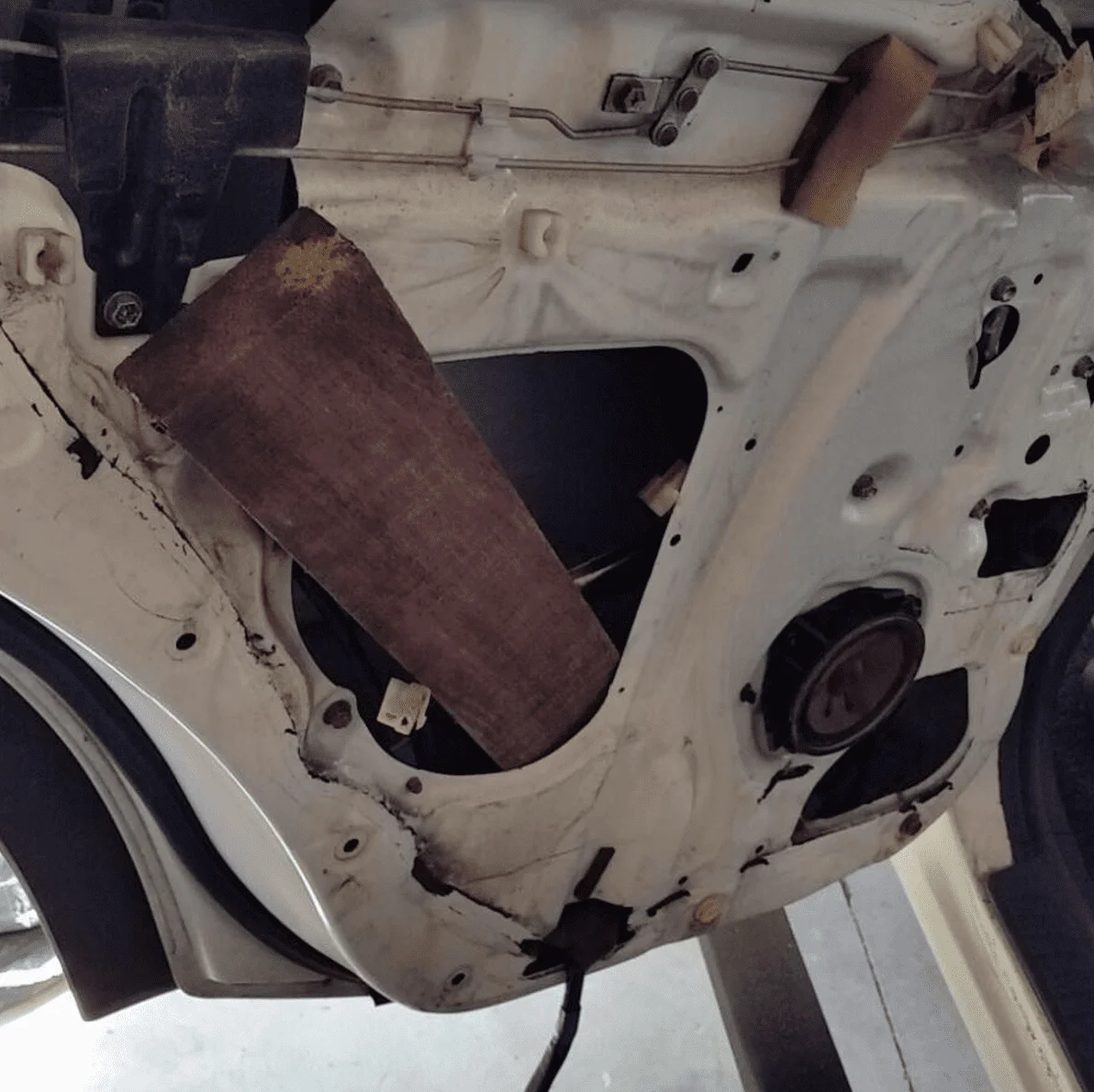

Just got my first Land Cruiser ('92 FJ80) and am based out of Raleigh. First project this past weekend was fixing the rear left door window (bad motor). Opened up the door and discovered a 2 by 4 holding up the window. Whoever did it knew what he was doing, it was wedged in there real tight!
Pretty straight forward. Next on the list: birfields & knuckles!

Welcome! That is one of the best repairs I have seen.
wow - i've seen rear hatches with 2x4s propping them up - but never a window.
That's a whole different level of bodging...
