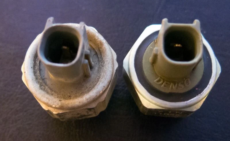

I'm installing the new sensors now. Mine came in a genuine Toyota box double wrapped in plastic but no part numbers. The sensors say Denso below the plug. The sensors I took off are different but I don't know it they have been changed before. The old part does look like the standard motor products picture.

Bought one of these sensors from ebay and slapped it on and all is good. FWIW, the sensor was kinda different, but the plug was a direct match to the engine harnesses connector.
Here are pics of the two side by side. Sensor on the left is what was on the vehicle and the sensor on the right is the new one from Ebay.

exactly what I got in the snail mail
The old one...does it have a name or p/n on it? Looks different, but I haven't done any of mine yet so don't know if the look just changed over the years.
