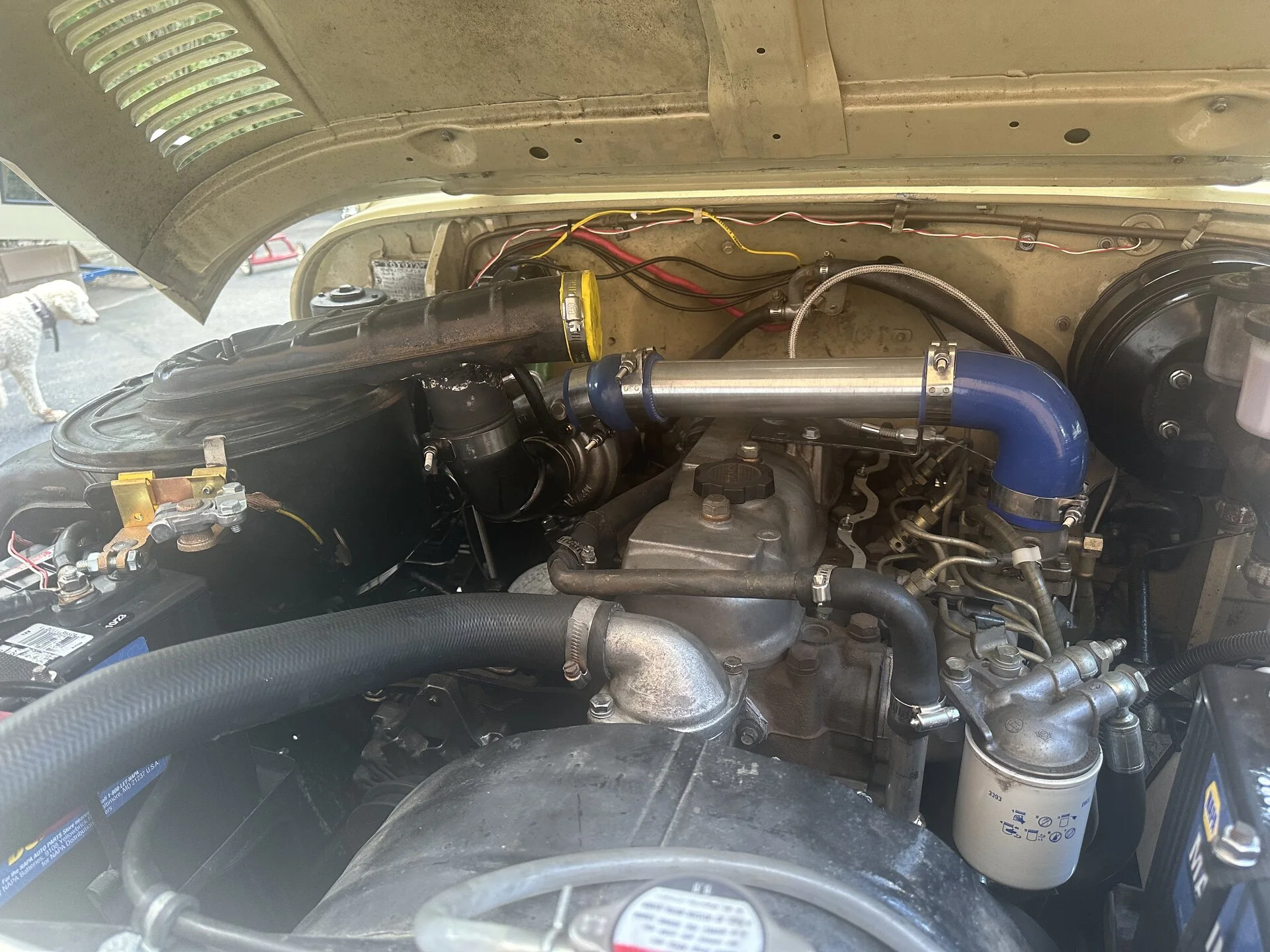

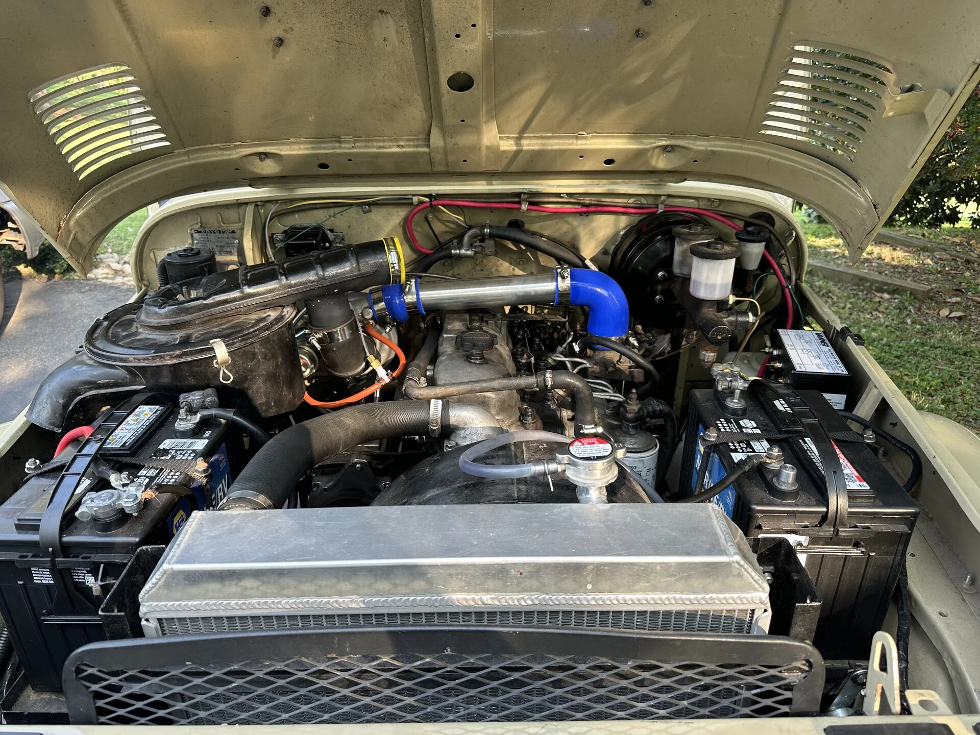

1) Garrett turbo installation (thanks diesel42!)

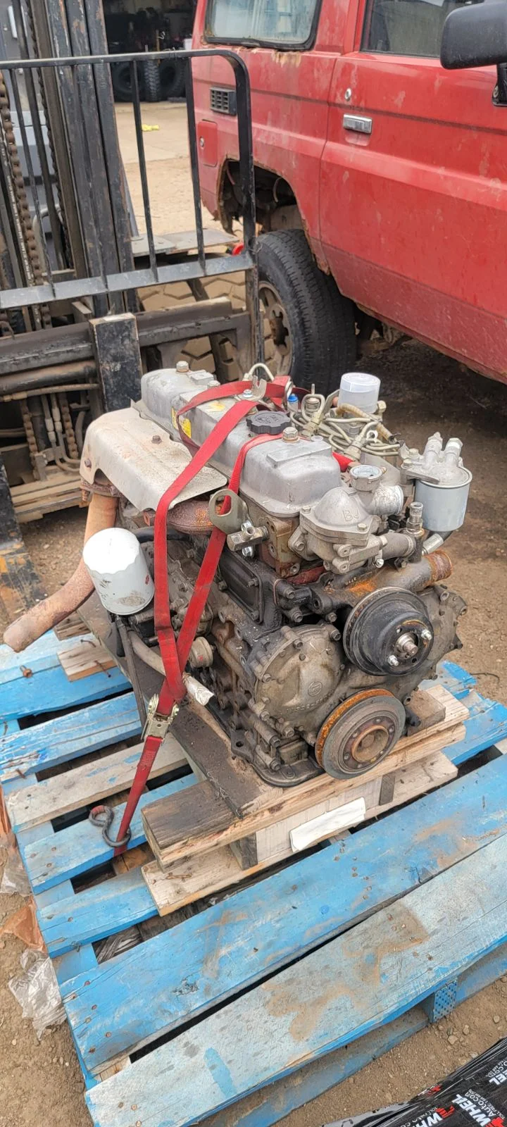

3) Then had to replace ENGINE when engine seized due to cylinder sleeves shed into oil pan

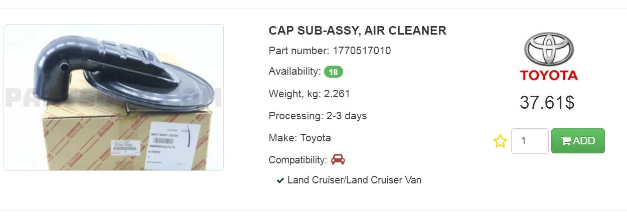

nice looking rig! since you ask, I would do something different with the air filter housing lid and feed to the turbo... what you have there hurts my eyes!
I'd use something stock looking like this lid from a diesel 80 series (snip is from partsouq).
1400 EGT's sounds high to me.
