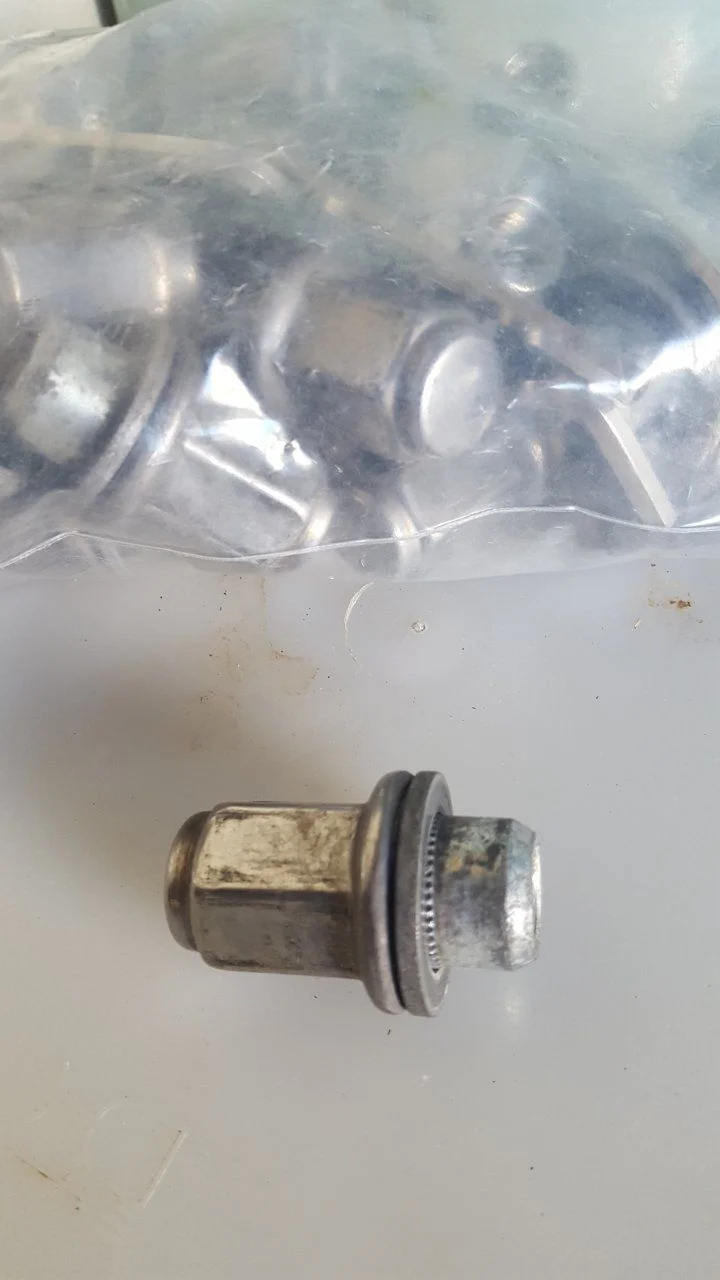

Hub centric vs. lug centric, not a big deal. Just run the lug nuts that have the washer built in:
m14x1_5-lugs-jpg.386180
Might require more thought if you get spacers in the mix.

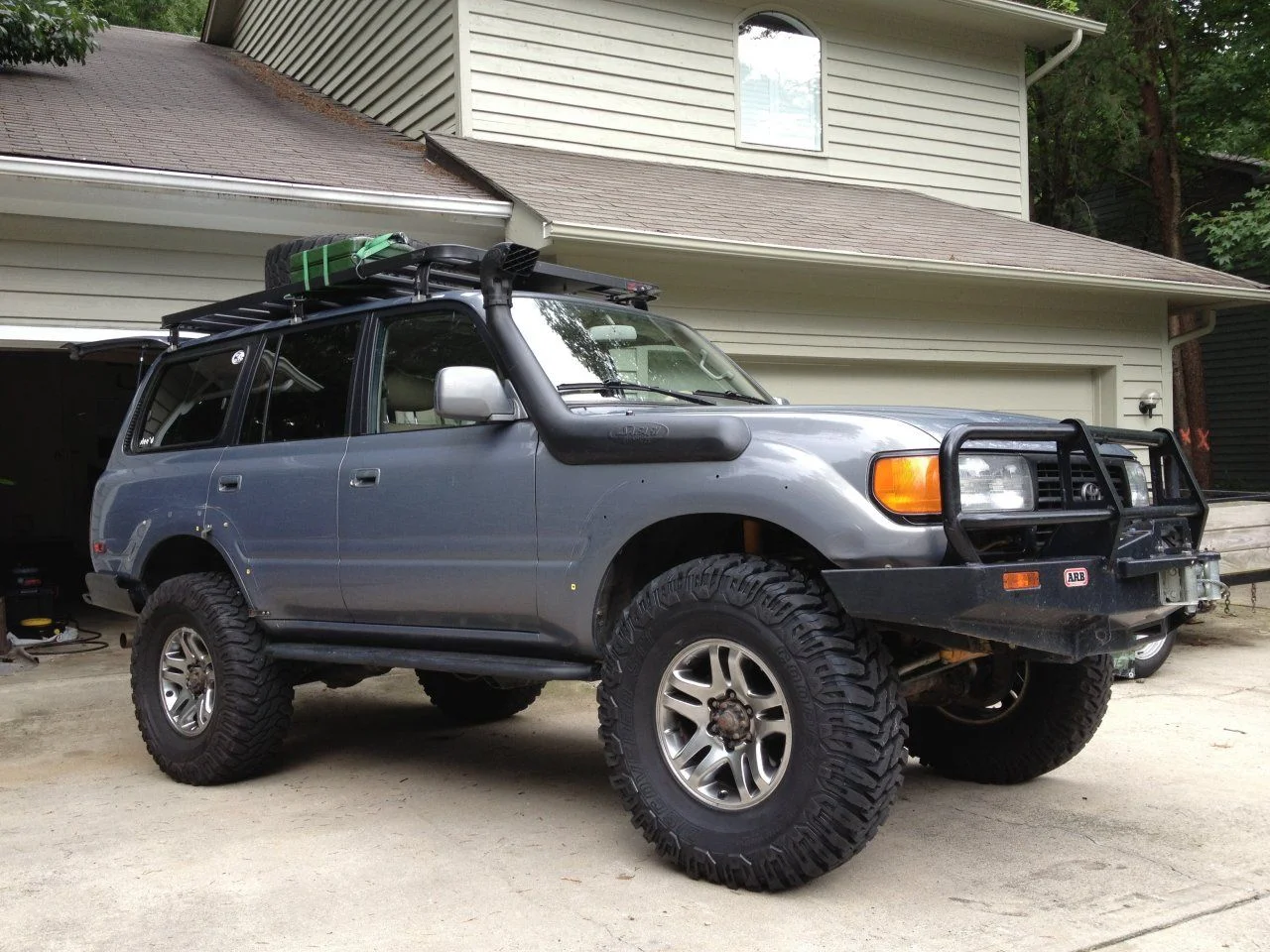

Is the setup in this picture without spacers? I’m looking at these wheels/tires but wondering if I will for sure need spacers. TIA
That pic is without spacers. Those tires had a particularly tall/square profile and rubbed a little more than others. All avoidable with the right lift or bump stop. I had 10yr old lift and no bump drops so there was some contact. Not enough to to bind or cause concern. Spacers will just push the tire out into the fender lip unless you limit the up travel.
