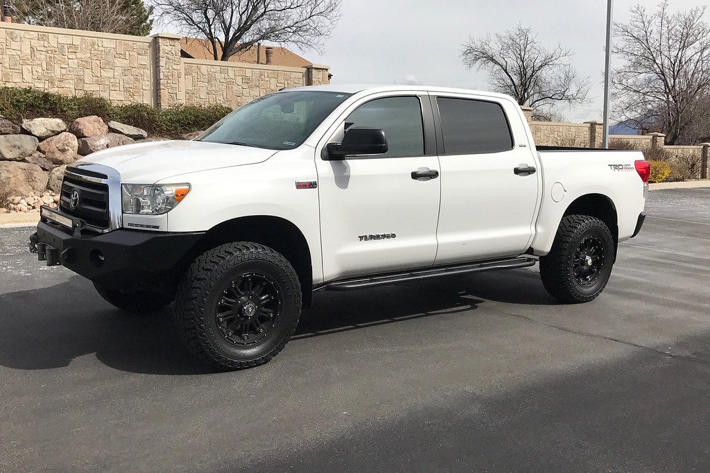

Wanted to get back into something with a bed so I sold my 200 series and finally a white Tundra Rock Warrior came up for sale locally. Will be a slow build but I've already gathered up some parts.

A before picture a few weeks after picking it up. The goal with buying this and selling the 200 series was to have a truck bed again so I can get a truck camper in the future and to spend less than half of what I sold my 200 series for.
The Rock Warrior package really is nothing more than some decals, a shift knob and the wheels. One thing its missing is the Drive Monitor without this all you get on the dash is the outside temperature. Its a simple plug and play install and then in addition to temperature you get distance to empty, current mpg and average mpg. I found a used one on eBay for about $50.

When I stood back to admire my work I was a little surprised that the rear end of the truck was lower than the front, it should have been damn near close to level. It was a long day so didn't think to much about it. What I could see is that I was not going to get away with using my OEM UCA although there are plenty of guys with Tundras and 3" lift running OEM UCA without issues the distance from the inside of the UCA to the spring is maybe only 1-2mm, too close for my comfort. So I ordered some adjustable MEVOTECH arms from Rock Auto.
Some time went by and I was still questioning why was the rear so low, only thing I could figure was my leaf pack was toast. I called over to @cruiseroutfit and they had the Dakar Tundra pack in stock so I picked those up. Not sure why I didn't do this first but I got home and decided to do some measuring. I took my 6' level and found a flat spot to park and laid the level on top of the bed rail and found my rear was 1.5" low. I then measured the front and I had gone from 22'' center of hub to fender to 27.25", I gained 5.25" of lift in the front from my 3" springs no wonder the rear is so low and UCA angle is so steep.
Here is where I'm going to leave a lot of details out but calls have been made and I'm being advised to finish the install of my UCA get an alignment and drive around more and it will settle to 3".
Has anyone else out there seen 2.25" of settling? I'm concerned, if you look at my CV angles in the picture above is it a good idea to drive around like that? What will putting on the UCA solve, I have a ramped curb on my driveway and I can get front to flex upward a couple inches so its not binding on the UCA preventing up travel. I'm getting a lot of push back that everything will be fine, but I'm not so sure.

Those coils look super beefy. Your installed pics look the same as on their website, so its definitely a mystery as to why the front end gained so much lift. If you keep those springs you will need to do a diff drop. I don't think they will settle 2.25 inches. I installed some Dobinsons springs on the rear of a GX460 and they only settled 0.5 inch after a few weeks. We removed them and installed a different spring (it was taller than what the customer wanted).
Personally I'd pull those units and go with a Bilstein 6112 or 5100. I have been wanting to lift my 2012, I eventually will and plan to use 5100's.

I worked it out with Dobinson and will be swapping out to their 2.25” coil when they are back in stock. I’ve read good things about the Bilsteins But my money is already spent so swapping the coils is most cost effective option. I have the 5100s in my wife’s GX470 and they are great.
So already a few changes to the rear setup. My combination of 1.5” rear shackles, OEM leafs, Dobinsons rear shocks and coachbuilder bushings rode awful. It was way too soft/mushy and I was getting too much bed bounce on our wonderful Utah concrete Interstates. Also I wasn’t entirely pleased with the 1.5” of lift, I thought it could use a little more.
I ditched the shackles and got some OME Dakar leafs from @cruiseroutfit and was able to use the Coachbuilder bushings in the OME leafs after pounding out the preinstalled ones with a socket and hammer.
The ride is so much better, nice and firm but not harsh at all. Still a little bed bounce but hoping that gets better with some weight in back and once I go from a 5” to 2.5” lift up front. Ended up getting just about 3” of lift from the Dakar leafs.

Had the 3" Dobinson springs swapped out the heavier 2.25" springs, hopefully will get them reinstalled on the truck later today.
Well how does it look now?
It's great got 2.25" of lift in the front and about 3" in the rear, just a little bit of rake which is what I want. Ride is excellent, feels soft yet planted not harsh over bumps at all.
