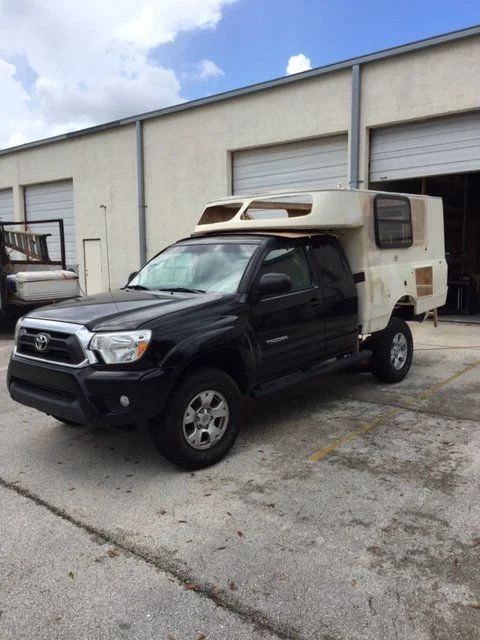

If the original Chinooks based on mini trucks can have the "bed" (camper) bonded to the cab with the interface open why would it be overly complicated to build/bond a camper body to the back of a Tundra (or Tacoma) cab? In the most simple implementation cut out the back of the cab, add a bed cap to the bed then cut out the front of that and the bed and fab up a permanent (not a window-only rubber grommet pass-thru) connection. I know the bed and cab in a pick up can move around relative to each other but really, what is the difference in, say, a Yukon and a Sierra pick up in that regard?
Thoughts?

just seems like a piggyback would be much simpler.
Simpler, yes. But I like the idea of being able to include the cabin into the camping space. Not having to get outside to get into the camping space etc
At the end of the day - either the body has to flex, has to have more flex between body and chassis (body mounts), or have a more rigid chassis that doesn't flex as much. The 3rd gen Tundra has a lot less chassis flex than the earlier generations. Same is likely true for the Tacoma. So that would be a better option to start with. The 2nd gen Tundra is designed intentionally to have a lot of frame torsion movement. One of the reasons it has such great articulation, much like the Unimog design. I think it would take some extra thought toward structure of the combined cabin/camper body to make sure that the cabin can withstand the forces of the flexing chassis. It'll be carrying a lot of the load.
Or use a flexible boundary like the old truck toppers rubber grommet. Or - may be better to start with a more rigid chassis like a Sequoia. A gen2 Sequoia has essentially an extended LC200 chassis that is going to have a lot less flex than a gen2 tundra.
I can see a lot of value in avoiding all of the issues with the Sprinter powertrain.
I was under the impression that the Sequoia was built on the tundra platform. Does that not mean they use the same frame? I agree that there would be some challenges in fusing the two parts together in a way that would allow them to remain rigid. I thought about the rubber grommet approach and that is still a possibility. It would require, for my plan, cutting a large hole in the back of the cab, nearly the entire cab rear.
It depends on generation. Gen2 tundra is a lot different from the gen2 Sequoia. The Tundra has a c-channel frame from basically the transfer case back. The gen2 Sequoia is a fully boxed frame all the way back and has IRS. New Sequoia and Tundra are both sharing the fully boxed GA-F platform, so they're much more similar to each other and would be more rigid.
Downside of the Gen3 Tundra is that the cabin kinda sucks - it's a lot shorter in height and the rear window is significantly smaller, so it wouldn't be my first choice of cabin to start with for a rv. The Gen2 Tundra is much better for that IMO. But the Gen3 chassis is going to be more rigid. And the Gen3 Tundra comes as a crewmax with a 6.5 bed and a crewcab with an 8 foot bed. Unfortunately you can't get the TRD OR package on the 8 foot bed option. That's dumb. That would probably be the platform I'd start with if I was going with a newer truck base - I'd get an SR or SR5 base model with the 8 foot bed and then you have some room to fit a decent size camper on the back.
